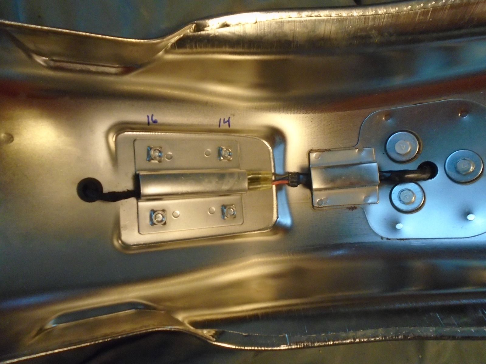

I was going to send you a picture of original then noted you've already hacked it up ha. I'm going Warrens conclusion, corroded bulb bayonet if a singular bulb. If a dual bulb set-up then double check your wiring skills. Looks like it's solid mounted to the frame? BAD BAD idea, the filaments in the bulbs will rattle loose. Why do you think all the original lights were rubber isolated??

Thank youuu!! Yes I understand, I bought the bike already like that!! That was not my idea to put my light right here!! I have single bulb inside of it!!
