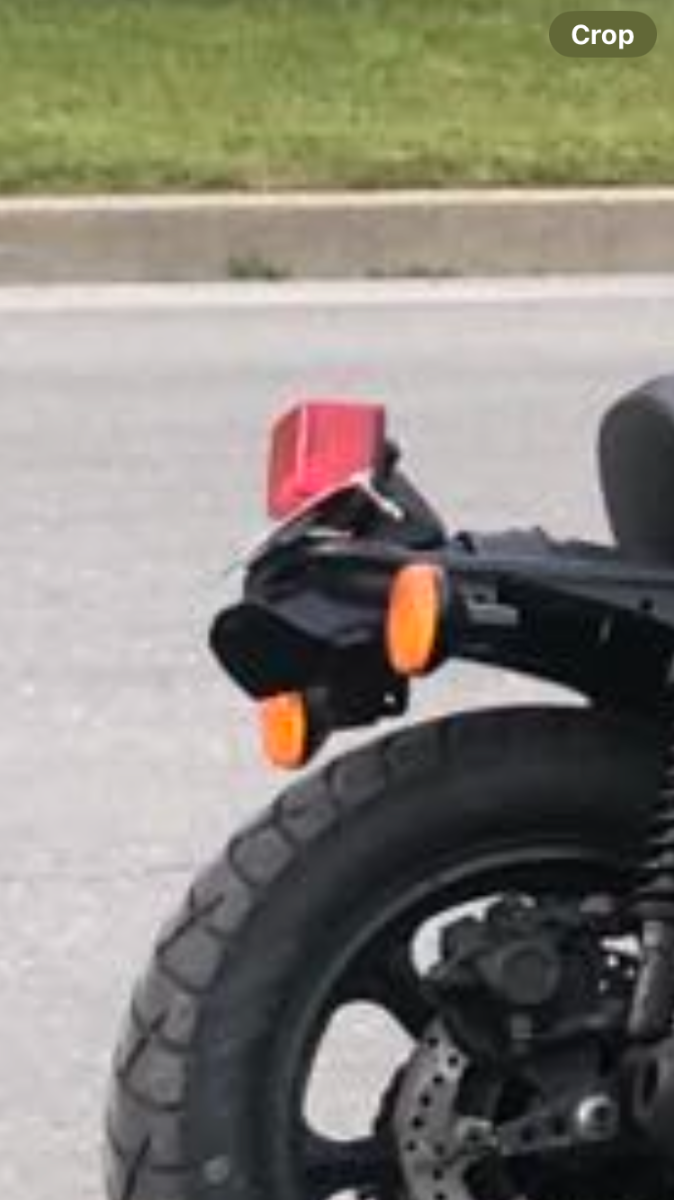

Hello everyone, When I ride my Kz, sometimes running back light is off and sometimes On !! Brake light works everytime .. what can cause running light to work intermittently ?! Bulbs are new everywhere on the bike. Ive check my wire underneath the light. Everything looks good

The front one is not affected, flashers all good. I dont have License light!! My fender has been cut.. only tail light isn’t working(running light). Brakes are ok !!

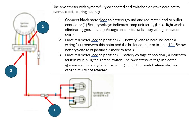

Three prods with a voltmeter will identify your issue (fault needs to be present when testing)
PS: When the fault occurs does the light come on if you move the ignition to the "park" position ?
PPS: if test 3 fails before replacing the ignition switch check you have battery voltage going into the switch on the blue wire
Last edit: 31 Jul 2025 06:59 by Wookie58.

Thank youu!! So if my red wire is on fault. Brake light will work as well ?!
Kz750e 1980
- Posts: 6939
- Thanks: 4354
Re: Back light
31 Jul 2025 07:22Yes, the red wire only supplies the tail lightThank youu!! So if my red wire is on fault. Brake light will work as well ?!
