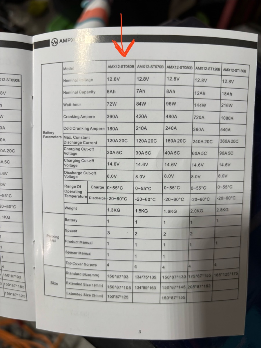

Thanks everyone for the insight. The battery brand is Ampxell, and the manual shows 120A max constant discharge current.
Here is a photo of the battery model and specs.
The previous two batteries were a brand called X2 power that I got at my local Batteries Plus store. That manual unfortunately gives no useful info besides the charging min and max voltage.

Whilst the "capacity" isn't massive it shouldn't cut out on the current being drawn by your starter (for a couple of starts at least without re-charge)

@Wookie58 I'm glad your train of thought matches mine on this battery. Although, I had it hooked up to the charger all morning and it was reading 12.3V across the terminals but when I attached the + & - cables, I had no power to the bike. Removed the cables from this battery and hooked another 12V battery to the cables and without starting the motorcycle, I had all my lights.
Having the same electrical problem with three total batteries, two of which are different models and capacities certainly makes it hard to believe for me that it's the battery. There is a local shop in town that rebuilds and services starters and alternators so I plan to see if they'll take a look at mine.

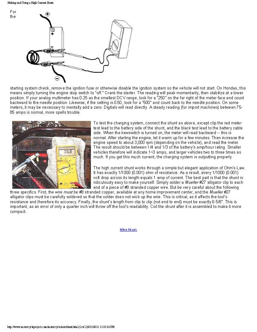

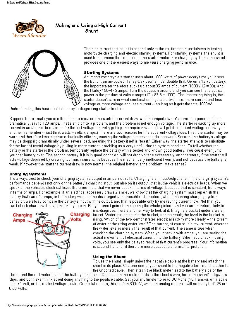

There has been some good ideas offered in the thread on your issue. Lots of what has been stated would point me towards the issue being what the starter is seeking and on what the new battery's protection circuit requires. I think that when faced with issues like this, one needs to measure amps not volts in any attempt to find the solution to the problem. The starter by far is the largest draw on the electrical system on bikes. Keep in mind that the starter is seeking a certain about of watts (volts x amps = watts) to function correctly. The starter does not care how it gets what it is seeking. It not enough volts it will attempt to pull more amps, or if not enough amps it will attempt to pull more volts. I am sure you could make use of an amp meter to aid in your testing. But have found this simple tool one can make for testing and use with a VOM.. I did not come up with this tool rather it comes from Mike Nixon's site
motorcycleproject.com
See attached
1977 KZ650 B1
Pods and Denco header
OLD KAW OWNERS SMILE ALOT

GD4now that is a great article, if anyone is looking at going this route but doesn't feel confident around the level of accuracy required to make this shunt there is an alternative from the marine world
The following user(s) said Thank You: gd4now
