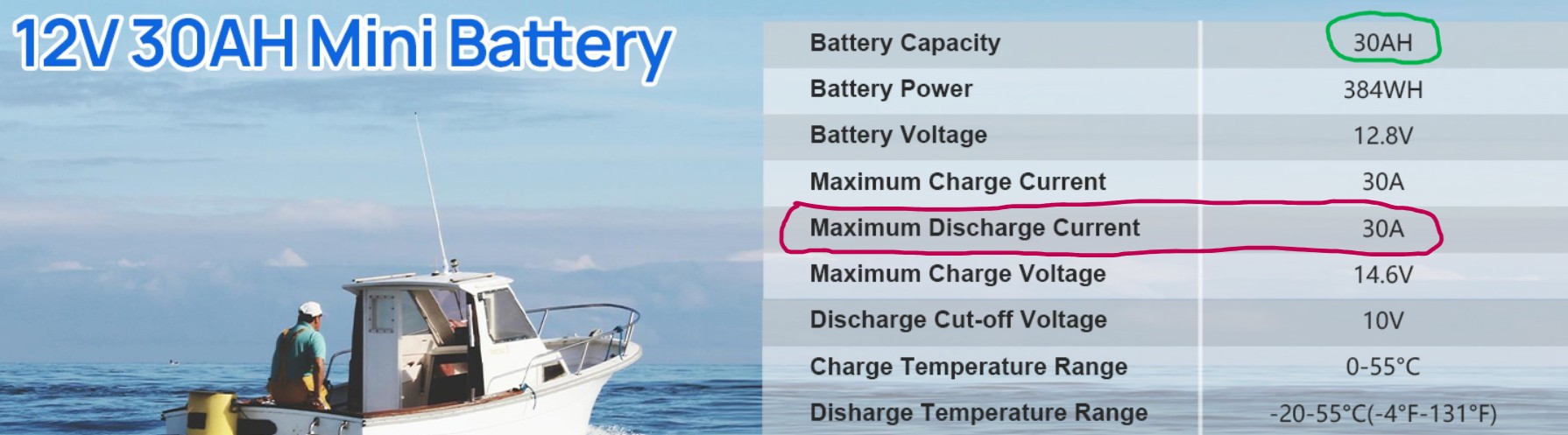

19 Jul 2025 00:36 - 19 Jul 2025 01:01I think given the batteries origin confirming the specs is your first job. You could still do the ohmeter check I explained earlier to check the motor for shorts. It is starting to look like you may have learnt an expensive lesson regarding "diagnosis by part changing". I have just ha a quick look at the batteries on Amazon and they have some interesting specs !!!! the example below looks to have great capacity at 30ah but the BMS cuts in at 30 amps (your starter will draw between 60-80 amps)I'll attempt to contact them, it was an Amazon special. Even though I've got about $300 into the lithium batteries, reg/rec, and starter solenoid trying to diagnose this issue, I am very close to throwing a standard AGM or flooded battery in there and seeing what happens.
Last edit: 19 Jul 2025 01:01 by Wookie58.
- slmjim+Z1BEBE
- Posts: 1619
- Thanks: 1089
Re: Intermittent dead short while starting
19 Jul 2025 02:59
^^^ CCA is missing from those specs. ^^^ Looks sketchy.

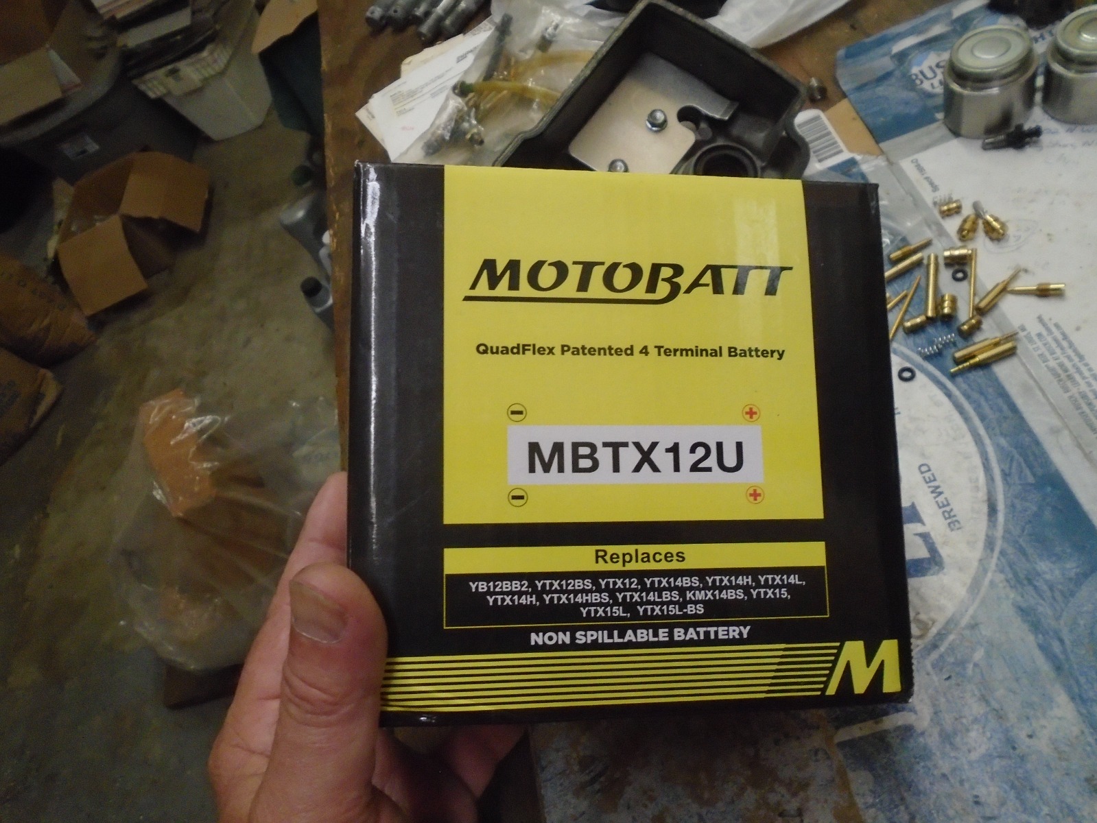

Perhaps just a rambling but noteworthy. While i've not yet gone down the lithium path, seems excessive for these older machines. I know person's Have been successful using them but i don't really see the benefit at this time for conversion. They just last week opened the DeSoto, KS Panasonic Battery factory 15miles away from me! Hope it doesn't blow-up, ha. I have been buying batteries from the box-store O'Reilly for years but their stuff is Crap now! The last 3 i'd bought, skid-steer, Jeep and Ford have all failed within 6mos. Called the headquarters in Springfield, Mo and talked to a gal. She too understood because they have been getting soo many complaints for the same issue. Also have bought a couple AGM batteries off ebay/amazon and they too failed. Seems they "hit" initially but plates/internals went south quick and only holding a "surface charge" thereafter. Soo i went a different path, Motobatt, AGM. Have been using these for over 3yrs in all kinds of Motorcycles/Side-by-sides/ATV's etc without a hint of an issue. They are a funky flowerchild color but WORK.
Food for thought...
The following user(s) said Thank You: SWest, Gdizard
