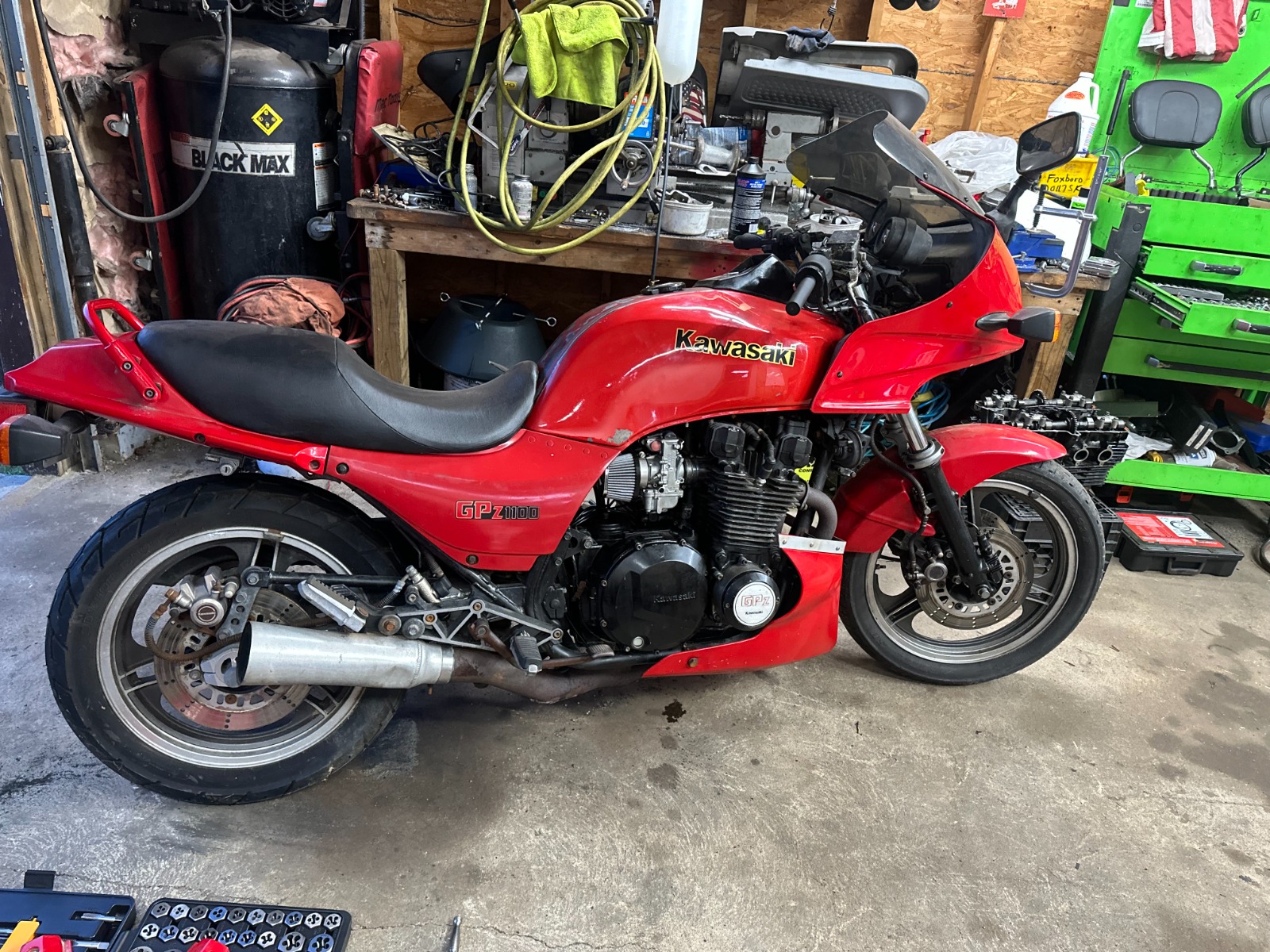

thats the red gpz we have was gonna be a 1100 turbo project but couldnt get it run with the dfi so carbs it got..
