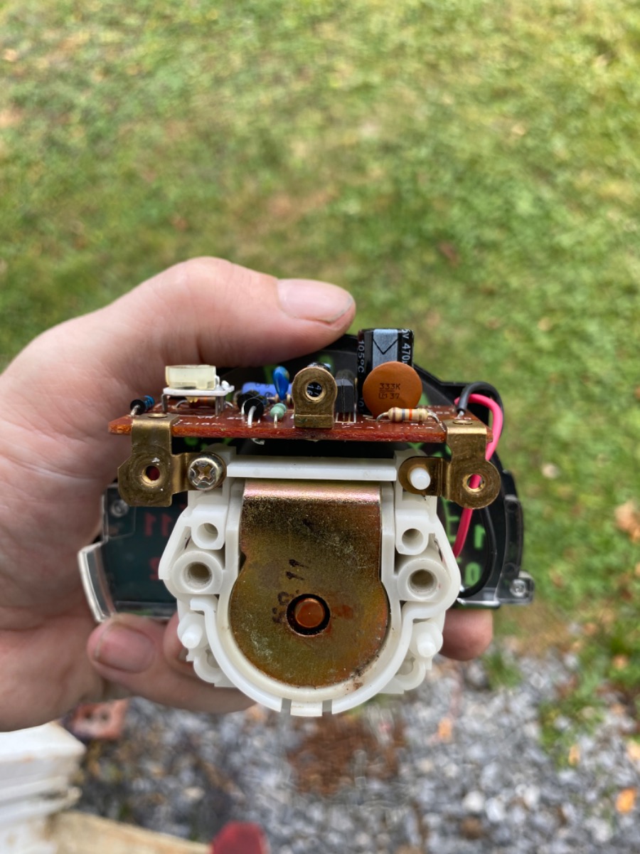

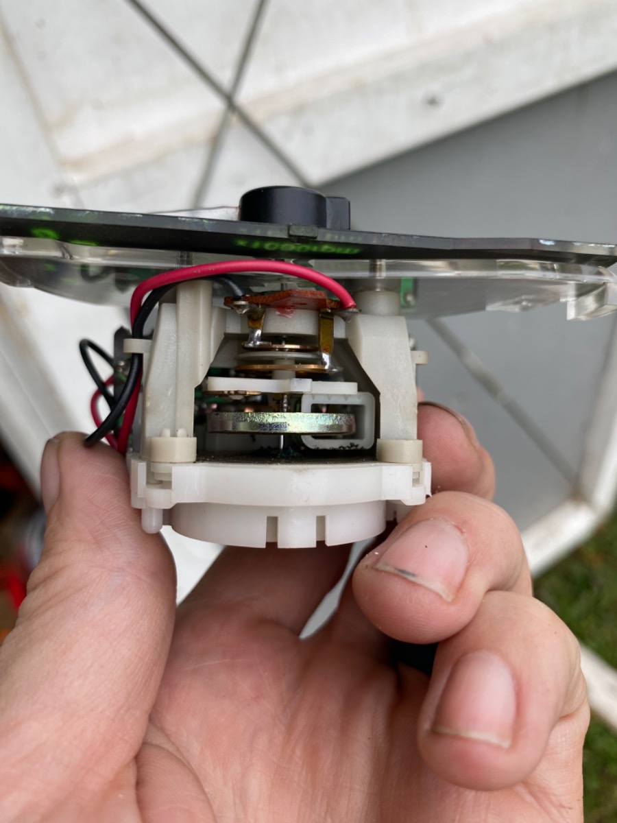

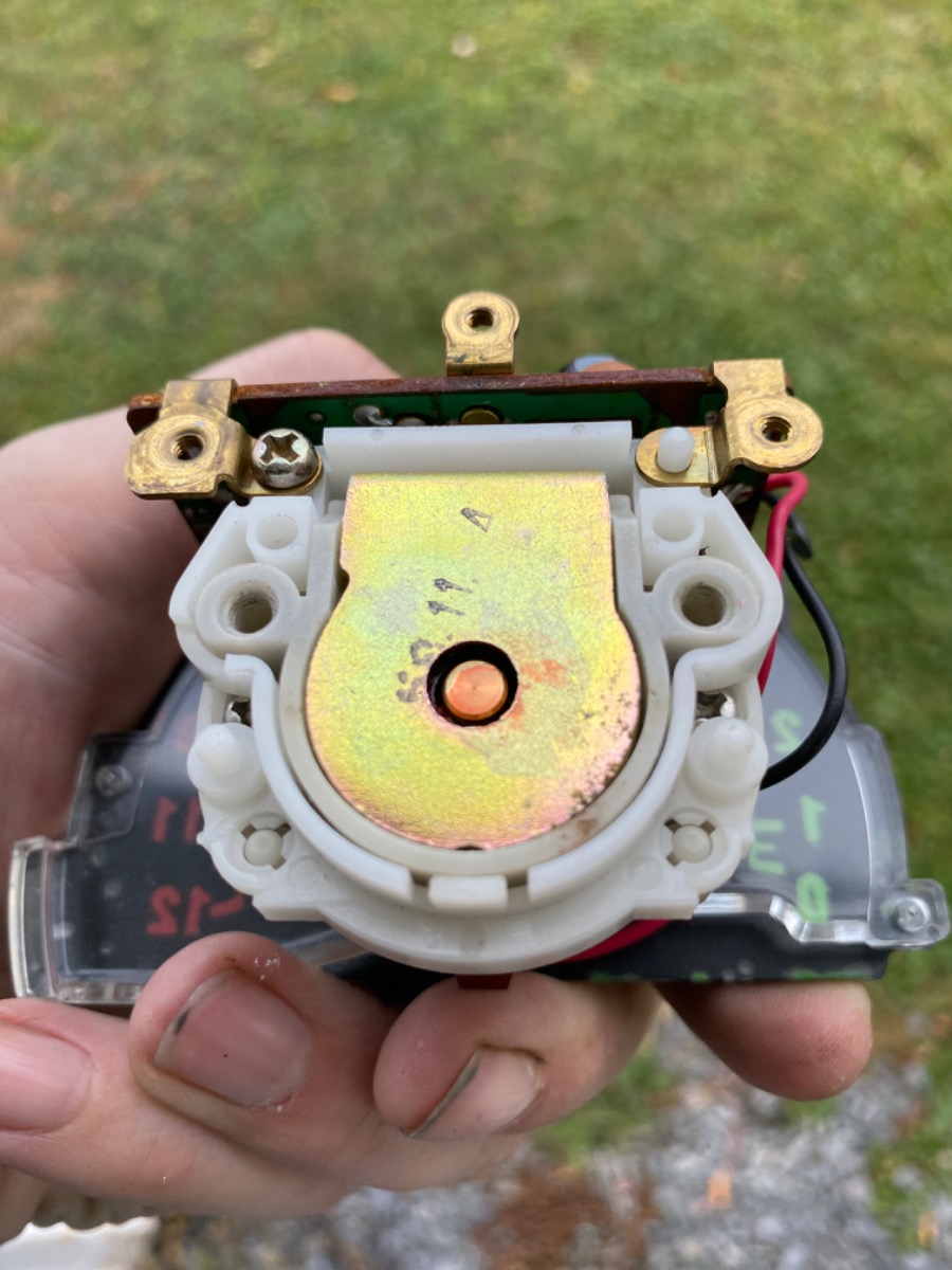

there’s two springs. Opposing each other. But they’re also conductors. It’s how the power gets to the coil, so it moves around the ring magnet. There’s a central shaft, that passes through the whole thing to a bushing at the bottom (opposite the gauge face). That is likely where you’ll find a deposit of crusty once-was-oil. Being extremely careful to not get any on the gauge face, you can spray some “contact cleaner” at the bottom to flush it out. Then a single drop of some high quality thin oil applied.
you can also inspect the rest of the mechanism at this time. I strongly suggest against trying to remove the needle or the gauge face. The plastic is old and *very* brittle.
if you’d like to test the movement once you’ve cleaned and oiled it, use something soft and pliable. Meaning not your finger. The needle for the gauge won’t take very much to snap off. I broke mine. And fabricated a replacement from acrylic sheet. Soft so it won’t scratch the gauge, pliable so it will bend before the needle does.
mid you want, I can take pics of mine so you can see what you might be dealing with before you take the plunge.

- KeylAmi!
- Engineer with ADHD
- Posts: 91
- Thanks: 58
Re: 1982 Spectre 1100 Tach issue.
22 Oct 2024 05:15
daveo,
yes, the crimp ring is definitely a point of concern when considering servicing the unit.
Though i wonder on the proximity of the holes for the backlights to the area in question.
Perhaps one of them is close enough to the gauge spindle to carefully add more lube? It does make cleaning the old out extremely difficult.
