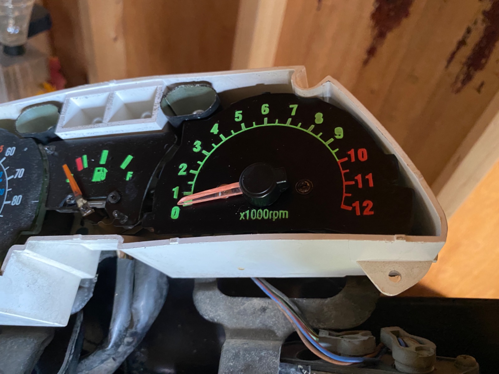

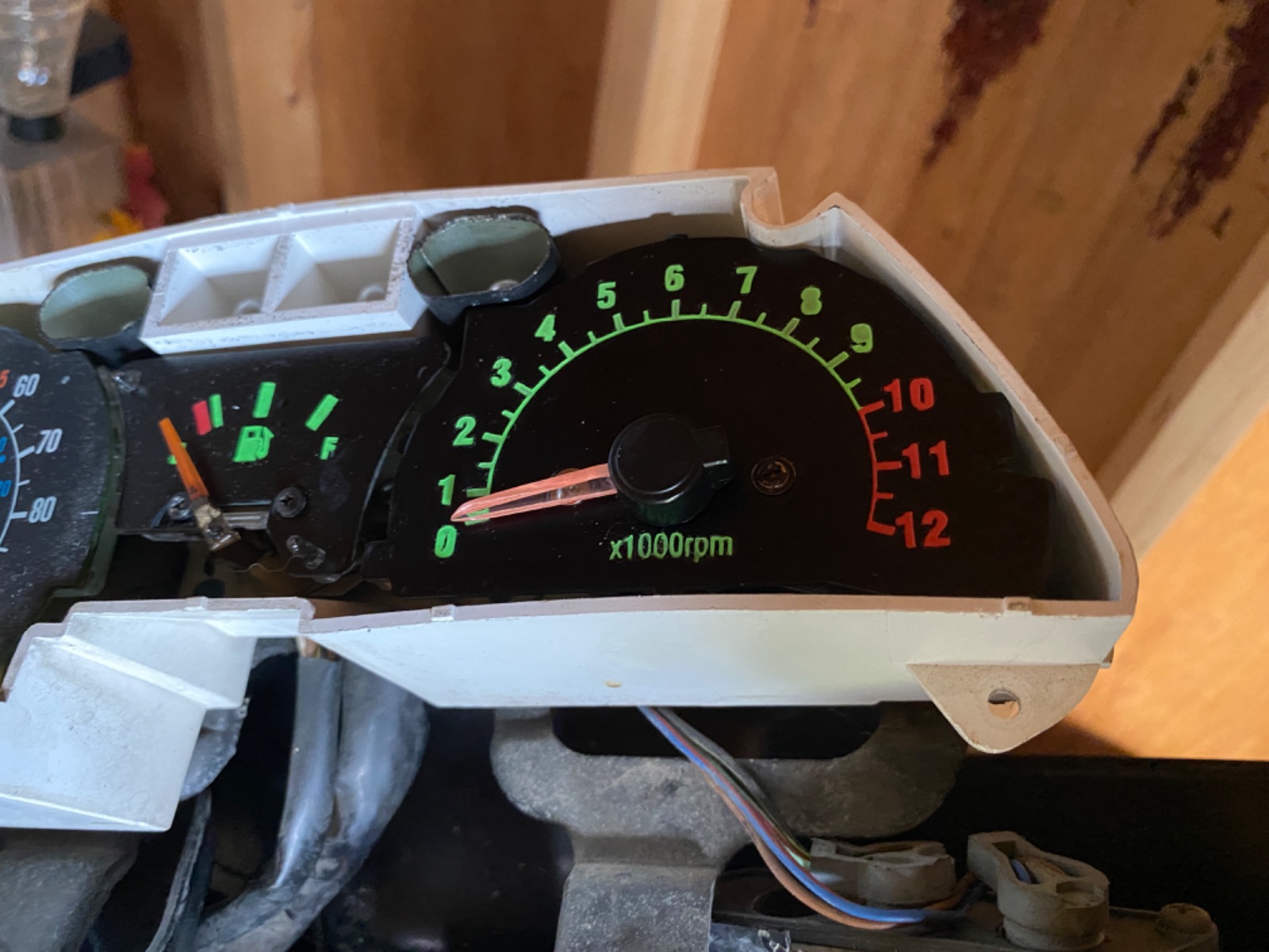

I've been riding my 1100 Spectre this year and I've learned that this bike is more advanced than I'd thought. I expected electronic ignition but was surprised to find that it also has self canceling turn signals and electronic gauges.
I had an assignment this past weekend for which I had to be on site at 0 Dark:30. The Spectre was in my heated garage. The bike started and ran fine on the way to work. About a half an hour after I'd arrived I decided that I needed to move the bike but when I started it up I noticed that the tach was dead.The needle seemed to want to move but was unwilling to return to zero after I shut it down.
As I was preparing to ride home I wondered if the issue wasn't lubrication related, within the gauge. The bike had been sitting out in the sun and sure enough, once started, the tach was back to working fine.
I have yet to disassemble the tach, but before I do I'm wondering if any of you have ventured there before me?

I was very recently in the electronic tach on my KZ700. I don't know how similar the guts are, but i can give you some pointers possibly on where to look.

there’s two springs. Opposing each other. But they’re also conductors. It’s how the power gets to the coil, so it moves around the ring magnet. There’s a central shaft, that passes through the whole thing to a bushing at the bottom (opposite the gauge face). That is likely where you’ll find a deposit of crusty once-was-oil. Being extremely careful to not get any on the gauge face, you can spray some “contact cleaner” at the bottom to flush it out. Then a single drop of some high quality thin oil applied.
you can also inspect the rest of the mechanism at this time. I strongly suggest against trying to remove the needle or the gauge face. The plastic is old and *very* brittle.
if you’d like to test the movement once you’ve cleaned and oiled it, use something soft and pliable. Meaning not your finger. The needle for the gauge won’t take very much to snap off. I broke mine. And fabricated a replacement from acrylic sheet. Soft so it won’t scratch the gauge, pliable so it will bend before the needle does.
mid you want, I can take pics of mine so you can see what you might be dealing with before you take the plunge.

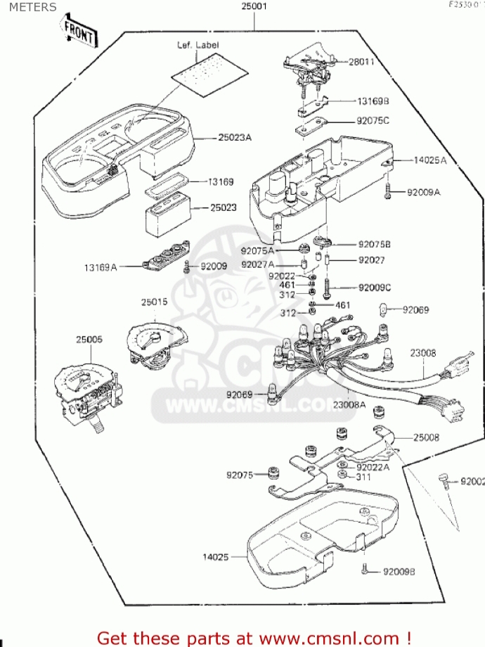

The round individual meter cases that came on the 81-82 1100 model years are held together with a steel crimp ring.
Disassembly requires un-crimping or essentially prying it open (from the back) with great care to avoid destroying or distorting it's shape beyond the point where it can be reused. Exact replacement crimp rings were unavailable when I had a rare 160 MPH electric speedometer expertly repaired a few years ago, and what was would not fit suitably.
I believe the Spectre model crimp ring is black (painted?) vs unfinished satin stainless steel.
My humble opinion is to avoid all the effort involved, and replace the entire gauge with one known to function properly.

from memory, no clue.
I will take a look tonight, and try to get some pictures as well.
