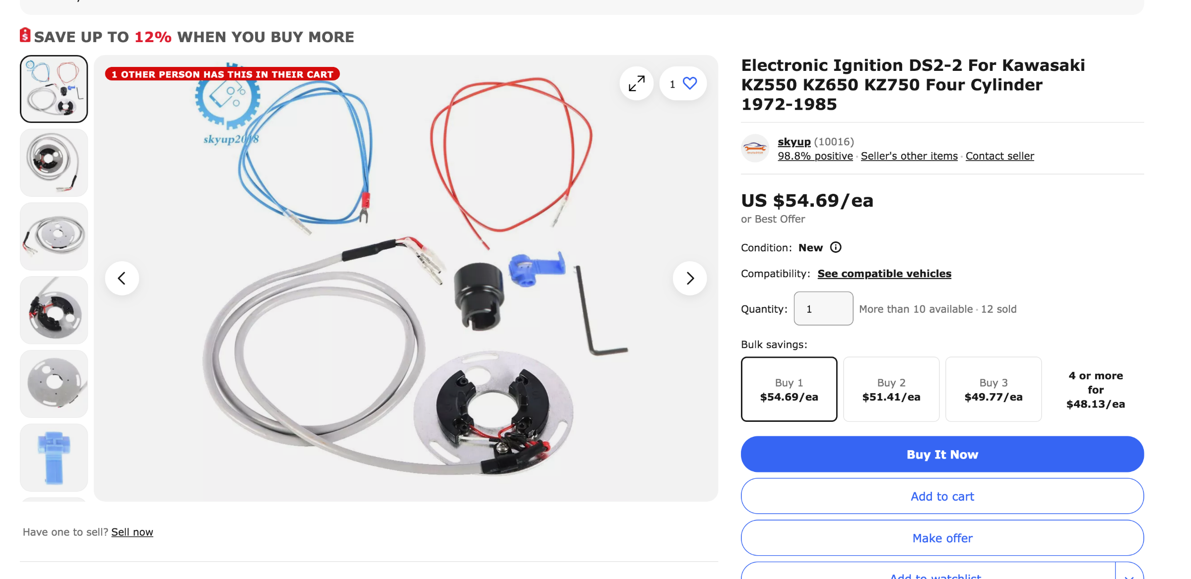

There are ebay kits to convert the points ignition to electronic for $60 or so. Has anyone where had good luck with an ebay seller or should I just do the usual ebay due dillagence?

I've fitted several of the Chinesium Dyna systems to bikes for people. Never had one fail electronically only had one cause an issue where the trigger magnet fell out. Glued it back in and been good ever since.

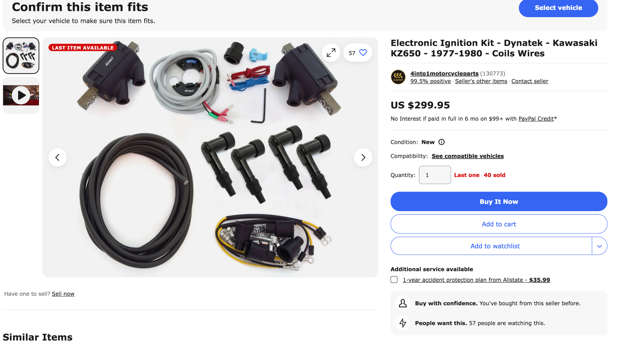

Well, there's a lot of different prices. The 4into1 kit is $300. A basic china kit is $54. Any suggestions?

The 4-1 kit is a real Dyna Ignition but with chinese copy coils and leads.
Most of the cost there is due to the genuine Dyna ignition.

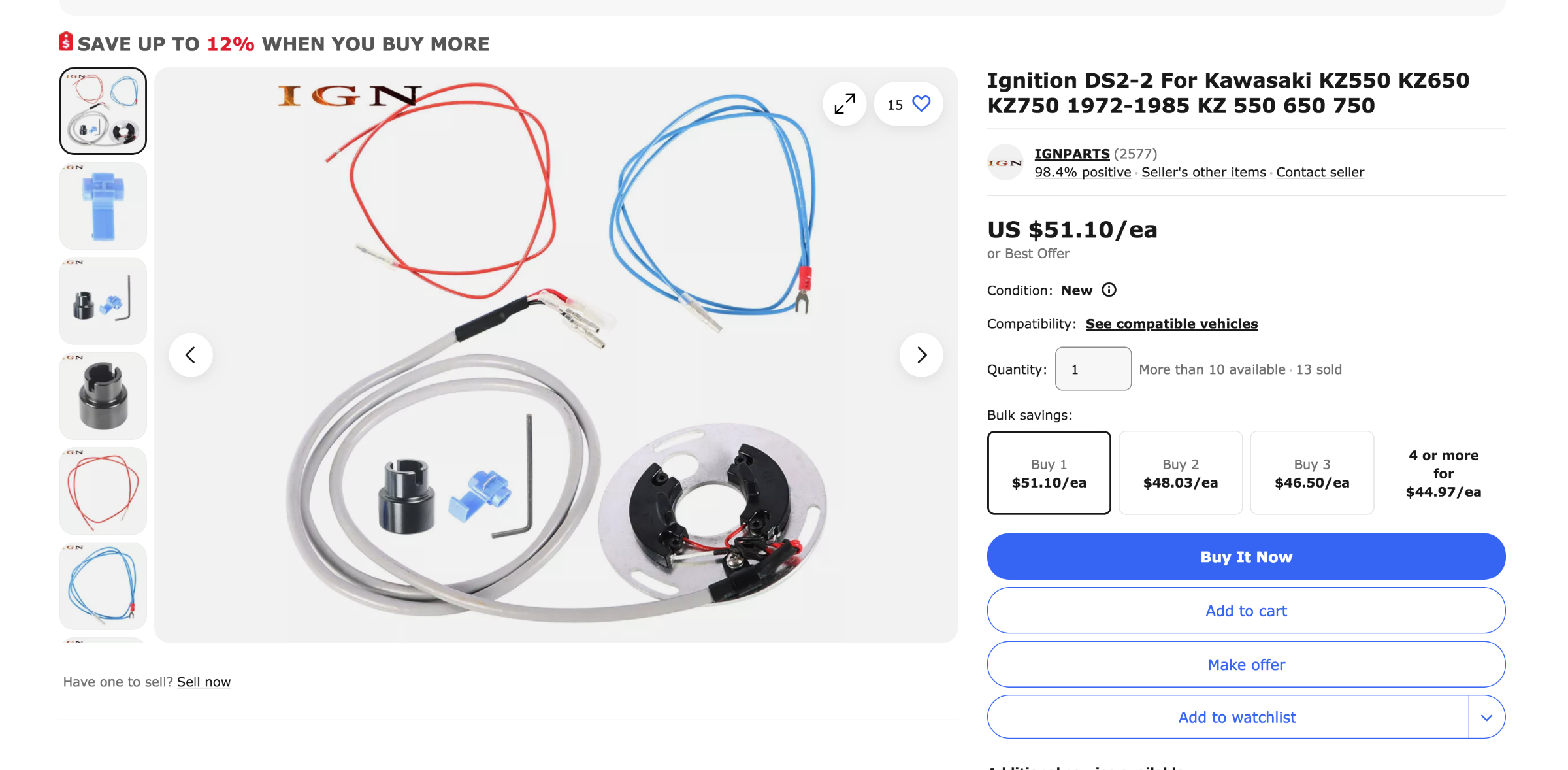

There's plenty of resellers of the Chinese ignition plate which all come from the same Chinese sweatshop.
Take your pick from whichever has best price/delivery time.
Just make sure you buy the correct one for your 650 as the one for 900's is a different diameter backing plate.

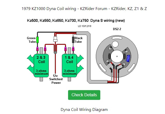

As it's a copy of a Dyna the fitting should be similar - There are several videos of "how to" on YouTube and also I have included a Dyna wiring diagram
