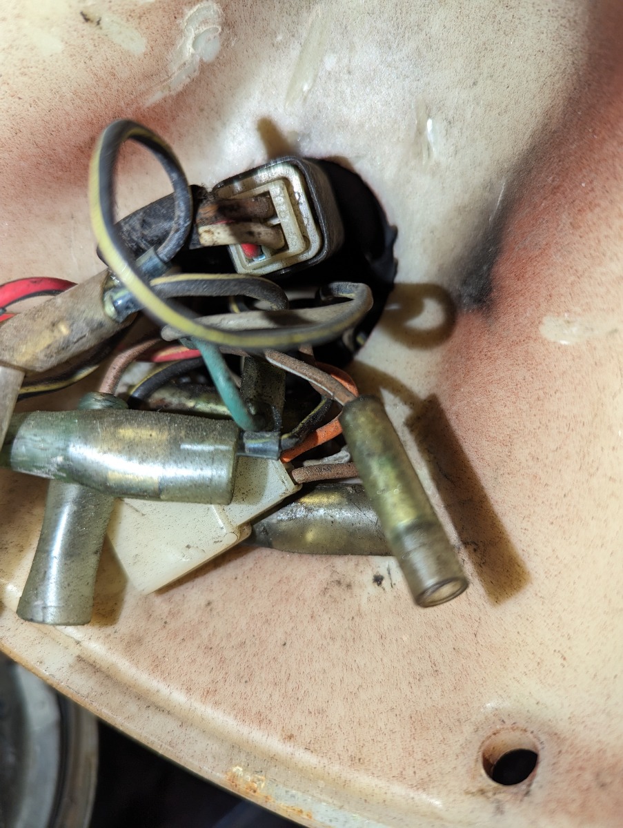

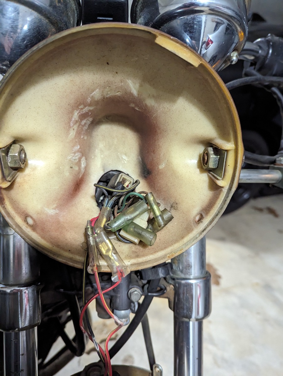

Thanks and anything special I'll need to do with that headlight? Seems it should just plug into the H4 plug no? Didn't look that closely when I had the headlight off but seemed there were some extra wires going into it besides that but maybe that's just to keep them out of the elements?

No, the existing headlight is probably the original, and I'm talking about all the extra wires sitting under the cover

It is original on most bikes of this age to have the front end wiring stuffed into the headlight, they could be a PITA to get back in even when they were new

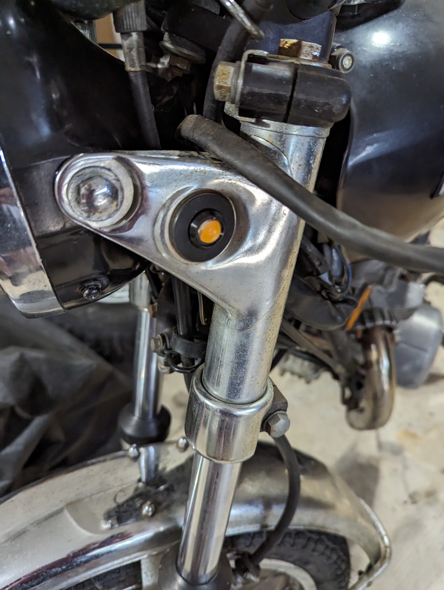

Re: Flasher replacement '76 KZ400
07 Apr 2024 16:20
Headlight will be here later this week but finally got the blinkers replaced, lot more work than it should have been mainly because the LEDs had super thin wiring, but that's more my fault, should have known based on how cheap they were. Had to make a ground for them but was able to reuse some of the original hardware and didn't have to cut anything but the power wire really so it could be swapped back if needed.
Now just have to decide what to do on the rear, thinking either use more of those for the blinkers and a plain LED brake light or getting a combo brake/blinker strip light and probably trimming down the fenders a little too.
