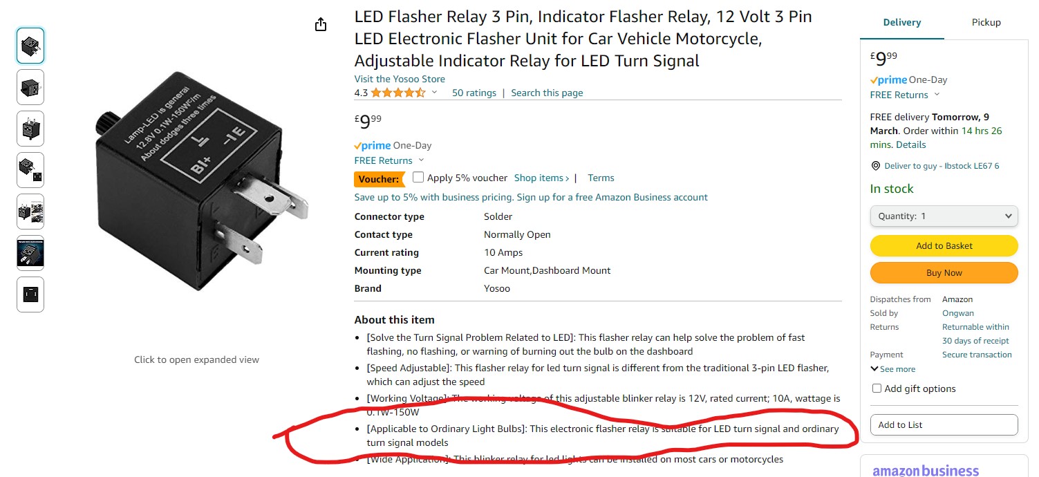

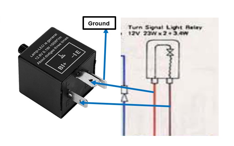

08 Mar 2024 02:40 - 08 Mar 2024 02:57To start with you need to understand how the different types of flasher relay operateI've heard that you need the correct flasher for LED bulbs because the standard flasher cannot sense the lower current load of the LED's (and causes rapid flashing as if a bulb is out). Maybe the opposite is happening when you use an LED flasher with standard bulbs and the high load blows your fuse ? The electrical guys here would know for sure. (Wookie - does your cartoon apply here? )
Mechanical (load sensing) - One of the contacts is attached to a "bi-metal" strip, when the flasher is operated current flows through the BM strip and the contacts. This current flow generates "heat" which causes the BM strip to bend and open the contacts (off) with no current flowing the BM strip cools and straightens closing the contacts again (on) this cycle continues until the flasher switch is de-activated. The wattage of the bulbs determines the current flow and there fore the speed and distance the BM bends (the flash speed)
Electronic (non load sensing - normally with three wires but not always) - These flasher relays replace the BM strip with an integrated circuit and the flash speed is controlled by a "timer" as opposed to current flow. therefore regardless of whether you use LED's or incandescent bulbs (or how many bulbs as long as don't exceed the current rating of the unit) the flash speed won't be effected as it is determined by the "timer circuit"
I suspect in this case the problem is in "how the relay is wired". There are different types of electronic flasher depending on whether they are intended for a vehicle with "multiple bulbs or LED's" or if they are intended to be used in conjunction with a tow-bar on a car (this type have to power an additional warning light to be legally compliant - in the UK and Europe at least)
To blow the main fuse you would need to either
- draw in excess of 20amps which would equate to 240 watts of lighting (11 x 21watt incandescent bulbs )
- Incorrectly wire the 3-wire relay which would cause a "short circuit"
- Use the wrong type of 3 - wire relay
47 watts/12 volts = 4 amps so well within the capability of a flasher intended for LED's

Many thanks for all that detail and as I'm an idiot with all of this I need to ask what am I supposed to do with that ground prong from the one you shared above? Assuming I can't leave it open, do I need to run a wire from it to a bolt on the frame or the battery itself? The one I'd used that blew the fuses only had two prongs and was recommended in an older post on here so I assumed it would be OK to run but obviously wasn't. Also entirely possible I had it plugged in backwards, though I tried it both ways and blew the fuses both times.
'76 KZ400
- Posts: 6941
- Thanks: 4358
Re: Flasher replacement '76 KZ400
08 Mar 2024 07:55Grounding the "E" prong to the frame or battery neg will do the trickMany thanks for all that detail and as I'm an idiot with all of this I need to ask what am I supposed to do with that ground prong from the one you shared above? Assuming I can't leave it open, do I need to run a wire from it to a bolt on the frame or the battery itself? The one I'd used that blew the fuses only had two prongs and was recommended in an older post on here so I assumed it would be OK to run but obviously wasn't. Also entirely possible I had it plugged in backwards, though I tried it both ways and blew the fuses both times.
PS: Don't beat yourself up, there are a lot of people who earn their living repairing vehicles that struggle with electrics
