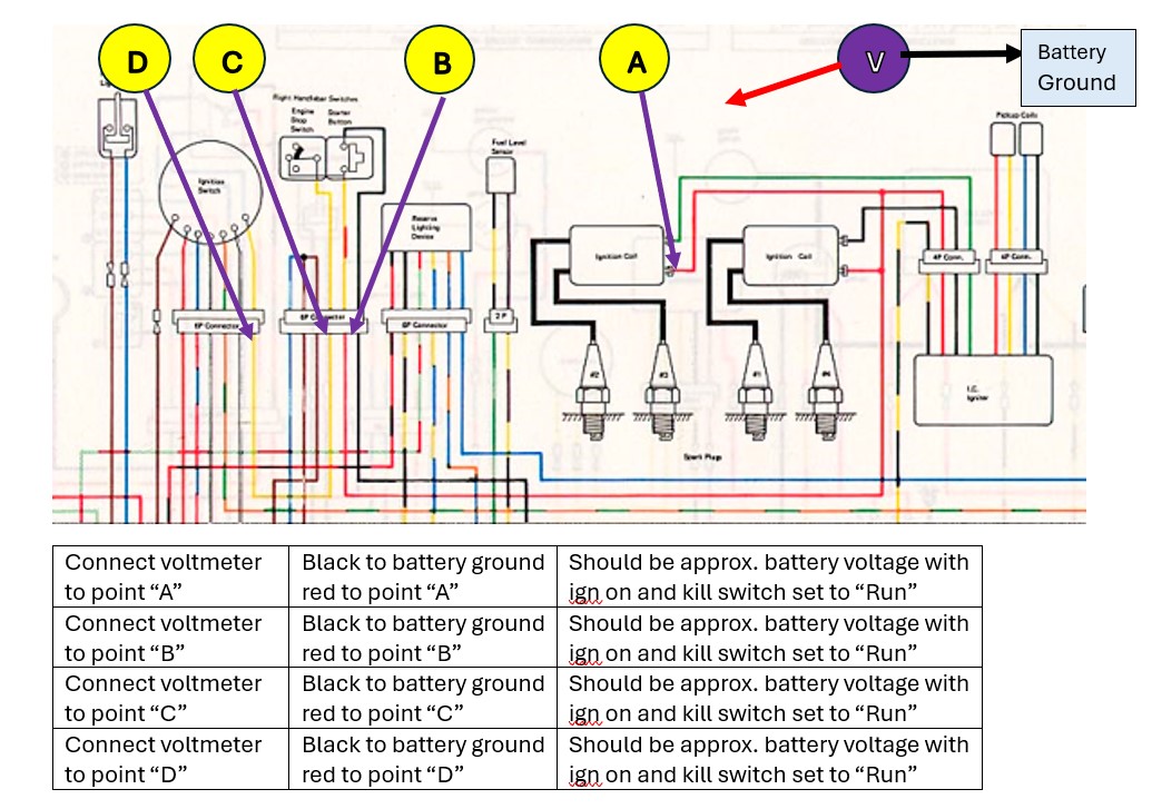

Have you checked you have battery voltage at the coils from the kill switch when the ignition is on

It appears I do not have voltage going to my coils, possibility of a short in the kill switch? Might not be connecting the black probe to the right bit, not sure if I can just ground it anywhere. No difference with kill switch and ignition on and off

A 0.20vB 0.20vC 10.09vD 0v
sorry for the late response, been ultra busy with work. Took me a minute to figure out the ignition switch connector was inside the headlight shroud too lol
- Posts: 5881
- Thanks: 3679
Re: 1983 kz750 f1 4-cyl no spark, good parts.
25 Feb 2024 22:54
The difference between "B" and "C" would suggest the kill switch is faulty however the 0v reading at "D" doesn't make sense as this supply's "C"

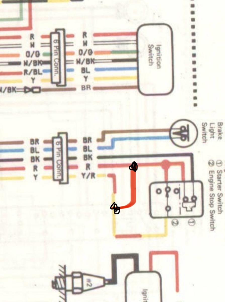

Is there any way to bypass the kill switch to test this? I’ve bought more parts trying to fix this issue than I’m proud of, and I don’t get paid until the end of the week for more.
or cheap replacement/rebuild advice.
could I bypass the kill switch to test? See image below for what I mean
Last edit: 26 Feb 2024 10:31 by LeftyFix. Reason: Addition
- Posts: 5881
- Thanks: 3679
26 Feb 2024 10:47 - 26 Feb 2024 10:51
Yes you can, I would suggest poking your bridge in the back of the multiplug and using a fuse in the bridge (just to be safe) On the upside you can sell all the parts you replaced that didn't fix it and recover some of your spend

The kill switch was indeed the issue! Shorted the red and yellow wire in the kill switch connector and it gave me power to the coils and spark! Enough to make it sputter with ether, and make me realize i forgot to replace the exhaust gaskets on the headers.
going to disassemble the kill switch at some point in the future and see if I can’t clean it up a bit, but just to get it running I will call this a great success. Thank you for all your help and I wish you ease in fitment of all of your future modifications.
