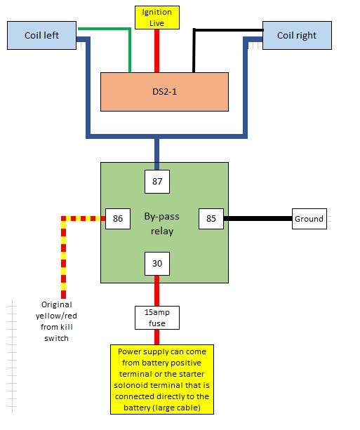

Rolf I think you are getting yourself in a muddle with this, hopefully the below will help. As long as the cables are at least the thickness of the original yellow/red you will be fine
The following user(s) said Thank You: sf4t7, howardhb, Rolf1976_KZ900

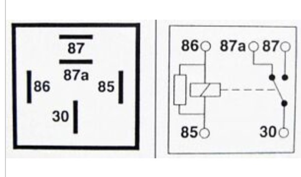

Thanks for the diagram i think will manage how to wire up the relay now .

You can feed the Dyna and the coils from the output of the by-pass relay (terminal 87) when it comes to checking the switches (kill and ignition) before you dive in and take them apart measure the output voltages using the same method as the coils (everything connected as normal)

Ok thanks i starting to see more clearly now,but when i look at the relays they might not be used .I will try measure the switches.
