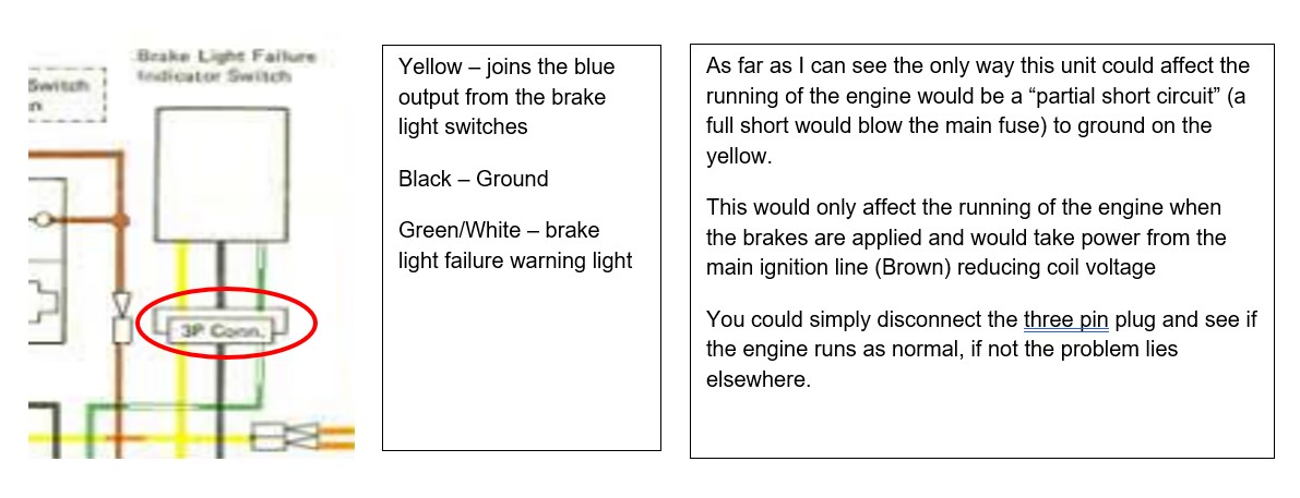

What colour wires are going to this unit? I suspect it's a brake light failure switch which won't effect the ending running!

Hello Wookie58 i can not check that before tomorrow, but i think one is yellow and one gray the third im not sure i will check tomorrow. The unit they go into is like a box filled with brown epoxy and they looked busted up at the point they enter into the box. By the way i forgot to mention that on the last short trip i was first driving to a store 5 minutes from me and the last 50 meters before parking outside the store i could smell burnt electrical wiring .I parked the bike and tried to smell if it was from my bike.But the funny thing was that there was 2 girls with electrical standing upright bikes (not sure what they are named in english ) parking 2 meters from me so i was not sure if the burnt electrical smell was from the bikes the girls had. At that point i notised that the strange white diode/relay/connector box
had fallen off its fastner and was laying down on the valvecover. After that i started the bike and drove about 5 minutes before i understood that i had to go to nearest gasstation to check more because the bike was running so bad. It was no burnt electrical smell on the trip from store to gasstation and the 3 fuses in fusebox onder left sidecover was ok.

Please see below (if the unit in question is the brake light failure switch) also switching the wires on the brake light switch is not a problem, it's simply a "make" or "break" connection between the two wires.

Thanks Wookie58 for your information i read this now after working on the bike in the garage.I will test to disconnect the three pin plug tomorrow.Today i have done alot of other things trying to solve the poor running.

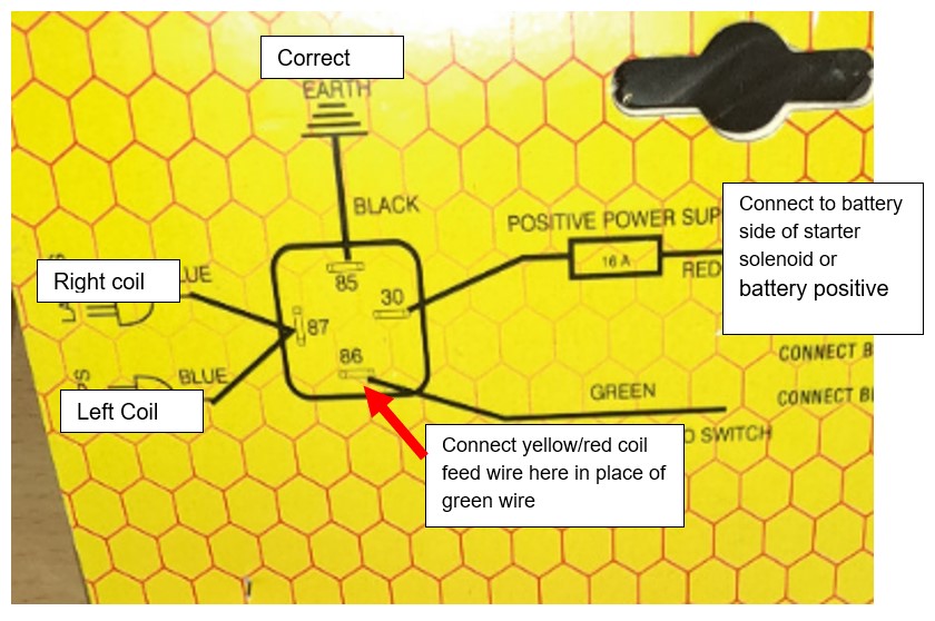

Ok Wookie58 tomorrow i will testrun the bike and if still runs bad i try to do the relayfix .Im hoping i can use the headlight relaykit i bought earlier .I have used a almost similar kit on another bike so it got more power to the bulb in headlight i use a 100watt bulb without any problems .

Re: Bike started to run real bad today electrical or carbs??
23 Aug 2023 15:31That should do the trick, 100watts is 8.3amps at 12v so will do the trick (what is the current rating of the relay?)Ok Wookie58 tomorrow i will testrun the bike and if still runs bad i try to do the relayfix .Im hoping i can use the headlight relaykit i bought earlier .I have used a almost similar kit on another bike so it got more power to the bulb in headlight i use a 100watt bulb without any problems .

I just took a closer look at the kit.I dont think i can use it because the wiring is thinner exept the red wire .The connectors also look bad quality.The other kit i have used for the headlightmod on the fj1200 looks much better. I find a pick of that kit tomorrow . I also starting to wonder how to connect the wires even if i look at the diagram that is for the coil relay mod.
I dont know if i will have to solder to the coils or if i can splice with the red/yellow wiring ? it is very late now so will continue tomorrow drawing how i probably will do it and then se if you guys find something wrong

This kit will do the job, the ground current is less than 1amp (switch current for relay) each coil is 3-4amps (less than a 60w headlight which would be 5amps each) and the relay is rated at 30amps which is more than adequate
24 Aug 2023 02:09
Thanks Wookie then i may use the kit i have, but need better quality terminals. In this post i have some info on the relaykit that was used on the FJ I thaught that it was not going to be too difficult installing the relaymod for coils,butnow im confused. In the coilwiring diagram there is a wire named power to coils and im unsure if thepicture is of the coils or the pickupcoils .Also dont understand how to wire things up so i drawed 2 differentdiagrams to see if you guys can confirm if i can use any of them? When it comes to electrical stuff im no good.I think i will have a look inside the killswitch and headlamp to se if there is some burnt or corrodedconnections today also.
