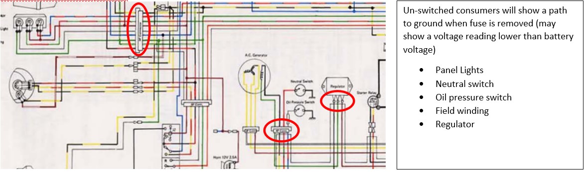

15 May 2023 05:35 - 15 May 2023 05:52Voltage doesn't blow fuses, current does. If I have time later I will put you a "test plan" togetherI think we are talking about different tests. The test I've done is without a fuse, and the voltage reading indicates that the output of the fuse is grounded somewhere in the circuit. Agreed
But disconnecting the regulator the voltage disappears. The wiring is fine. The motorcycle does not blow the fuse when cold with the ignition on. If your RR is electronic is it the OE or aftermarket combined unit which normally has 5 wires (none of which are connected to the Ignition circuit )- How have you wired it ????
It is the typical bastard failure that appears only when the bike warms up. It may not be temperature related, a partial short will take a little time to overload the fuse

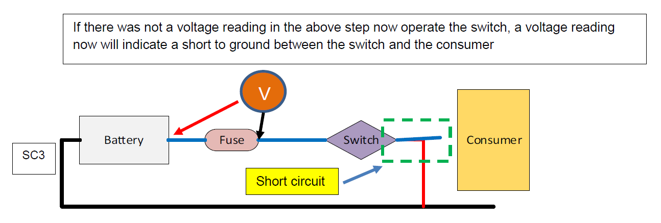

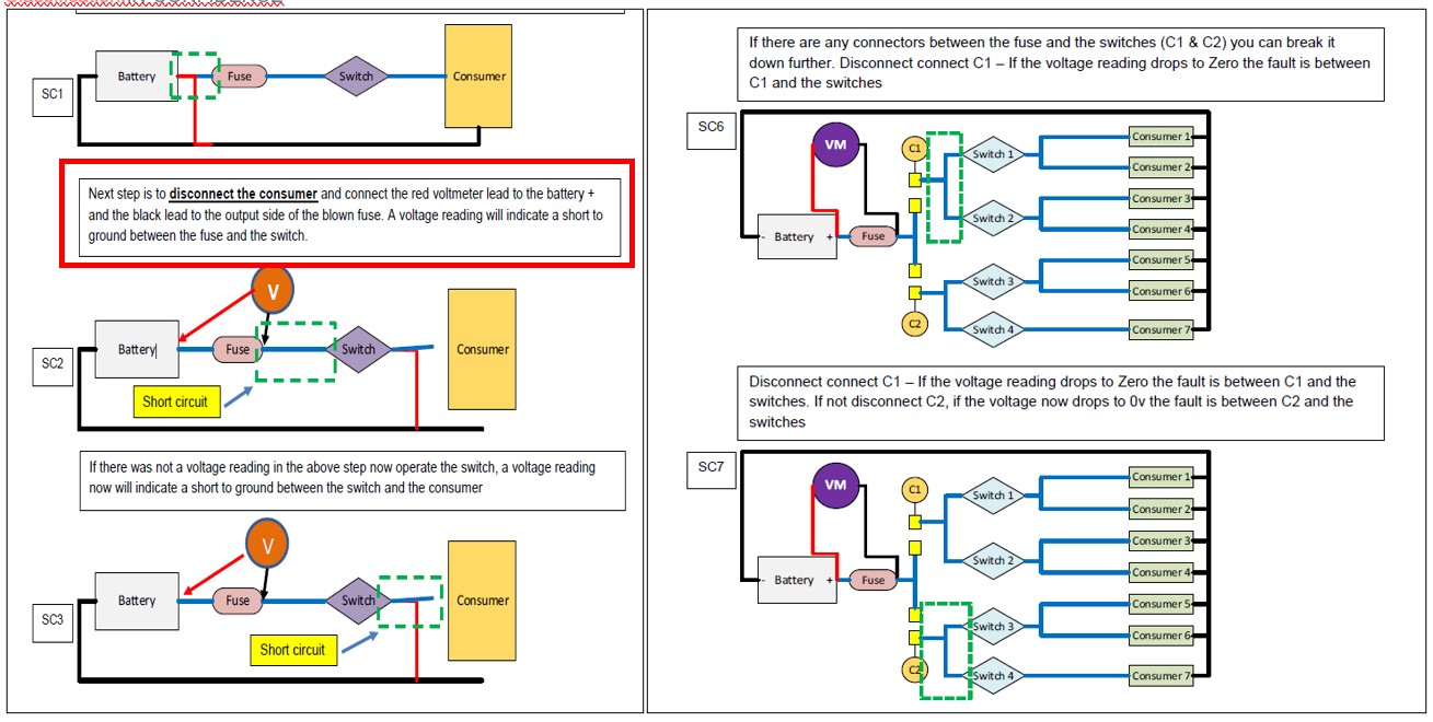

16 May 2023 02:53 - 16 May 2023 02:55Feanor it's good to see that you are using my guide, however you need to read the section fully and digest. Also don't skip any steps or you will disappear down a "rabbit hole" and drive yourself mad. The section you are using specifically says "disconnect consumer" - (this is because your voltmeter will see a path to ground through un-switched consumers when there is no voltage supply to them)I started with the tests. I measured voltage between the positive terminal of the battery and the output of the main fuse. There was no reading. But then I turned the key and surprise: 11,30v.
I mean, I'm at this point:
I have observed that if I operate any other switch the reading goes up to 12.5V
Any suggestions? I'm going to check the handlebar controls.
You need to concentrate on the section that applies the principle to a circuit with multiple consumers
Below I have given a suggested way forward - intermittent faults are always the hardest to find

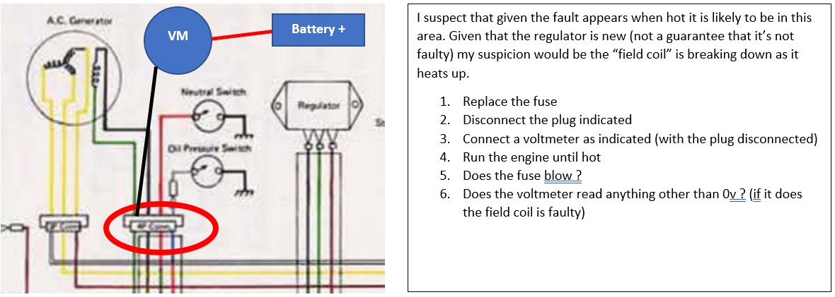

I checked the resistance of the field coil and it is within normal values (cold).
I think I could take it apart (which doesn't seem complicated) and stress it with a hair dryer, then measure the resistance.
Would it be a valid test?

The resistance of the field coil isn't the issue, I suspect when everything is hot (the field coil and the engine casing) that the insulation is breaking down. This won't potentially effect the coil resistance but it will allow it to "bleed" to ground. The test I have suggested is probably the easiest and most accurate

19 May 2023 12:40 - 19 May 2023 12:41I took the motorcycle out onto the street (everything connected) and after going about 30 meters the fuse blew. I checked the voltage across the coil, zero. I put in a new fuse and drove for a while (with everything connected), it didn't fail again.
I will repeat the test, and at the time of failure I will repeat the exact steps you have indicated.

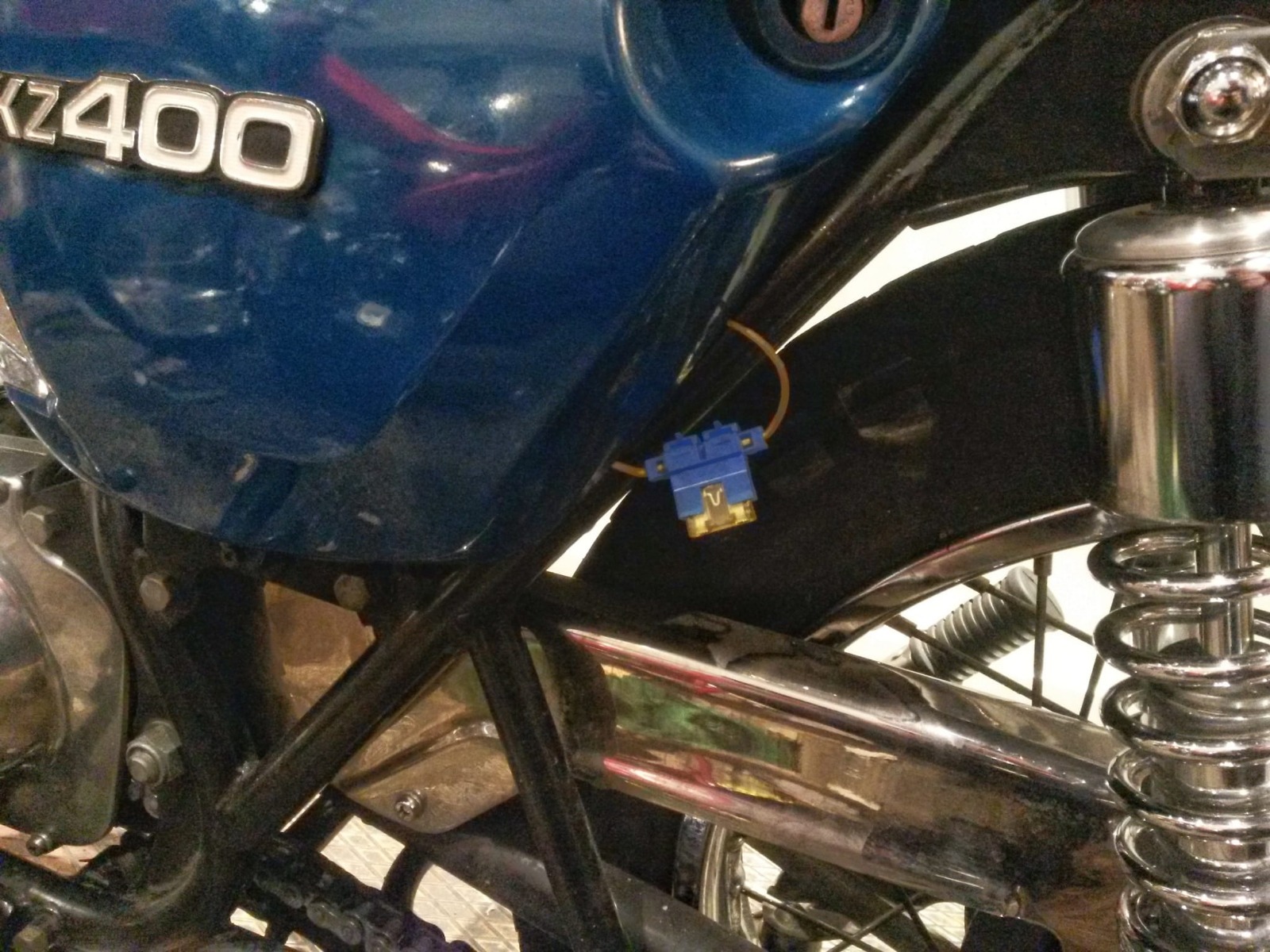

01 Jun 2023 03:06When I did this fix (automotive fuse holder), as soon as I started the fuse blews (30 seconds).
But since then none have blown again, and I have done nothing more than replace the blown fuse with a new one. Maybe was a bad fuse? They are all recovered from scrapping.
So I couldn't do the test you told me. I will continue using the bike, and will write again when there is any news.
Thank you all.
