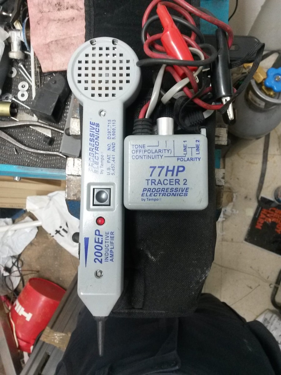

I also have this little gadget that suddenly appeared but I have no idea if it will work for this hehe
