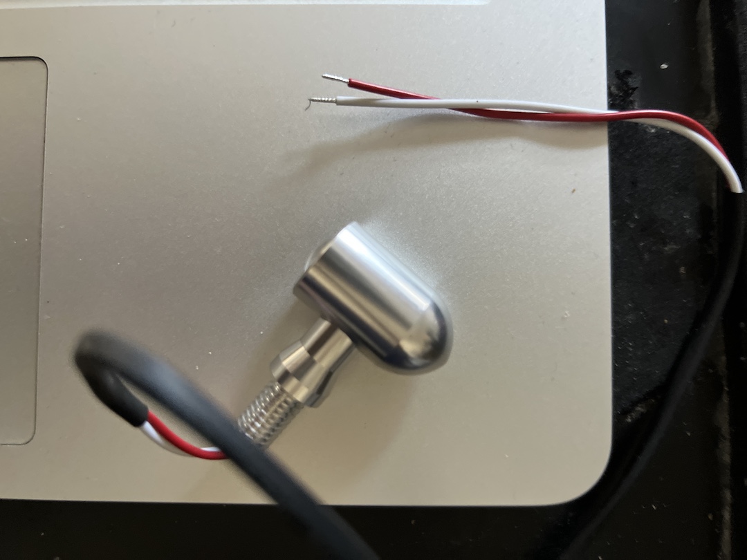

I like the stock lights up front on my kz650. I want smaller lights in the back, and found a nice pair of LED ones seen below.
Ive heard a lot of conversation about the LEDs not drawing enough current, and a flasher or something like that being needed?
Can I run stock up front and rear LEDs in the back? If so, how so?

Youre right. In the meantime I searched the web and found the answer: inline resistor.

If it just the blinkers you can change out the flasher. They have them on the ebay . My. Zx7 had one when i bought it . Worked good .

I forget. Would an electronic flasher from the auto parts store work with LEDs?

16 Mar 2023 06:09Should do, any non-load sensitive flasher unit should do the trickI forget. Would an electronic flasher from the auto parts store work with LEDs?

Thanks. Modern bulbs sometimes don't work w the original flasher & the fix is to get an electronic unit. but I forgot
if this also did the trick for Leds. doh.
