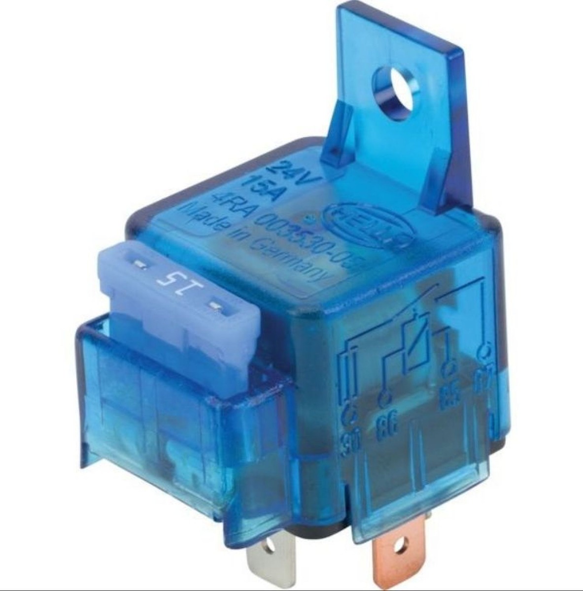

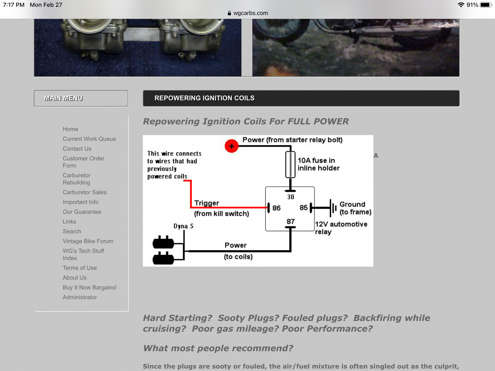

There are a few things to consider here, firstly the guys are 100% right ref fitting a by-pass relay (the rational for this is in the below post)

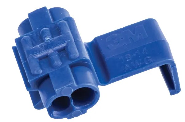

When you talk about a blue block splice do you mean a "scotch lock" if so throw it away they are rubbish and will cause problems down the line.

HI THANKYOU SCIROCO FOR YOUR IMAGE AND INFO ON THE RELAYS I HAVE FOUND SOME ON EBAY ,AND WOOKIE THANKS FOR THE INFO ON FAULT FINDING AND MORE RECENT WHEN I SAY THE BLUE BOX THATS WHERE THE 2 WIRES DOWN FROM THE POINTS COME UP ALTHOUGH NOW IT HAS THE ROUND TRIGER PART IN THERE ,AS YOU SAY I HAVE TO FIND OUT WHERE I HAVE THE DROP IN VOLTS I HAVE 1 HR TOMORROW TO START THEN I WILL GET INTO IT AT THE WEEKEND
