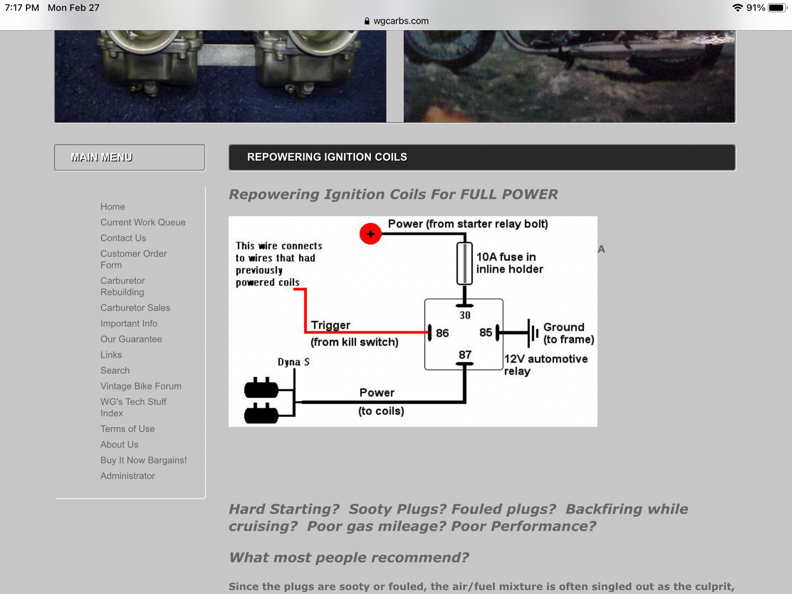

Not to undercut F64 as he is a great electrical trouble shooter, but if you need or want to ride WHILE you work with F64 try is mod. It will safely get you riding while you work through your wiring issues.

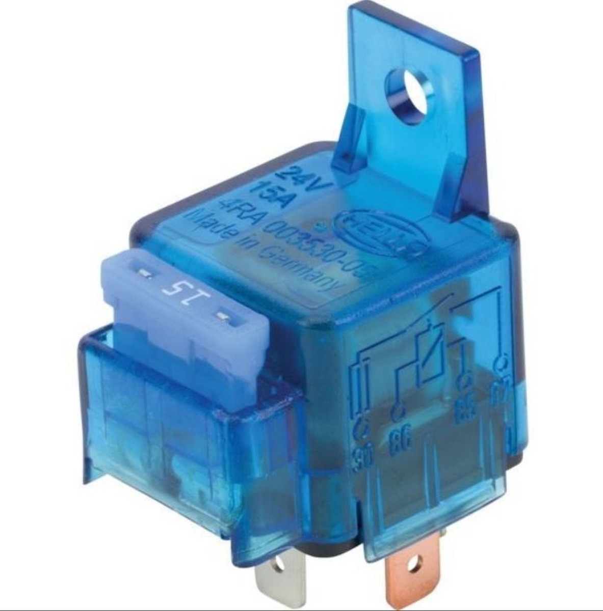

There are a few things to consider here, firstly the guys are 100% right ref fitting a by-pass relay (the rational for this is in the below post)
Ignition by-pass relay W - KZRider Forum - KZRider, KZ, Z1 & Z Motorcycle Enthusiast's Forum

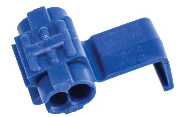

When you talk about a blue block splice do you mean a "scotch lock" if so throw it away they are rubbish and will cause problems down the line.
