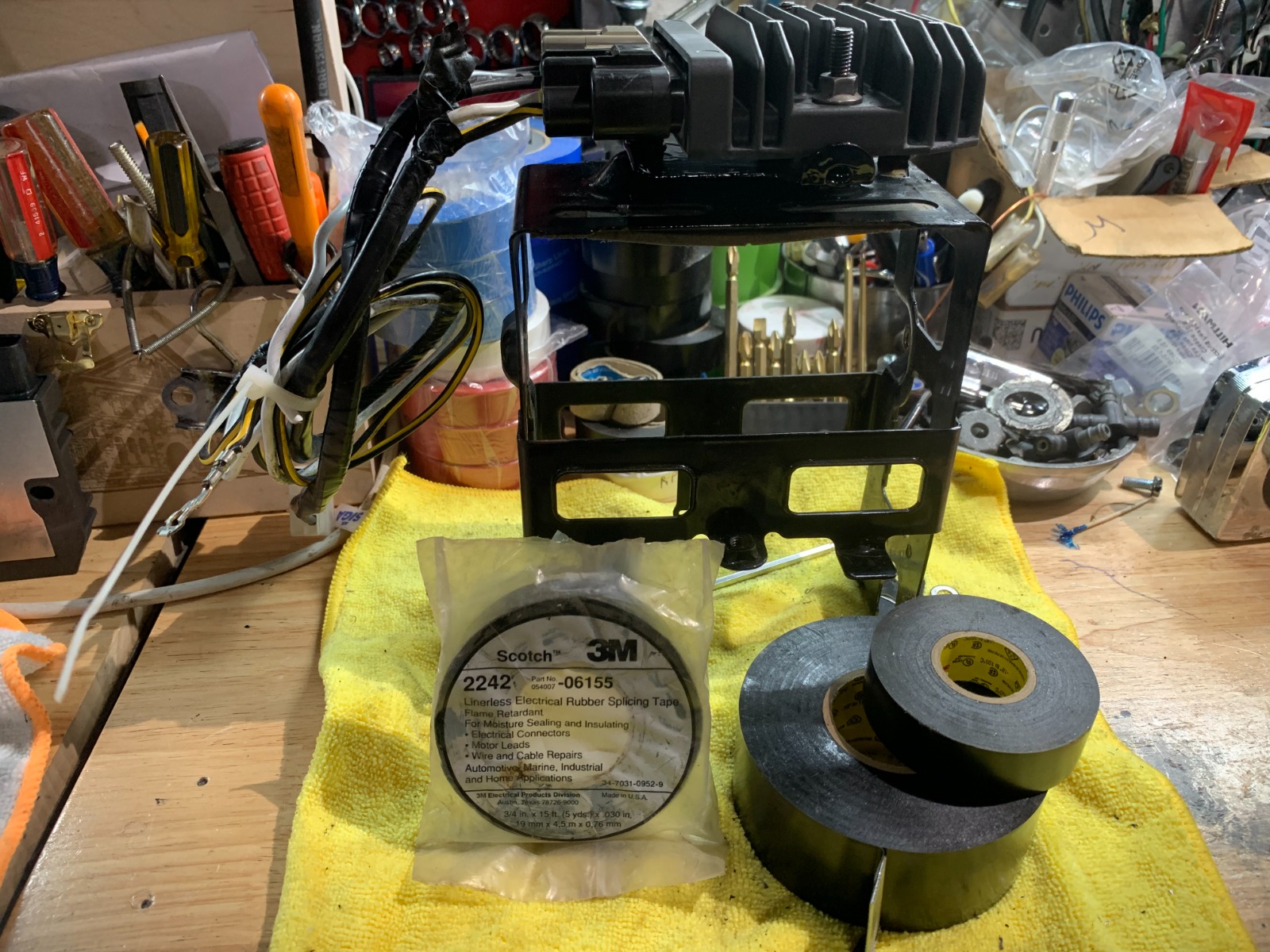

. after 50 years in IBEW, 45 working, 33+ is best, the 2242 rubber is a self sealing rubber, molds to itself, for excellent waterproofing, spent quite a few years in traffic signal installs, only tapes used in overhead splicing, years later sometime for modifications, if a splice has to be opened, still perfect, if done correctly, 3m is pricey, contractors always tried to send something cheaper, but we were stubborn, pic includes a mosfet hookup for my 650, got entire harness and reg/rec for $55, from a 2011 or so zx14, have a nice day kids
