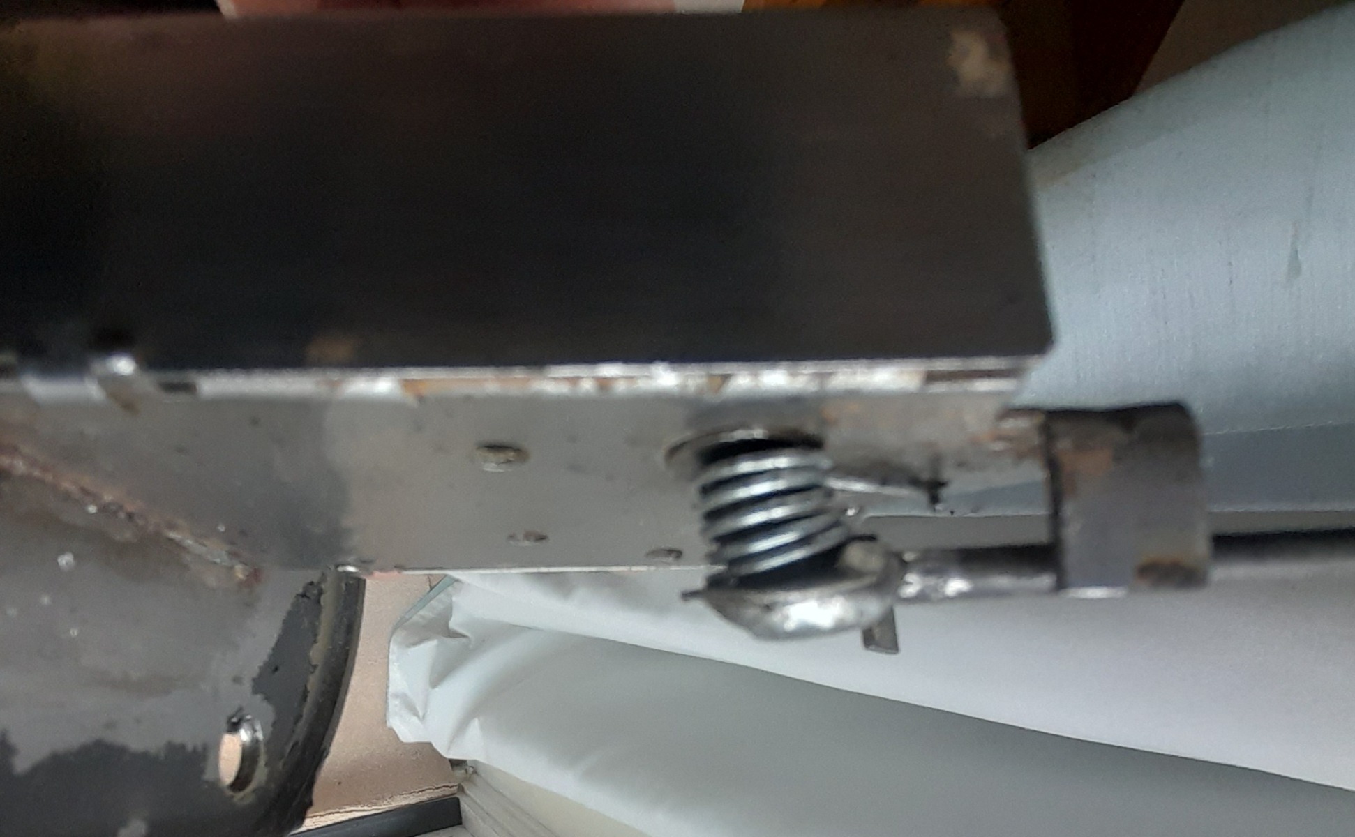

OK, just to round off the thread. After trying capacitors upto 1000uf in both series and parallel on the sender wires it made absolutely zero difference. So figuring to do what I was after achieving would require some serious circuitry and far beyond a simple fix my thoughts turned to a mechanical fix to the float/arm itself. Figuring if I could add some permanent friction between the arm and the sender body which would then reduce the immediately floppyness of the arm it would then result in what i was after. Once I decided to explore the mechanical possibilities the answer was obviously to put the arm under spring tension. The arm is still totally free to move but it takes a very little pressure or a slight jiggle, as if when ridding, to get it to move. I'll do a more elegant version once it's been tested on the road.

Thanks, that would certainly do what I was trying to achieve and as I suspected a far more complex circuit than I can be arsed to get involved in for what is no more than a niggle as outlined in my original post.
