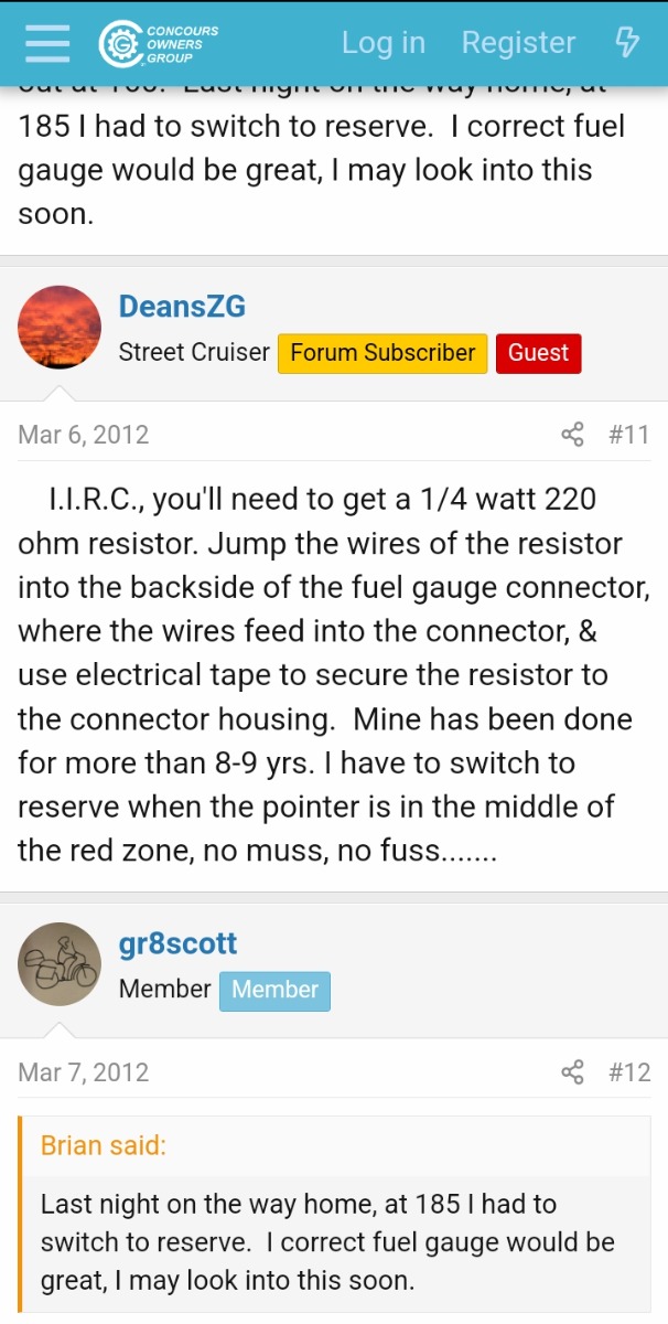

Resistors was my initial thought but after some different Google search phrases this came up.
I can kinda see how it would work but the bit that confuses me is that I assume they are talking automotive as not to much else has fuel guage and therefor a 12v system but they advocate a 5.5v capacitor.? Not being electro savvy enough to understand why?

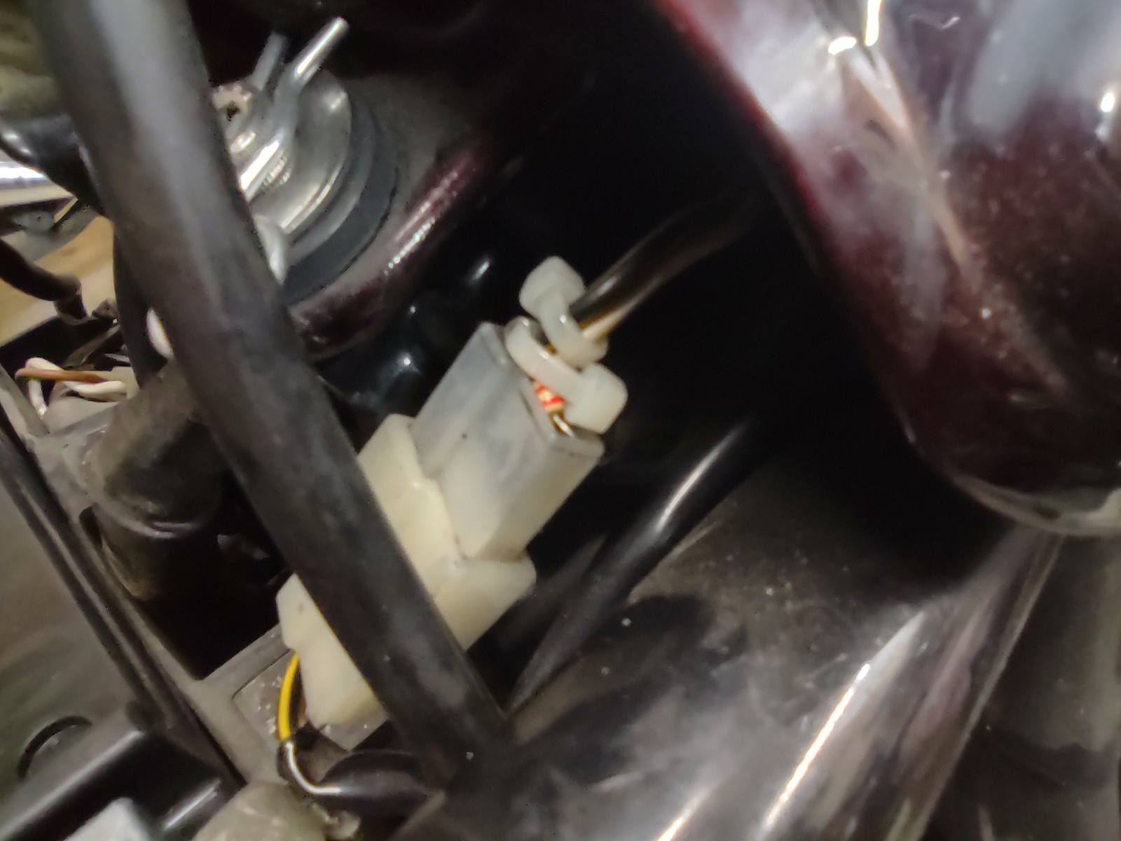

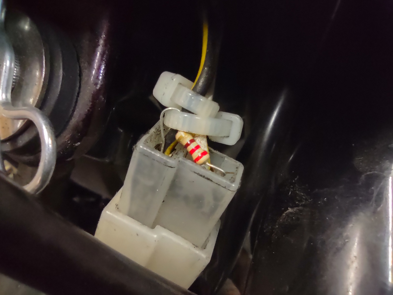

I have a tiny resistor or capacitor on my 94' ZG1000 Concours. It is hooked up to the signal and ground wires at the sending unit connection to the harness. A guy on the Concours website was giving them away. The gauge was all over the place and now it's actually useable.
You can just barely see it on the connection, the zipties hold it in. You push the wire on each side down into the proper spot in the connector.

Kelly, that looks like through hole circuit resistor. The stripes on it denote it's resistance value and temp range. Unfortunately it doesn't show the whole resistor to see if there any more than the 2 x red and 1 x blue or black (maybe).
If your a member of the concours site and can grab a pic from his post showing the whole resistor I would be very grateful.
TIA.
TIA.

Thanks, red red brown gold is 220 ohm +/-5%
