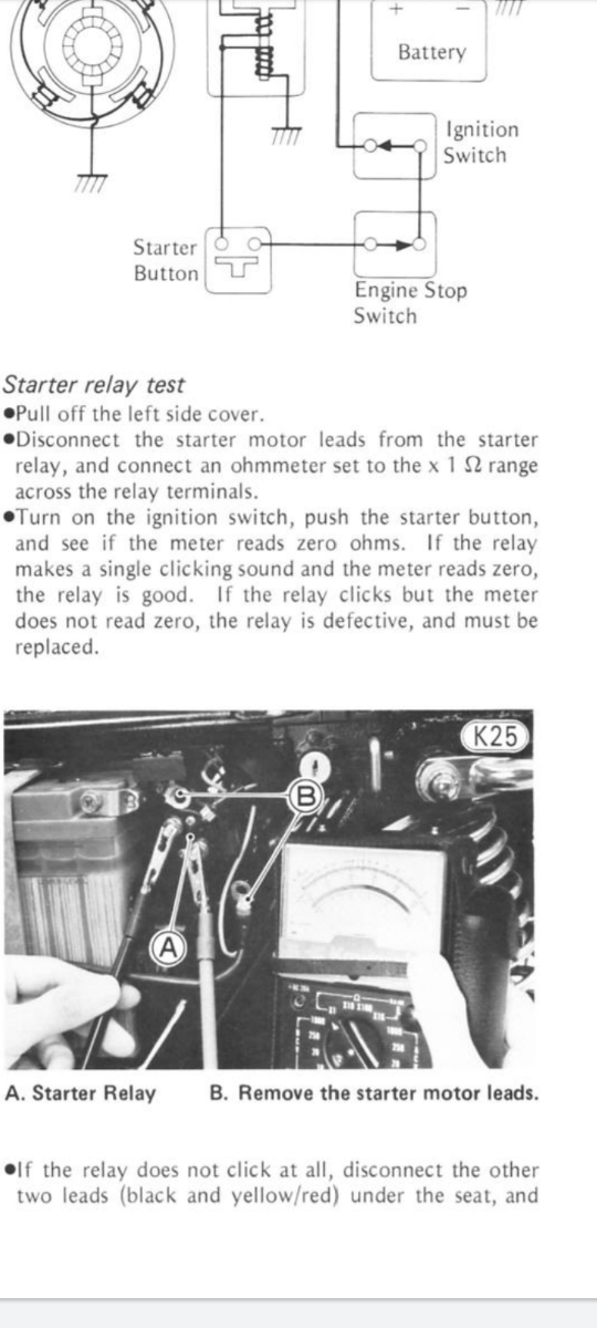

I ran the below test this morning on my relay and I was get .5 ohms resistance. By what the book says I need to replace the solenoid. I did a little experiment and bypassed the really just once to see if the starter motor would start the bike and it did. I know that is not ideal and could potentially tear things up but I just had to be sure it was in fact the relay giving me issues. Ive ordered a new relay and it should be here Wednesday. Fingers crossed this will solve the issue. On the upside, with the bike tore down I can do some much needed cleaning!!

Did you check the switched voltage and ground for the relay "as per the test plan" ???
- Qsmothers3
- Posts: 78
Re: Battery question.
28 Aug 2022 15:04
Sorry. yes I did do that and it was a drop of .1v. if I did it right.
- Posts: 6938
- Thanks: 4353
28 Aug 2022 16:05
Any idea why it lost power ?
