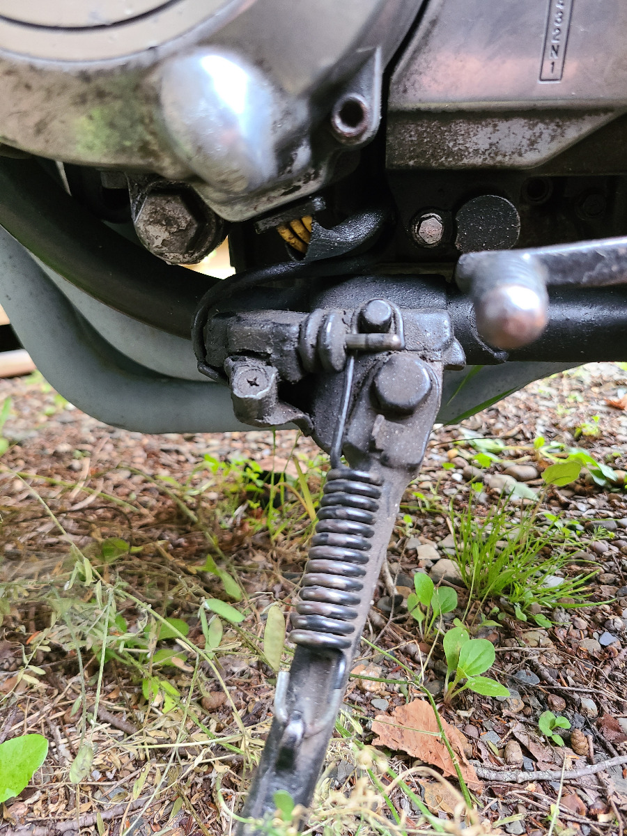

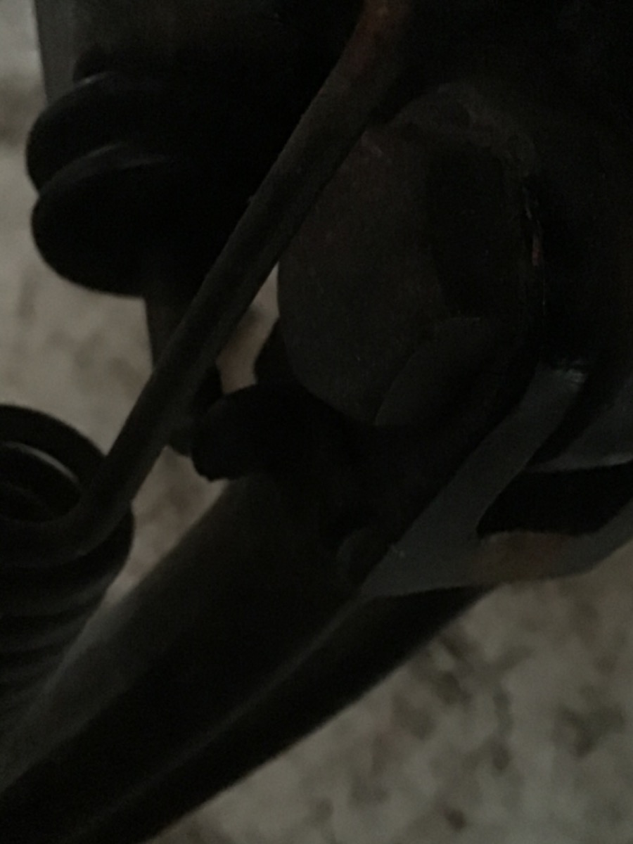

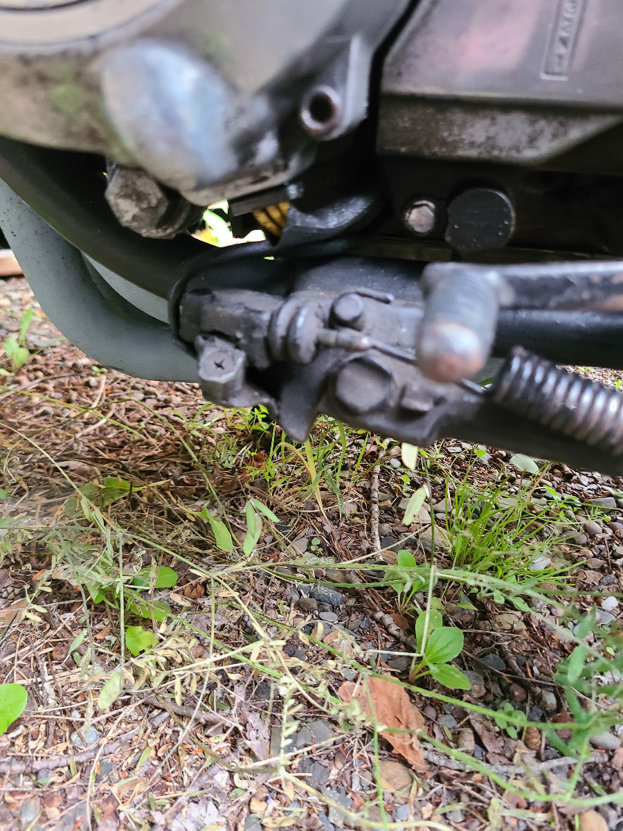

The next thing I wanted to look at was the kick stand switch. That's when I noticed this
The switch doesn't seem to be actuating in either the up or down position, and I don't even see how it would be (might be missing a piece off the stand itself?). I did try to start the bike while manually depressing the plunger, but there was still nothing, for what that's worth.
Anyway, I'm kind of at my wits end with this thing. I have no idea what to troubleshoot next, or if there's something obvious I'm missing. Any advice or direction would be appreciated.

I don't have a 550, but the side stand switch looks broken from its base. You should probably look for a new one. In the mean time, I would push the switch stem and hold it in with something....ziptie..., or something similar, and see if it would start.
....you can always bypass it electrically, but of course that implies some physical serious risks if you forget it is down.....not wise.

Okay I had a feeling that was the case. And for all I know I wasnt depressing it all the way when I turned the key, or it's just totally borked. Will look around and make that my next purchase

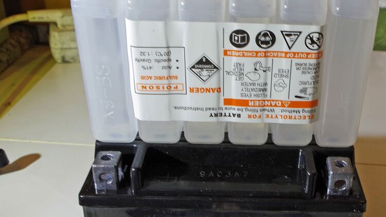

This is most likely a dumb question, but was the battery fully charged when you got it?

I heard here I think a member saying they are shipping the acid separate. Maybe as Gd4now mentioned the battery is dry.

11 Aug 2022 06:48Yes, your switch braket is bend somehow by someone.That bracket is bent . See that nub on the kickstand thats suposed to contact the switch .
New un-sealed lead batterys are shipping bone dry and the sulfuric acid comes in an extra canister for safety reasons!

11 Aug 2022 08:04 - 11 Aug 2022 08:05This is most likely a dumb question, but was the battery fully charged when you got it?
Ever so slightly below full charge. Definitely enough to start the bike, i planned to just let it idle for a few minutes to get to full charge.

11 Aug 2022 08:07I heard here I think a member saying they are shipping the acid separate. Maybe as Gd4now mentioned the battery is dry.
Factory sealed, pre activated gel-electrolyte battery. I verified the battery had a charge as soon as I got it as well as right after I hooked it up.
