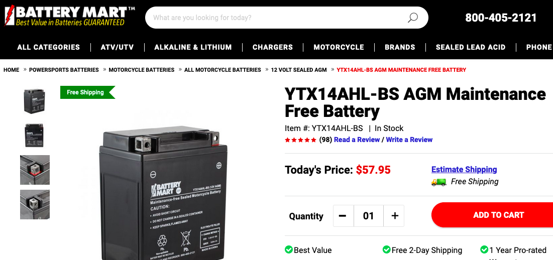

I got this "el cheapo," as my mom would say, battery. Im sure it will be fine. Anything to ease my mind about running the set up I am currently running which could lead to the lith battery exploding
Ive learned that many AGM batteries are the same, just branded differently:
www.batterymart.com/p-ytx14ahl-bs-agm-ma...ce-free-battery.html
