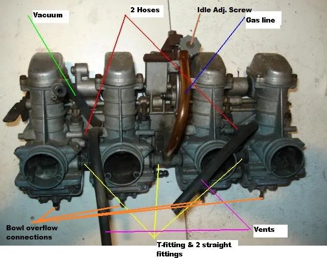

Is the vacuum port on #2 carb capped. It normally goes to the tank petcock

01 Jul 2022 11:20 - 01 Jul 2022 11:37Are you sure? I believe the kz650 with accelerator pumps came with a vacuum petcock. If you don't have a vacuum petcock, have you plugged the vacuum port on the #2 carb? And if you're running from a temporary gas bottle, then you definitely need to plug the vacuum port.It does not have a vacuum petcock.
On the #2 carb, there should be a port that feed to the engine side of the slide. Don't block the bowl vent! If you have this vacuum port and it's open, you will have a massive vacuum leak on cylinder #2.
EDIT: Photo stolen from this thread www.kzrider.com/forum/3-carburetor/60546...k-vacuum-line#757605

Ok have the carb off now. The accelerator pump diaphragm looks almost new. There was a little gunk in the square one but honestly nothing that I feel would raise alarms.
The port is capped off on #2 and the 2 bowl vents are clear.
