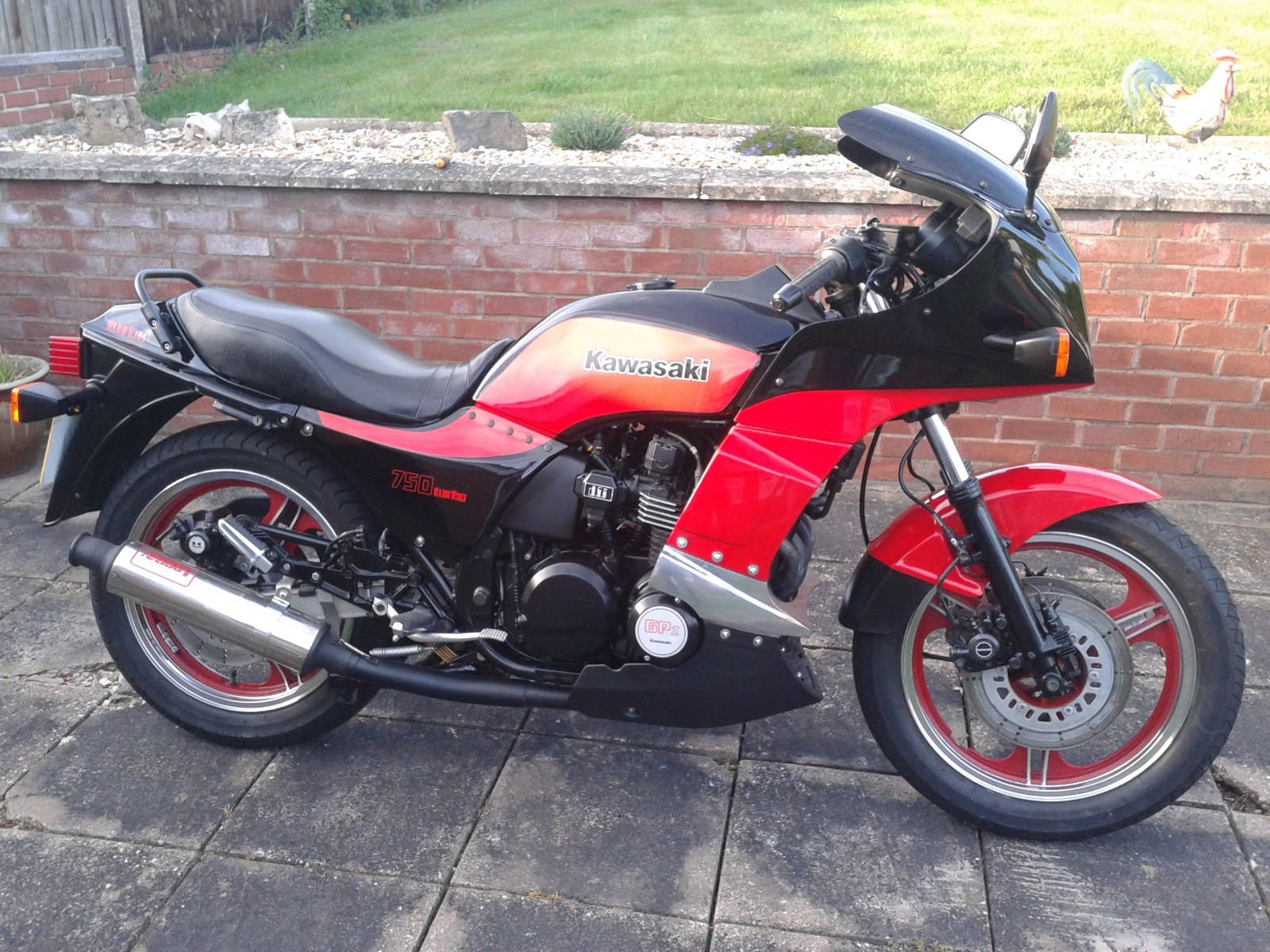

Hi all, Been out today on my GPZ 750 turbo for the first time since restoration, have done about 130 miles with no issues except the fuel gauge not working, must be sender and the batt light flashing, because of new battery without level probe fitted. after about 100 miles the oil light started to flash also, rode home cautiously for about 30 miles without issues, the sight glass has the correct amount of oil in it.
My question is could it be a simple electrical issue or something more sinister needing the spanners again ?
