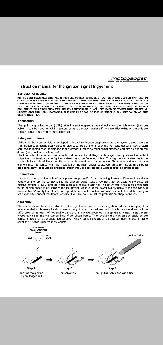

or use an inductive trigger that you affix to the spark plug wire.
revivalcycles.com/products/motogadget-ignition-signal-sensor
photo:motogadget
photo:motogadget
