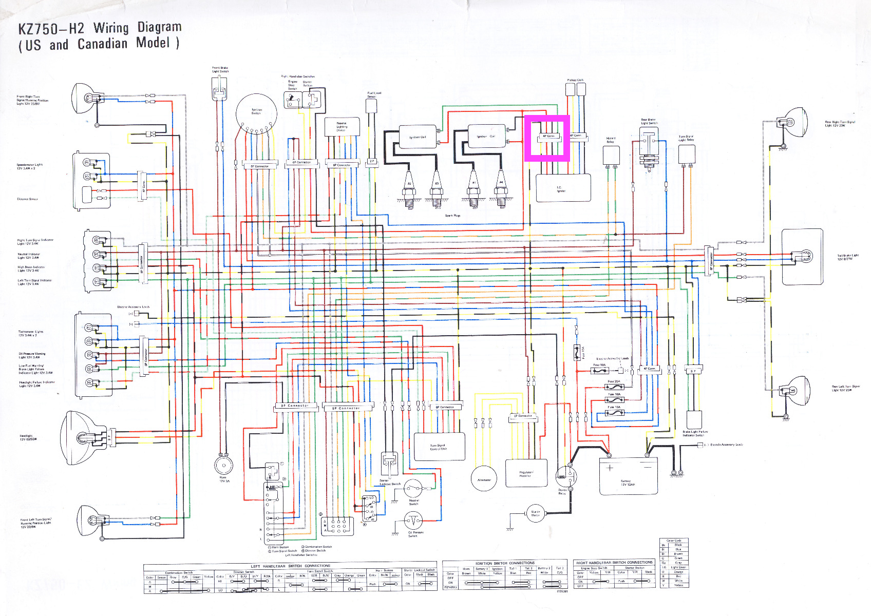

Grab your meter
meter on DC V
everything connected
key on/ignition on
black probe on negative battery post(post is the metal part of the battery not the cable)
red probe on positive battery post
note voltage
move your red probe to each of the wires in the pink box
measure the ignitor side of the connector.
you'll have to backprobe the connector as it must remain connected.
Black/yellow is ground so your voltage should be as close to 0.0V as possible.
If it's higher than 0.5V then you have too much resistance on that ground connection.
The yellow/red should be close to battery voltage that you measured at the beginning.
The green and black should fluctuate as you press the starter button.
the voltage will fluctuate between 0.0v and 12V

The voltages seem fine.
ok, we'll check your ignition pickups next.
It appears your ignitor is not sending a ground signal to the coils.
When your coils get a ground signal on the green or black wires they charge up(you'll see 0.0V on the green or black).
When the ground signal is cut on the green or black wires the coils fire the spark plugs (you'll see 12V-11V on the green or black).

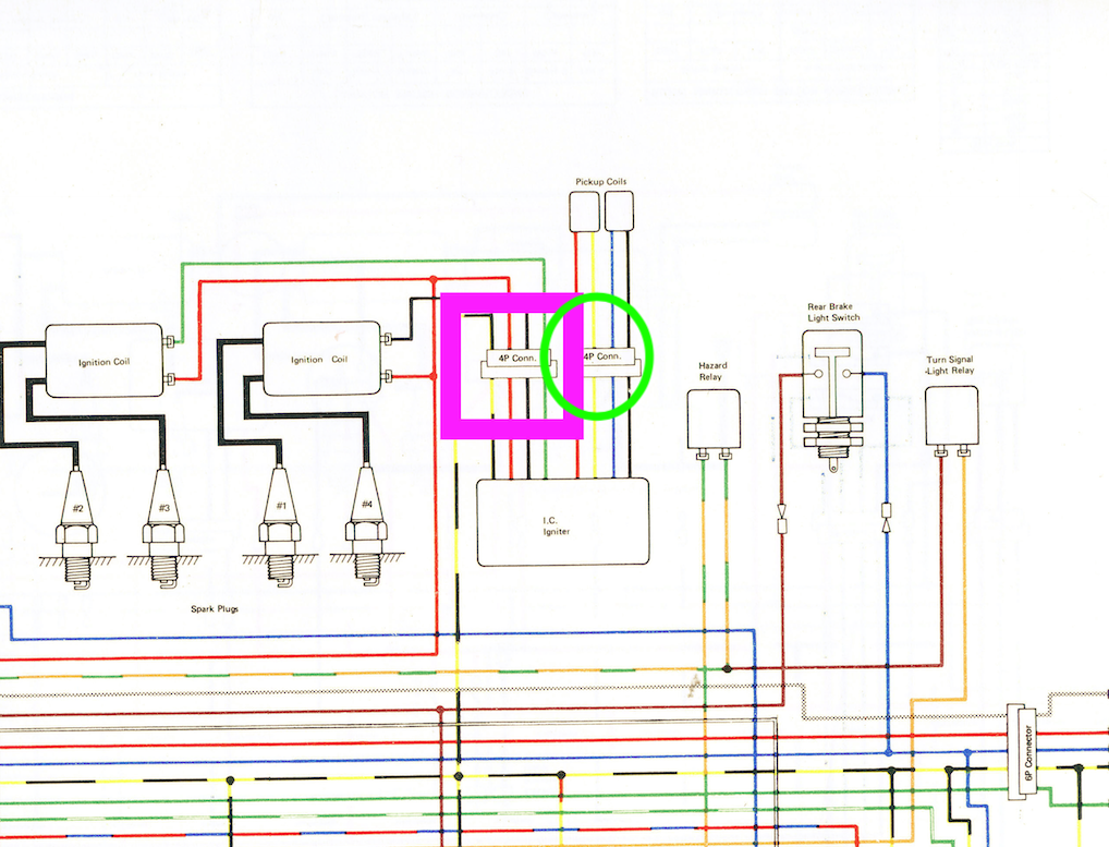

Let's check the pickups
the connector is in the green circle
meter on AC V
key on/ignition on
backprobe the connector on the ignitor side
leave the connector attached
red probe on the yellow wire
black probe on the red wire
push the starter button
you should see a low ac voltage as the engine turns
red probe on the blue wire
black probe on the black wire
push the start button
note the ac voltage

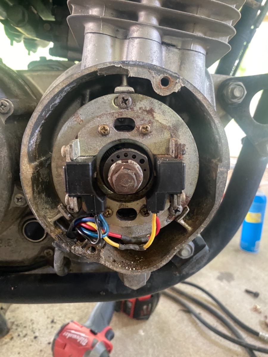

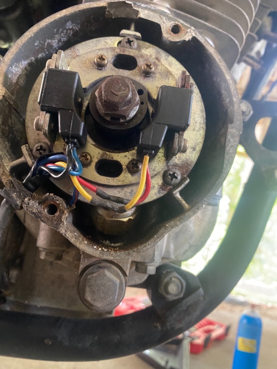

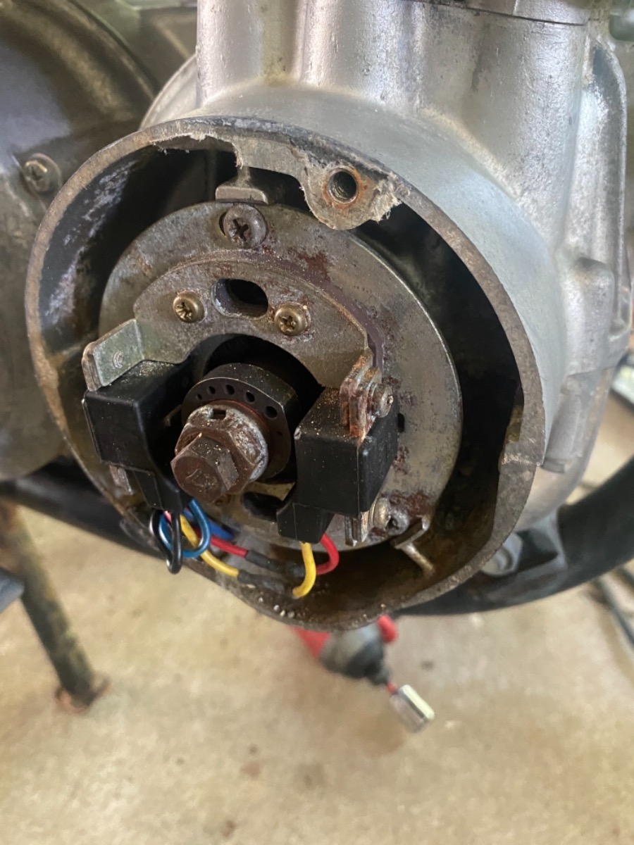

Pictures as requested. And I unplugged the connector and made sure I had connections when I turned it over and still nothing. Tried an ohm test with the same wires, nothing.

Thanks for the nice picts.
It appears your pickups are faulty.
It could be a break somewhere along the wires to the pick up.
I'm going to suggest something.
See if you can measure resistance of the wires poking out the bottom of the pickups within the green circles.
Unplug the pickup connector you were measuring from before
