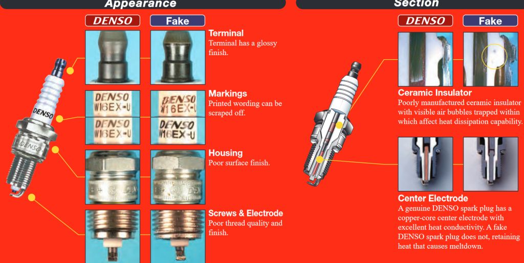

We'd be interested in seeing the opinions of members who receive plugs from the vendor above as to if they believe the plugs are genuine. Just like the infamous NGK fakes, there's a risk counterfeit ND items.
www.denso-am.eu/media/1374174/identify-c...white-paper-_pk3.pdf

I have bought from them before and have some on hand. My problem is they aren't available locally, so I can't compare to a "genuine" plug. I went through the "tests" in the link and there are no obvious red lights. Most of the plugs in the link are iridium plugs, so they look quite different, ie no chip on the ground electrode. They say Made in Japan on the box and the material is consistent. I think they are real and have had good service from them. I have had 2 in a box of 10 come with corrosion on the gasket.

When we were looking for counterfeit plug ID info it seemed all we could find was for iridium plugs. This morning we found the image below from the 2020 ND catalog. It shows conventional plugs, but lacks a little detail. There are a few youtube vids purporting to compare fakes vs genuine, but we've not watched any of them.
