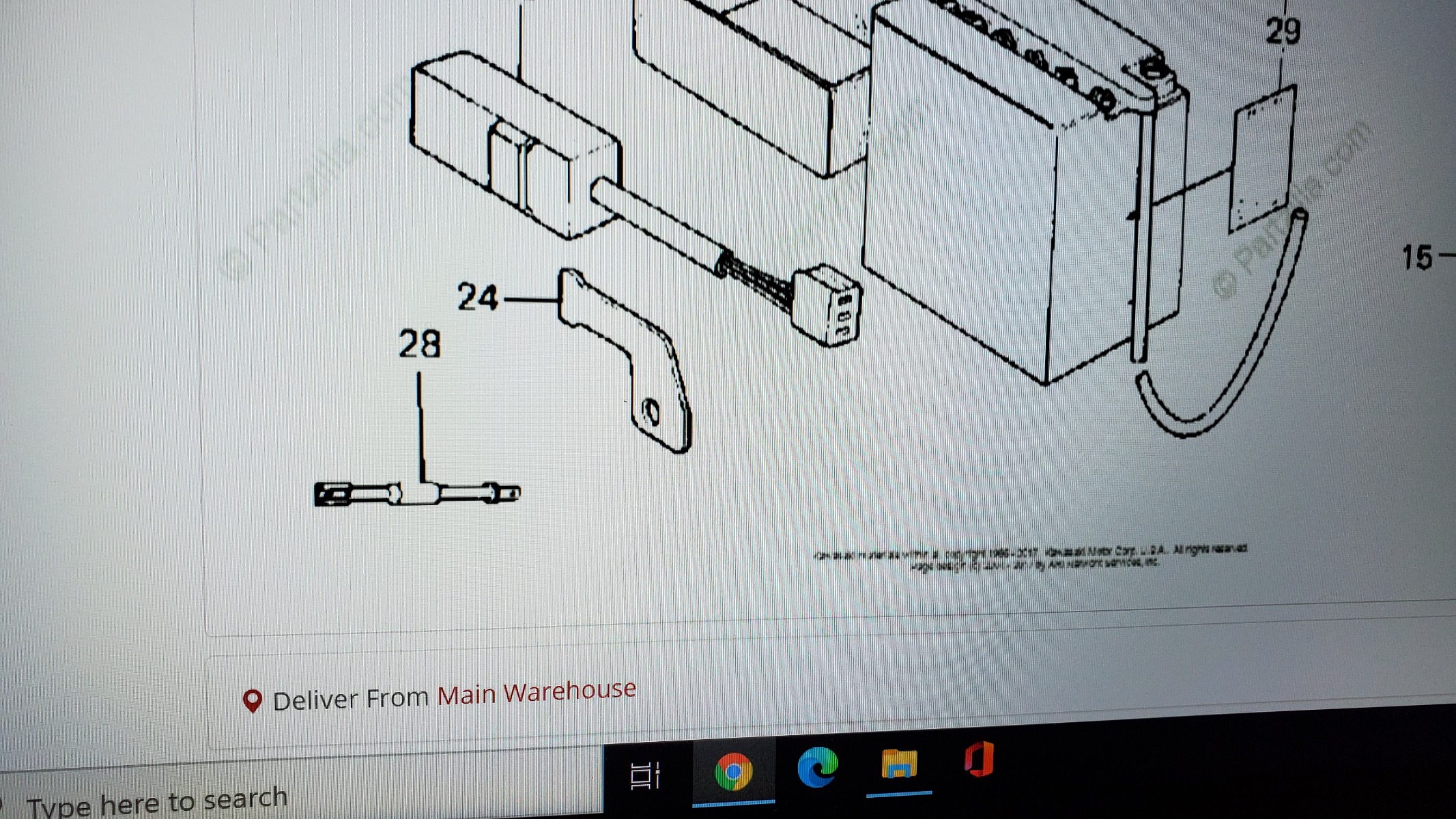

If I check Partzilla, it shows the voltage regulator as a very different looking part, part #28:
First, the regulator is likely the culprit here isn't it? Next, why does the Partzilla part look so different from the one on my bike and in the manual? To make matters worse, searching the Partzilla part number 21066-026 shows 2 types, the wire type like in the diagram and a very different looking beast:

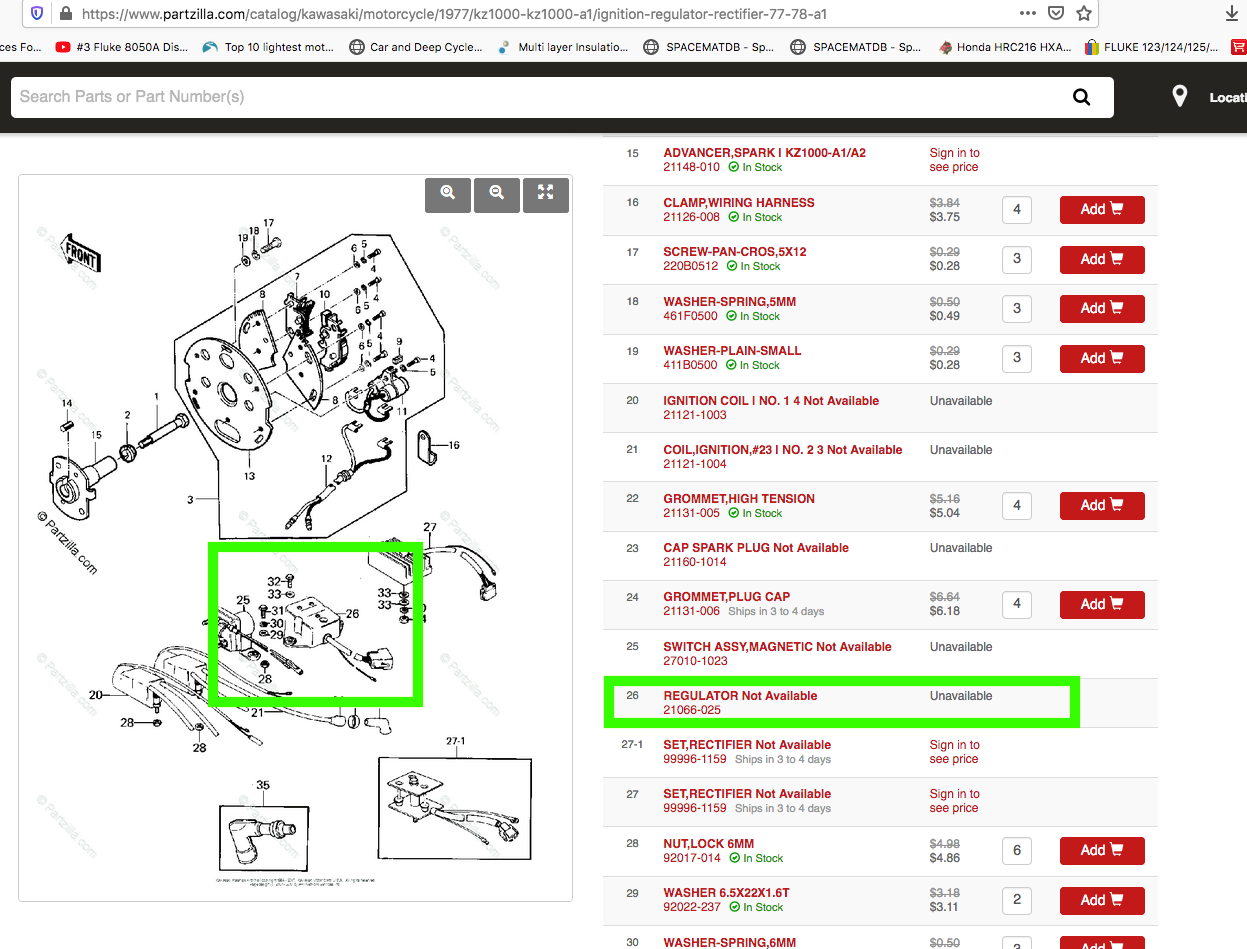

Your regulator is
21066-025 not 21066-026
I think 21066-026 may be a diode(it was discussed on this site in 2013)
www.kzrider.com/forum/4-electrical/59107...s-this-p-n-21066-026
www.partzilla.com/catalog/kawasaki/motor...r-rectifier-77-78-a1

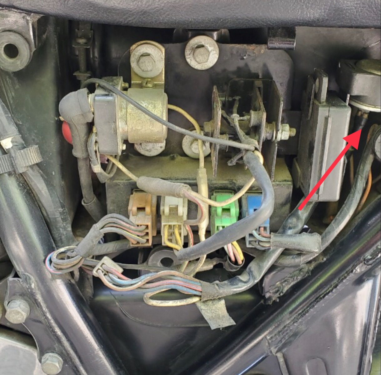

The photo F64 attached shows a rectifier in the lower right corner. Do you have one on your bike? It would attach directly to your electrical panel.

Regarding the part numbers & diagrams, there are two things going on. First, the 77 & 78 KZ1000A diagrams are combined, so two different voltage regulators are shown in the drawing: one for the 77 & the combo unit for the 78. Secondly, there's a part number error for #27 which is a reg/rec combo unit, not a rectifier. #27 is 21066-1008 & was used on the 78 model which has a different alternator rotor & stator. I don't know if the combo unit can be used on the 77. I'd guess yes, but that's just a guess without looking at a wiring diagram n stuff.
1978 KZ1000-A2 IGNITION/GENERATOR/REGULATOR
www.partzilla.com/catalog/kawasaki/motor...r-regulator-79-80-a3
ps: in the diagram F64 provided, in addition to the voltage regulator, your motorcycle also has the rectifier #27-1. The reg-rec combo unit replaces those two parts. That EB part appears to be a reg-rec, so it also replaces the rectifier, not just the voltage regulator.

Item 28 is a diode. I’m not good with electric stuff but it is in series with the hazards four way blinker. I have it on my ‘76 900’s and on my ‘78 1000B2

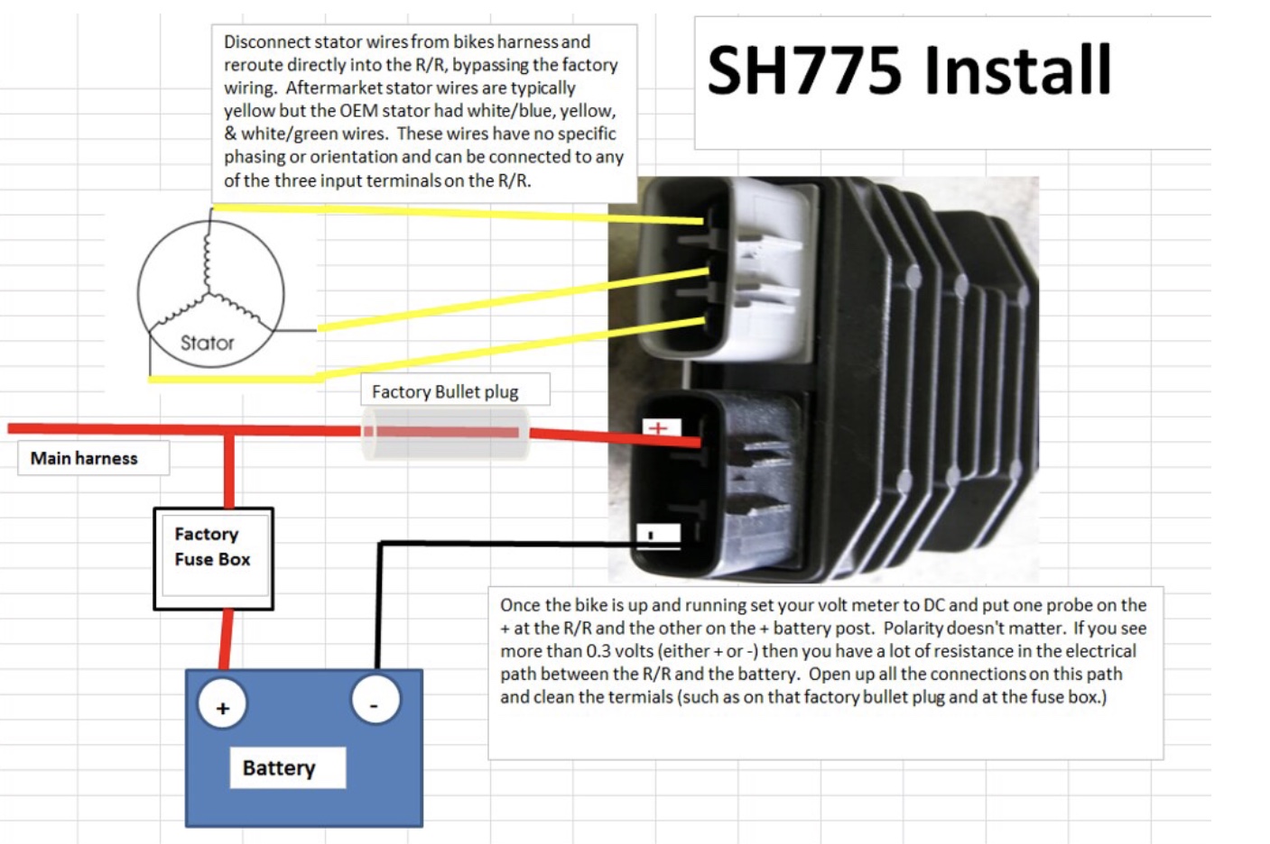

man 17v is way high should be more in the 14v range. Time for a Nessism SH 775 upgrade.

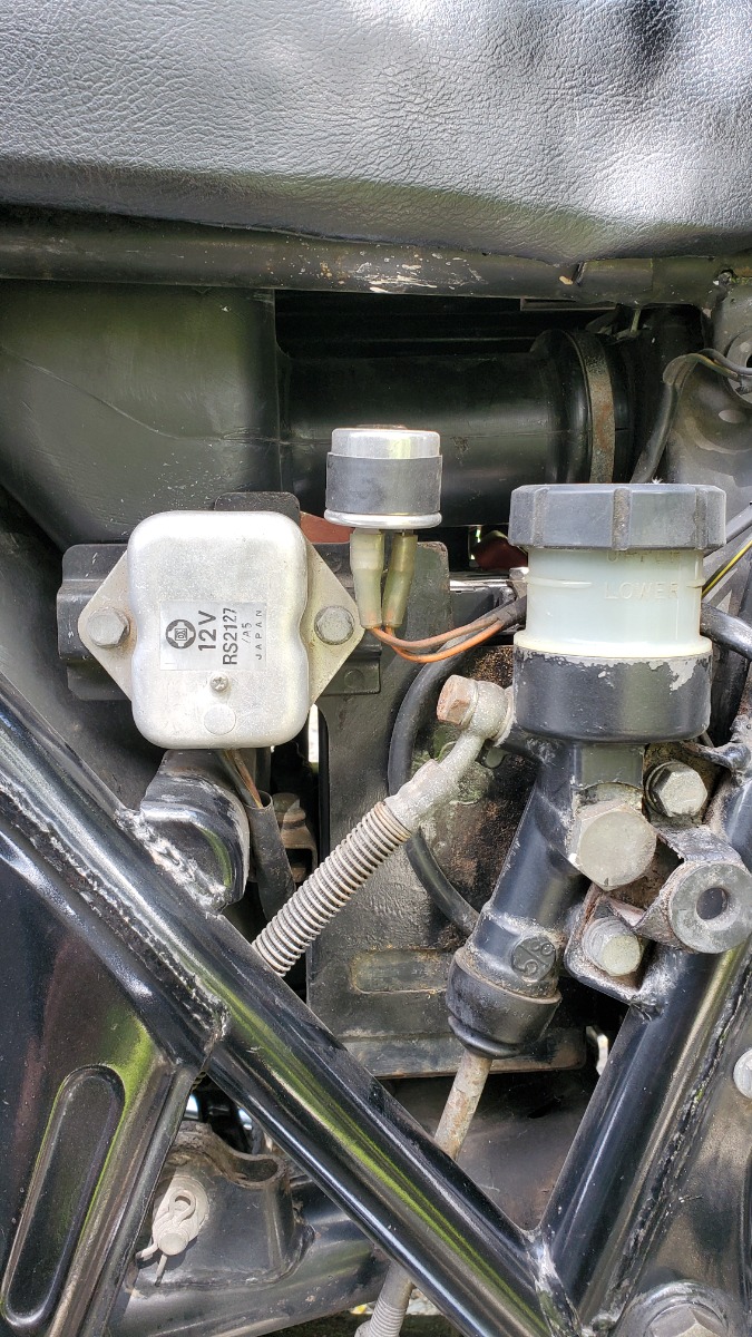

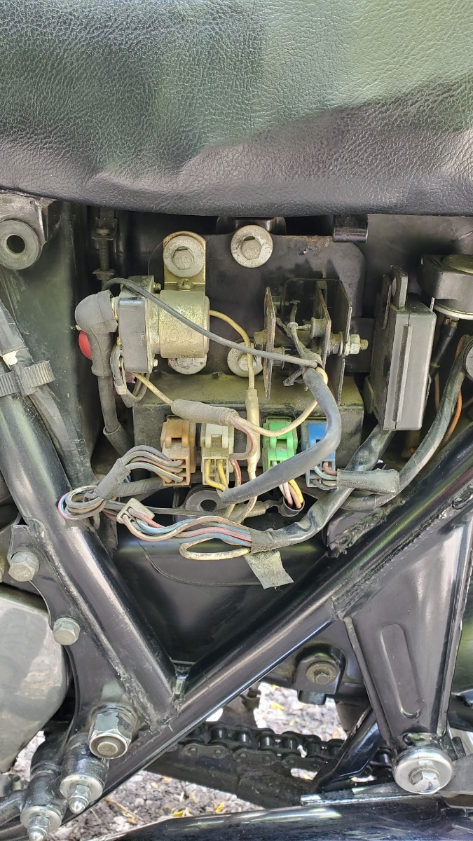

Thanks HRM, but you're right, the leads are much longer on the one on mine. I have the 2 part system:
Left side
Right side
When I get a chance in the next couple of days I'll pull the regulator and do the out of circuit test described in the manual:

Re: 77 KZ1000A1 Voltage Regulator
02 Jun 2021 10:49
I removed the regulator today and ran the out of circuit test. + to Black Lead, - to Brown Lead gave 1340 ohms, + to Brown Lead, - to Black Lead also gave 1340 ohms, rather than the 300 ohms called for. The other combinations of leads all showed 0 ohms, so I suppose I need a new regulator. I haven't been able to source a used one yet, but seeing as the NOS ones I've found range from USD$250 to $475 plus shipping, I'll keep an eye out for a used one to show up on eBay. I'd really rather go the OEM route rather than getting an aftermarket combo unit, if possible.

If you don't care about keeping the bike original you can get a state of the art SH775 combination R/R for about $60 + $10 for a harness. Vastly superior to the original separate regulator and rectifier and much cheaper.
