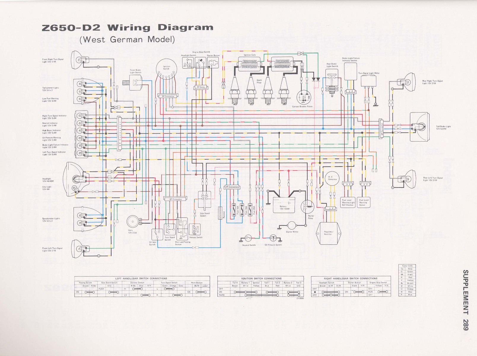

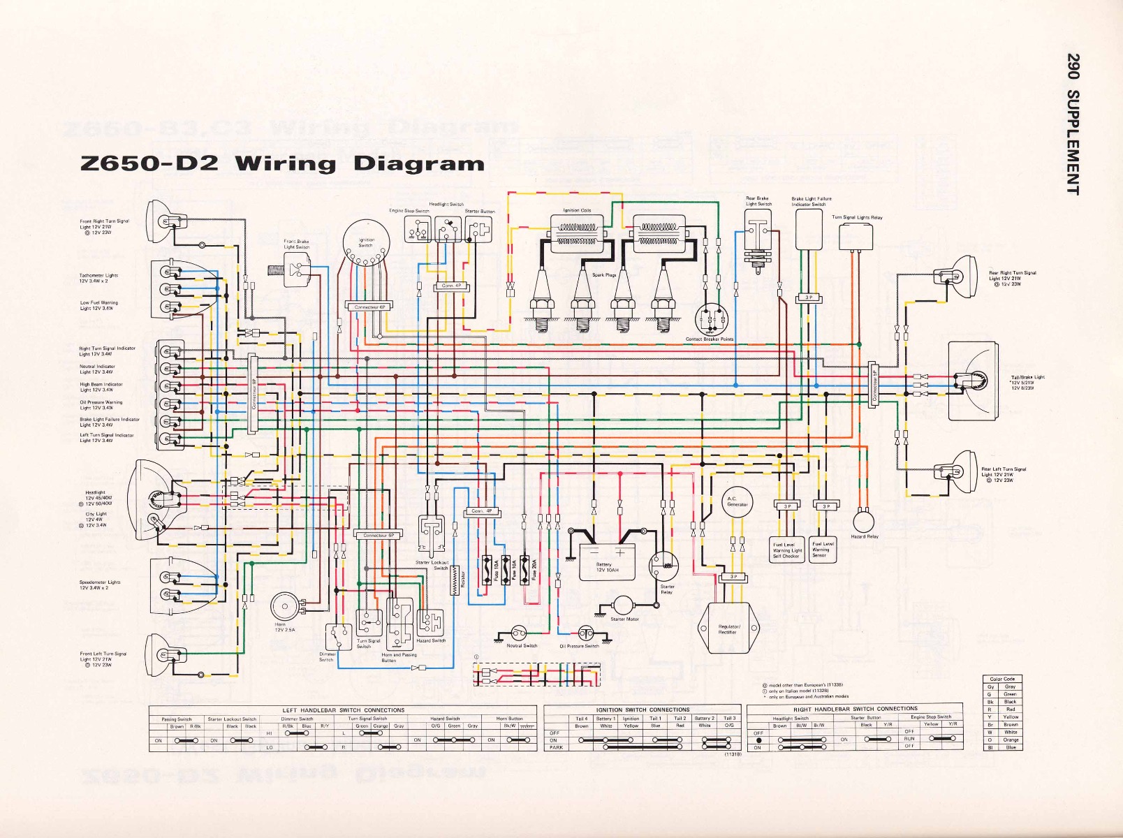

It is my understanding the pass light function was used on bikes sold in other than the North American market. So I assume you have one intended for other markets. There are some differences between the wiring depending upon just which market.
Not sure if this will help any but have attached a non North American wiring diagram for the D2 (sorry do not have one for the D1 other than North American) Please note that there are some differences between the D1 and D2, but it does show the pass light feature.
