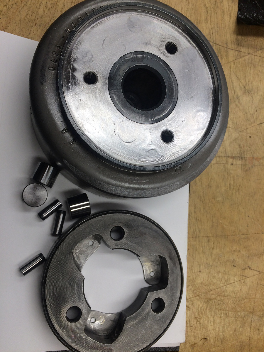

How do you remove the starter clutch from the flywheel? The bolt heads are covered on mine. Is it installed upside down?

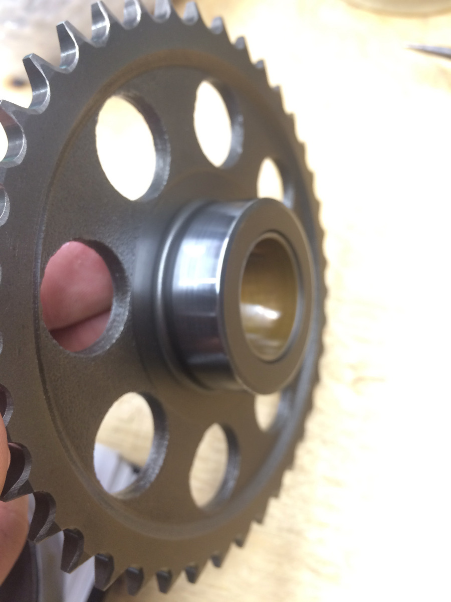

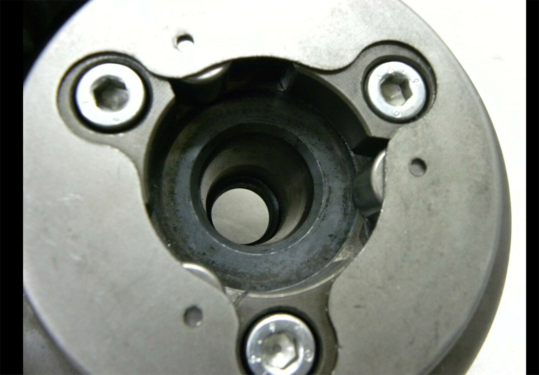

Well I think you may have found your problem right there. That top cover has spun. the rollers are supposed to be completely covered and the bolt heads exposed. the rollers could be racking and getting jammed up because of that. it should look like this. IIRC this sheet metal piece is formed over a plate and its supposed to be one unit. If it spun you will need to weld it or something to keep it in place, or get a new clutch. what does the sprag gear surface look like?

DoctoRot wrote: Well I think you may have found your problem right there. That top cover has spun. the rollers are supposed to be completely covered and the bolt heads exposed. the rollers could be racking and getting jammed up because of that. it should look like this. IIRC this sheet metal piece is formed over a plate and its supposed to be one unit. If it spun you will need to weld it or something to keep it in place, or get a new clutch. what does the sprag gear surface look like?
The sprag surface has some nice grooves. May need to have it machined or replaced. I did get the sprag off today. We had to really mess up the cover to get to the bolts. I will make it a kicker until I find a sprag.

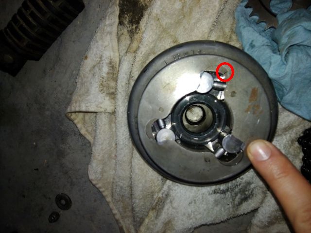

Your starter clutch looks like to have a crack in the roller ramp....
