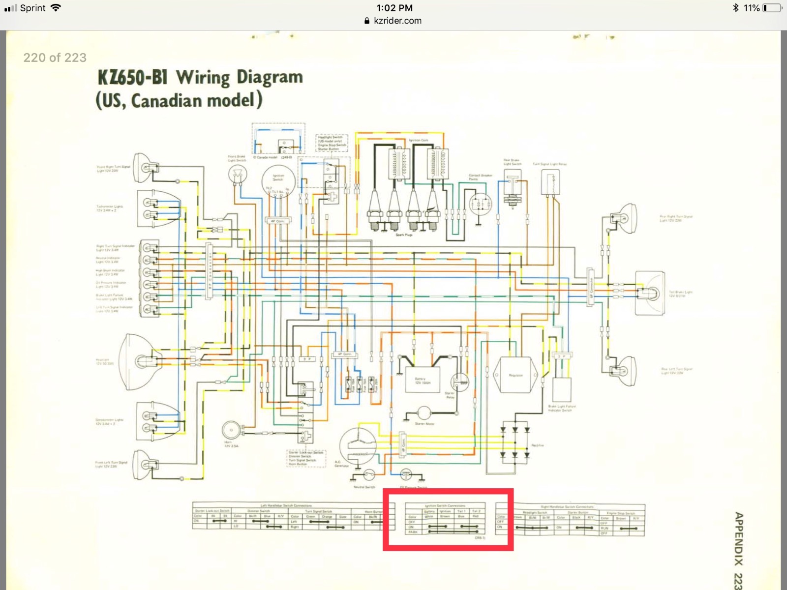

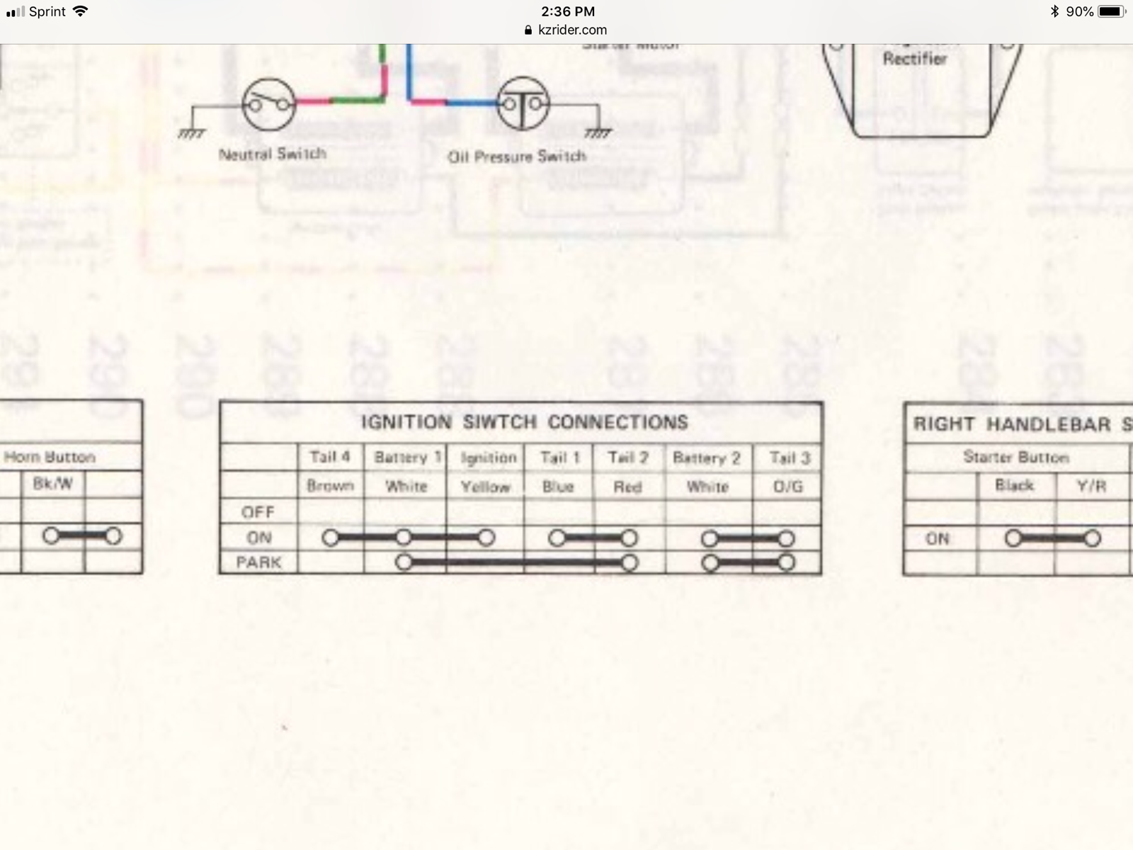

You need to find a wiring diagram that includes a connection Schematic like the one shown in the red box of photo included. It will help you make your swap. Sorry I can’t locate one. Hopefully martin_crs or 650ed will see this. They are very good with you bike.

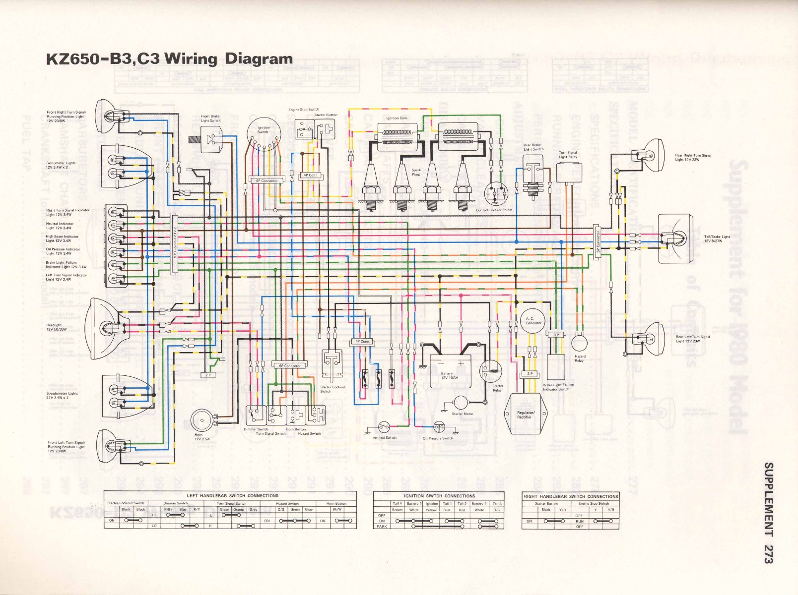

Here is a wiring diagram for the B3 C3 models. I have also included a text doc of the keyed switch with the number of wires on each and part#s.
