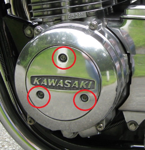

Based on the numbers you may have a 1977 KZ650-B1. Here are some things unique to the 1977 models; if your bike is configured this way it is probably a B1 since it is doubtful someone would have changed all these items:

B1 has 3-phase excited field generator – this will have the 3 allen screws circled in red – B2 does not have those screws

Thank you both for the responses. It makes sense that it is a B1 - somebody on this forum led me to think it was a B2 some time back, but that's irrelelvant.
I believe the bike in question is a hybrid I've read about somewhere at some point, a mix of B1 and B2. It has the brake caliper behind the leg, but the round master. The fork legs like your C1, Ed, as is the charging system. No hazard switch. Manual petcock. Solid front peg mounts. Plain swing arm bearings. Capital KAWASAKI letters on the cases. But an automatic cam chain adjuster.
