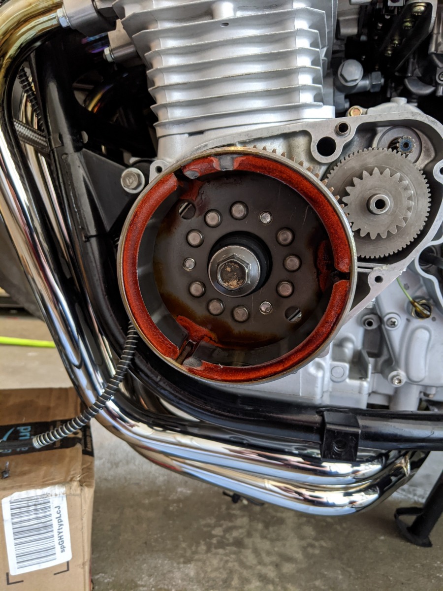

Got all the parts. Doing the regulator first. Pulled carbs, air box and chain guard to access. I guess the plan is installing with one bolt since the original holes don't line up. The OEM wires from the regulator butted right up against the chain guard. So there's no way the new one with connectors will fit in that direction. So I'm gonna reverse it, and remove the unused OEM igniter to provide additional room. This job would be much easier with the swingarm removed and the bike upside down. :whistle:

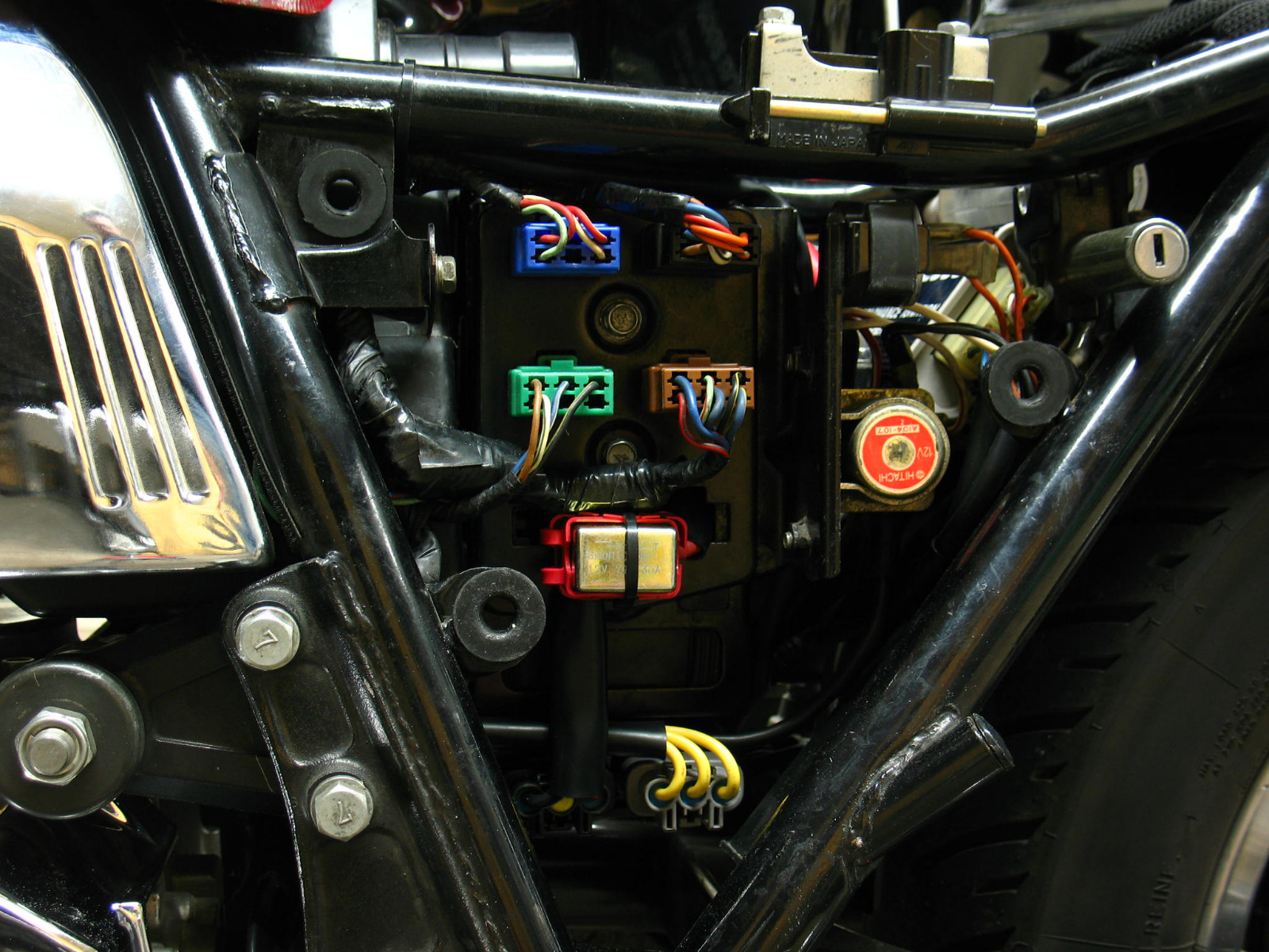

Jack Flemming roadstercycle.com provided the wiring and connectors for the regulator upgrade on my bike. I haven't touched it since an SH775 regulator was installed in 2015, along with a new Kawasaki stator for it's Genuine OEM quality, and heavier gauge wire than aftermarket.

Good pic. You can see why I had to reverse it. On mine the chain guard is where your connectors sit.

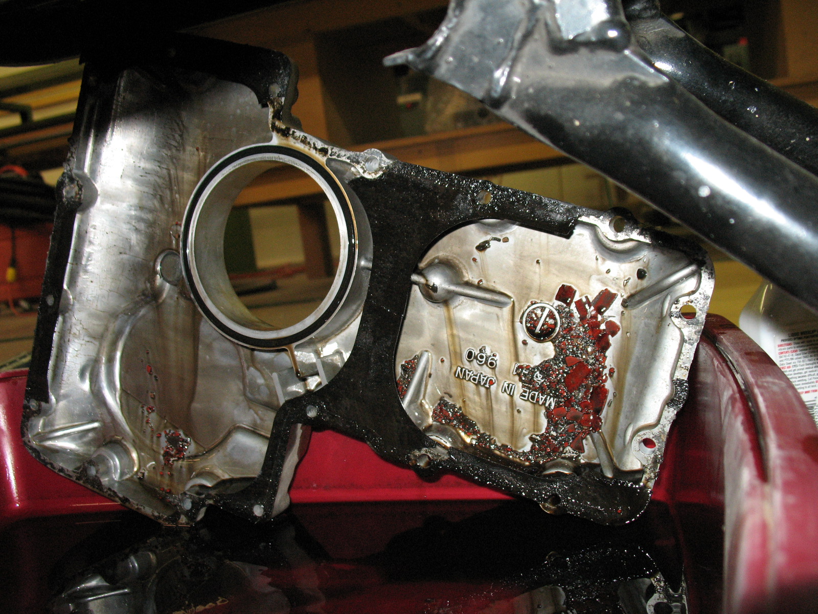

If the magnets are not chipped or cracked you may be ok. From my experience with that issue, the missing stuff has migrated to the bottom of the oil pan.
