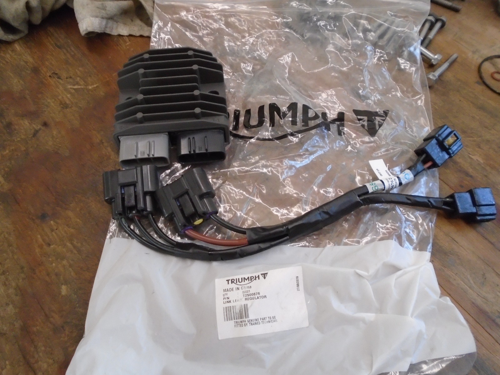

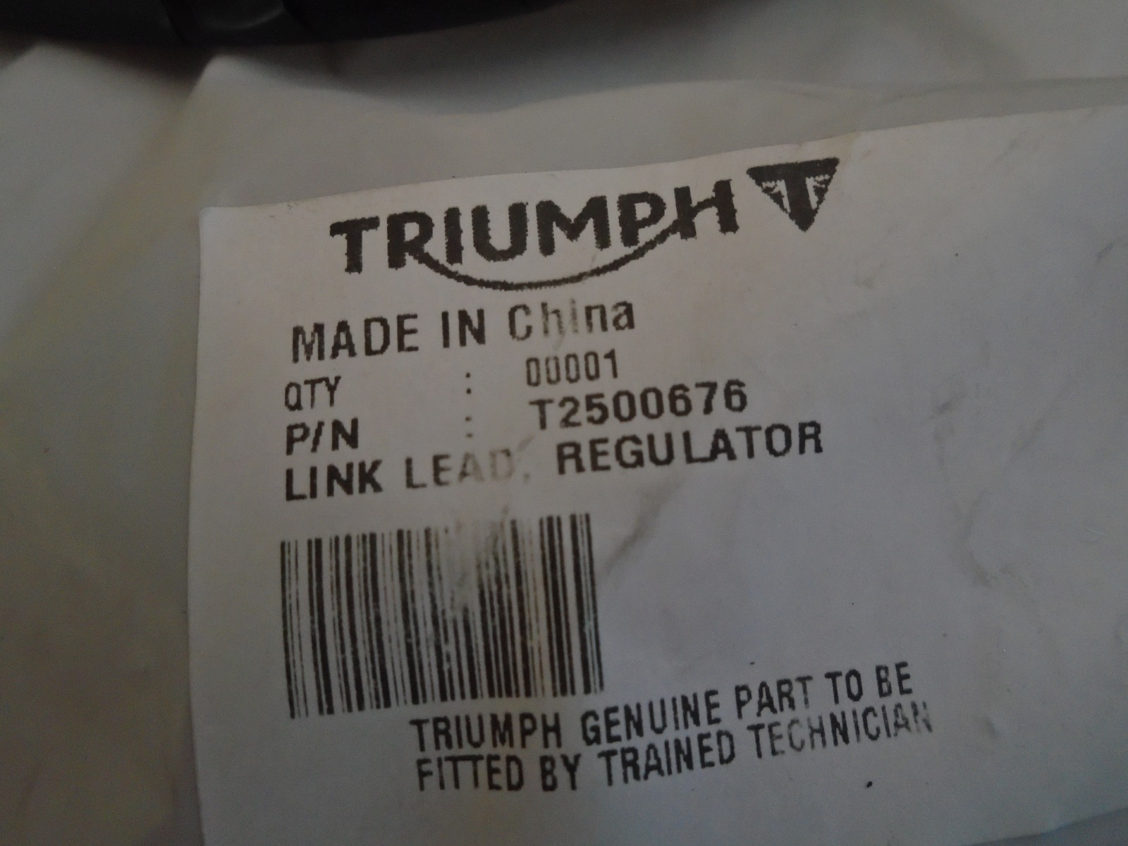

SH775 and a Rick's stator is my preference. Triumph PN T2500676 is a nice adapter harness for the R/R.

Triumph harness though local dealer or online.

So with the regulator and adapter harness, will these all be weatherproof connectors? And any additional re-wiring required? Thanks for your help Nessism.

The only way to know the extent of the rotor magnet disintegration is to pull the stator cover and look. It's rare that it would fail but I'm not going to tell you they can't.
And yes, with that Triumph harness the attachment will be waterproof.

Plug and play with the adapter harness. I don't have to change anything?
