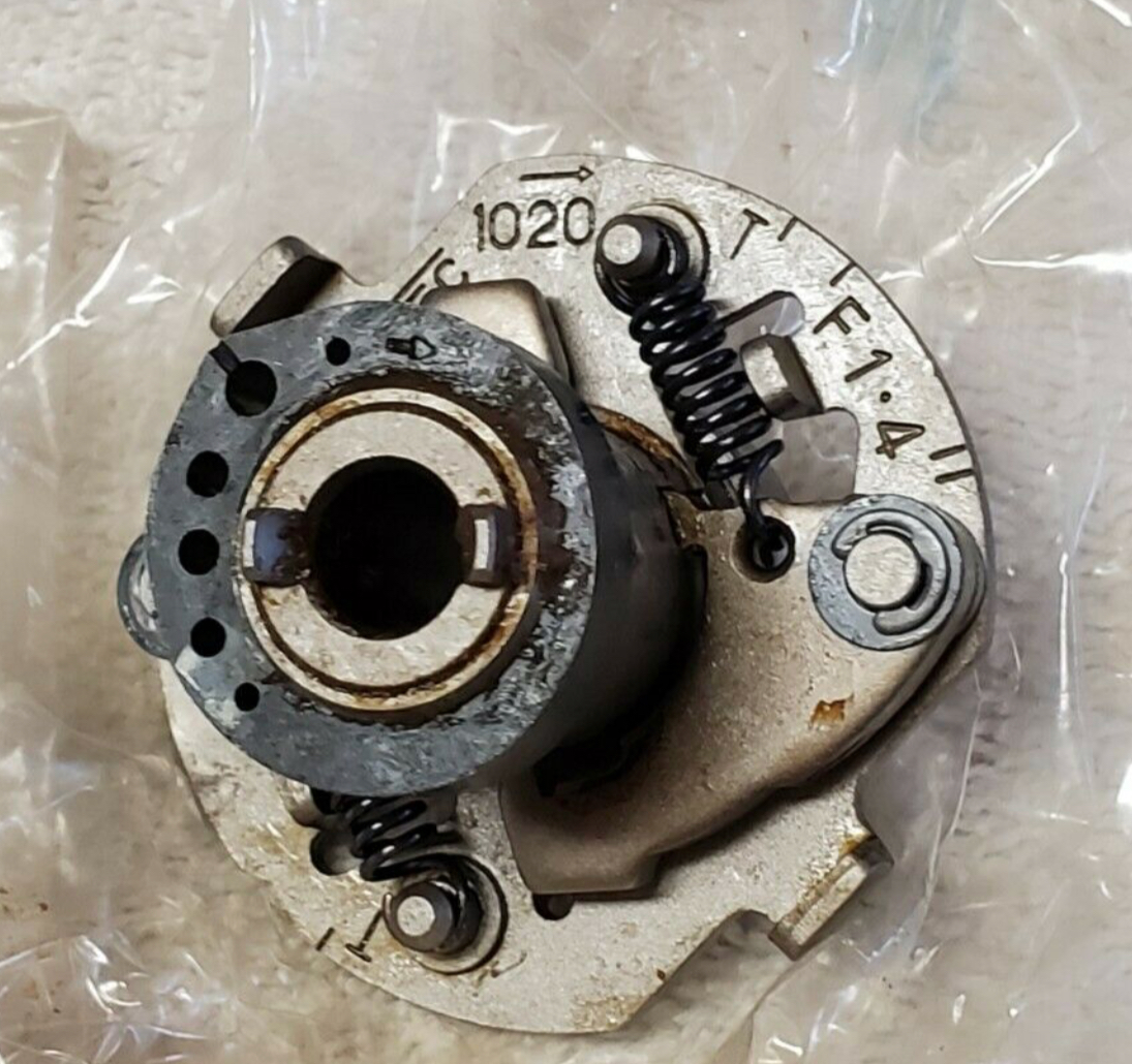

It say "Tek 1020". Is there some recommended method of measuring and scribing the 2/3 adv marks ? Also, so am I supposed to use the right line "II" mark. for static timing the 1/4 adv. ?? Thanks in adv. Gary

Does your advancer look like this with the II marks between 1-4 and 2-3 .
If it does the one to the left is TDC and the one to the right is the static timing mark.
Full advance is further to the right next to the pivot pin of the advancer weight.

No sir, it doesn't look like that one. It has: " T - F' II 1-4" on one side. Then only a "T" for 2/3

Here
Use either advanced mark. It’s just to get close enough to start the bike. Then dynamic time with a light.
