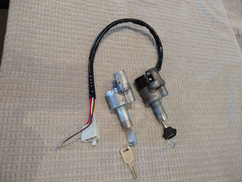

I know this is old, but some problems never get old! I´m searching for a Vulcan 750 ignition switch, but that model was not very popular in Spain, so all I´ve found for the moment is a Vulcan 500 switch. Looks very similar to the 750, but only has 5 contacts in the connector. Please see attached pix. Can someone tell me if this could work?

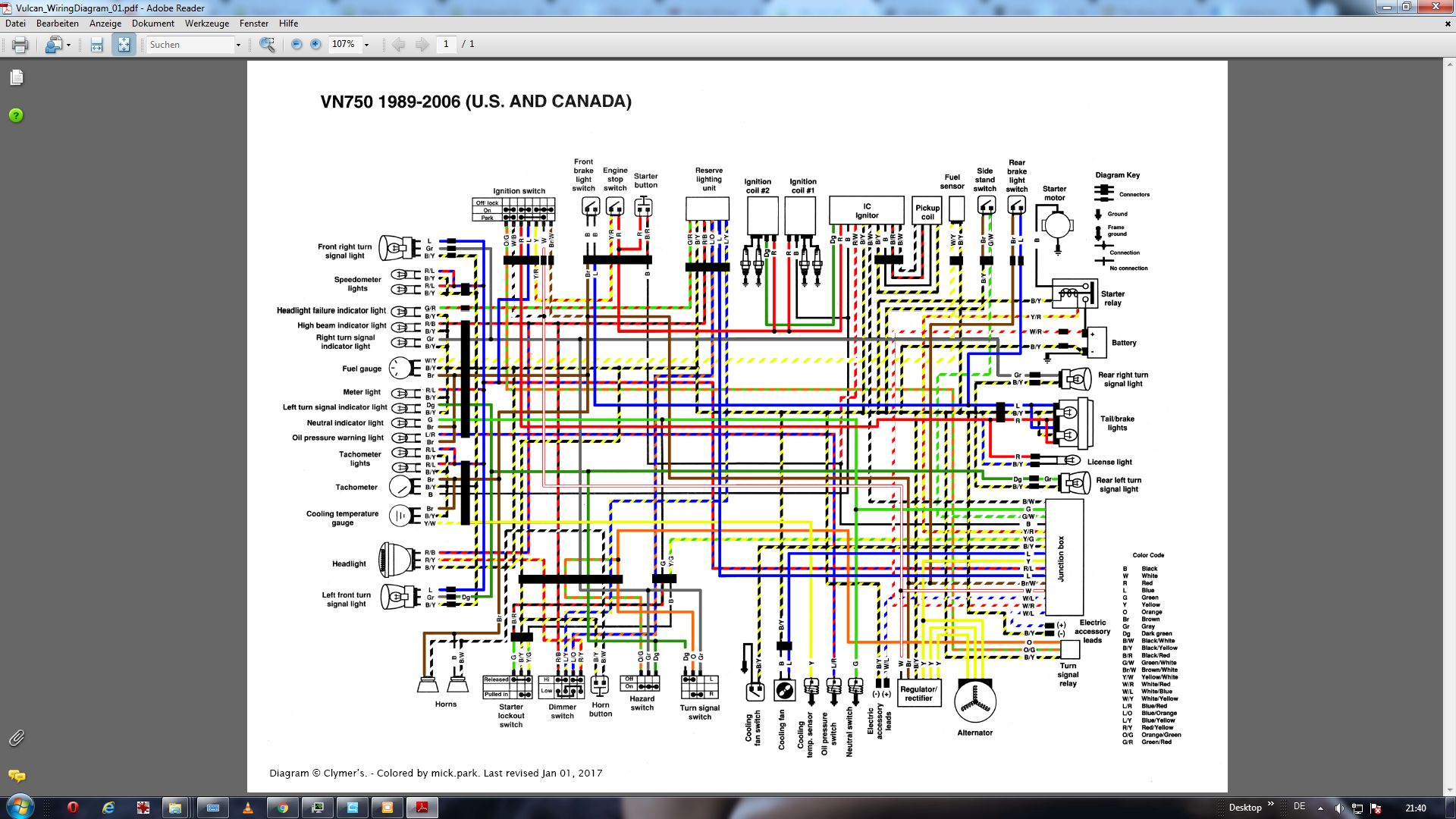

If you can find me a wiring diagram for the Vulcan I will be able to tell you if you can use it

This should help!
kzrider.com/forum/4-electrical/617798-19...h-diagnostics#869885
PDF: drive.google.com/file/d/0B23DfMXHXUWiS1J...XDtaXY2E1ayrsyvvFjug

Thanks Scirocco, do you know if this is the same as the Vulcan 500 he has the switch from ?

Found it. Let me know if this bit is enough. You can see the 5 pin switch connector in the top left. Also the connector pic.
