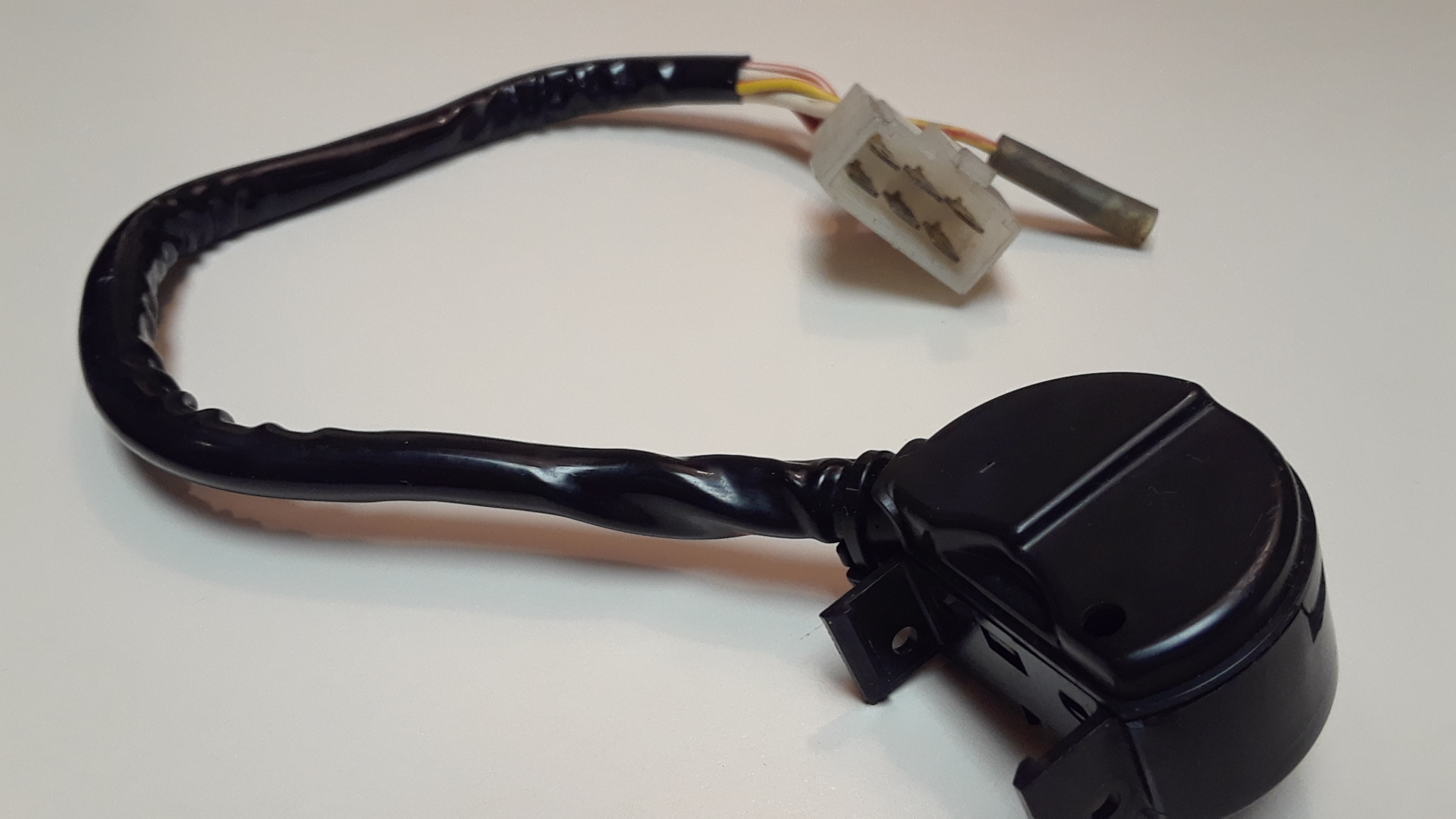

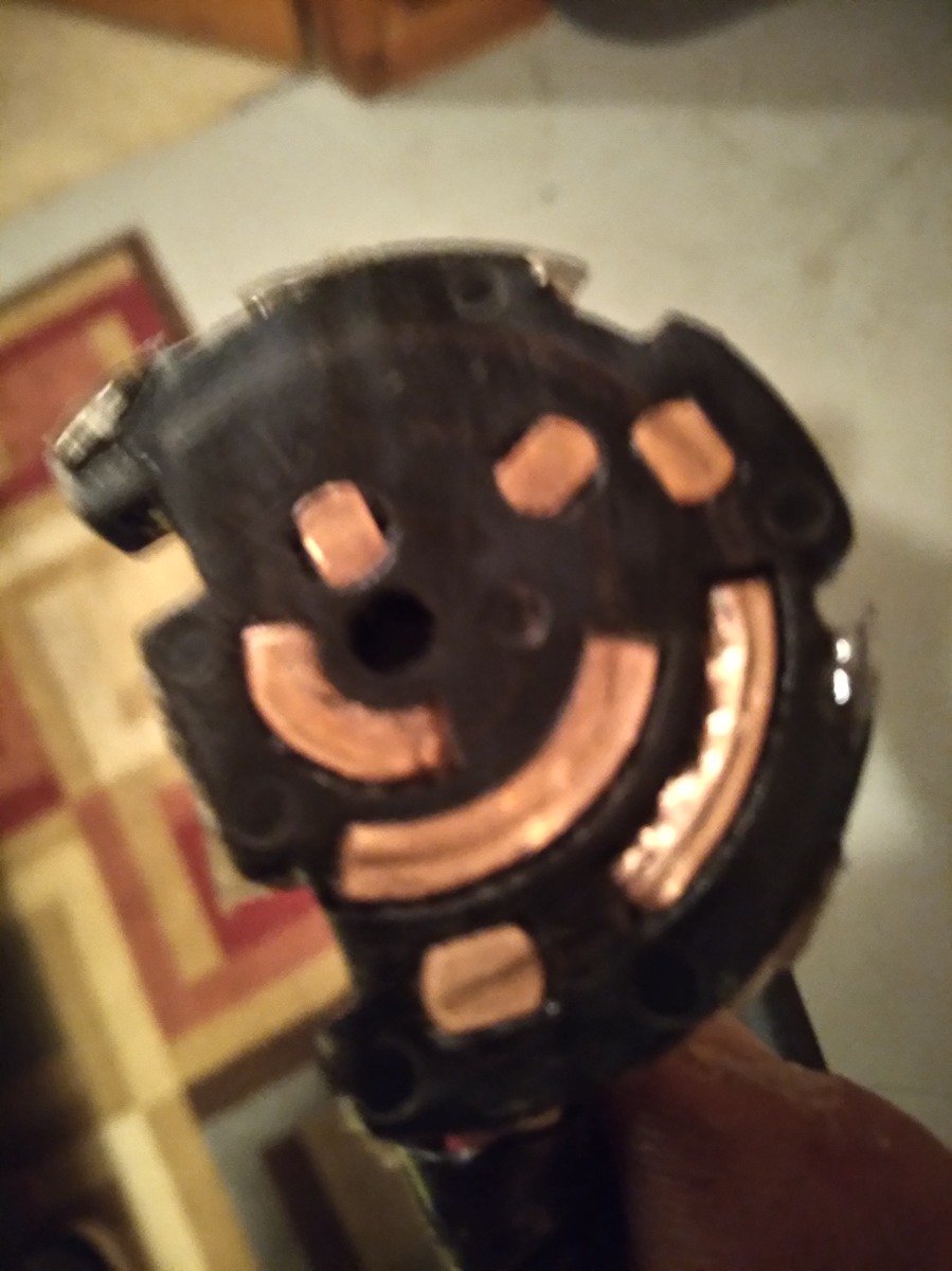

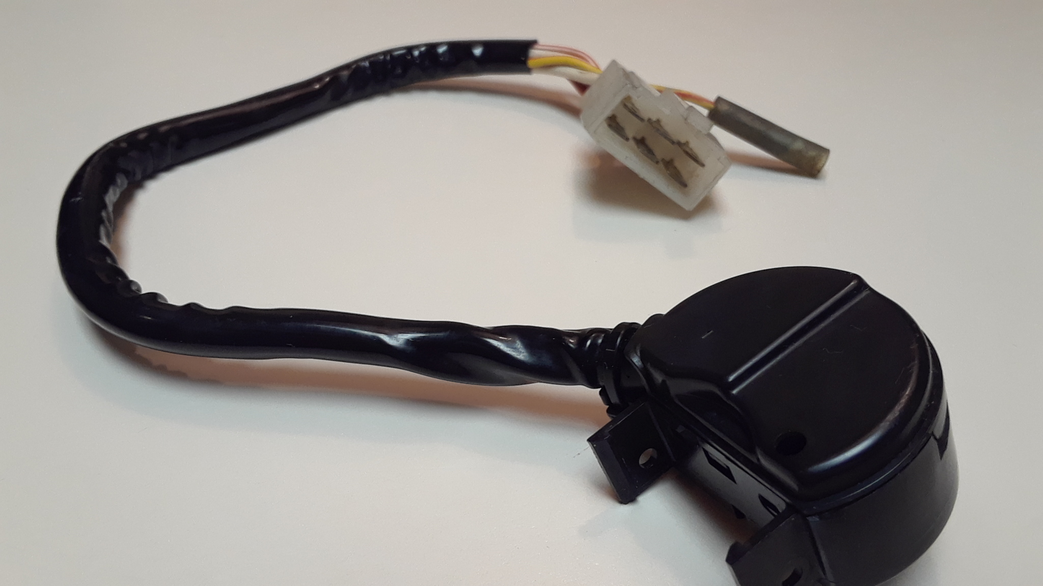

o/w + o
6.2 ohms
br + r/yel
.8 ohm
o + o/w
.5 ohm
w + w/bk
.9 ohm
'park'
w + w/bk + red
no contact all three together
general consensus is the switch is toast, needs replaced.

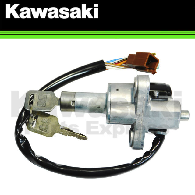

hoped for correct steering lock that protrudes out of the bottom
but all i can find is emgo ignition switch kawasaki 40-80610 but steering lock protrudes from the side
is that the only switch available? ty

are you putting your probes on the wires of the switch or are you probing the solder points on the switch?

daveo yes that's absolutely what i need is just that portion available anywhere?
f64 im using the solder points and back probing the connector with switch completely removed from bike

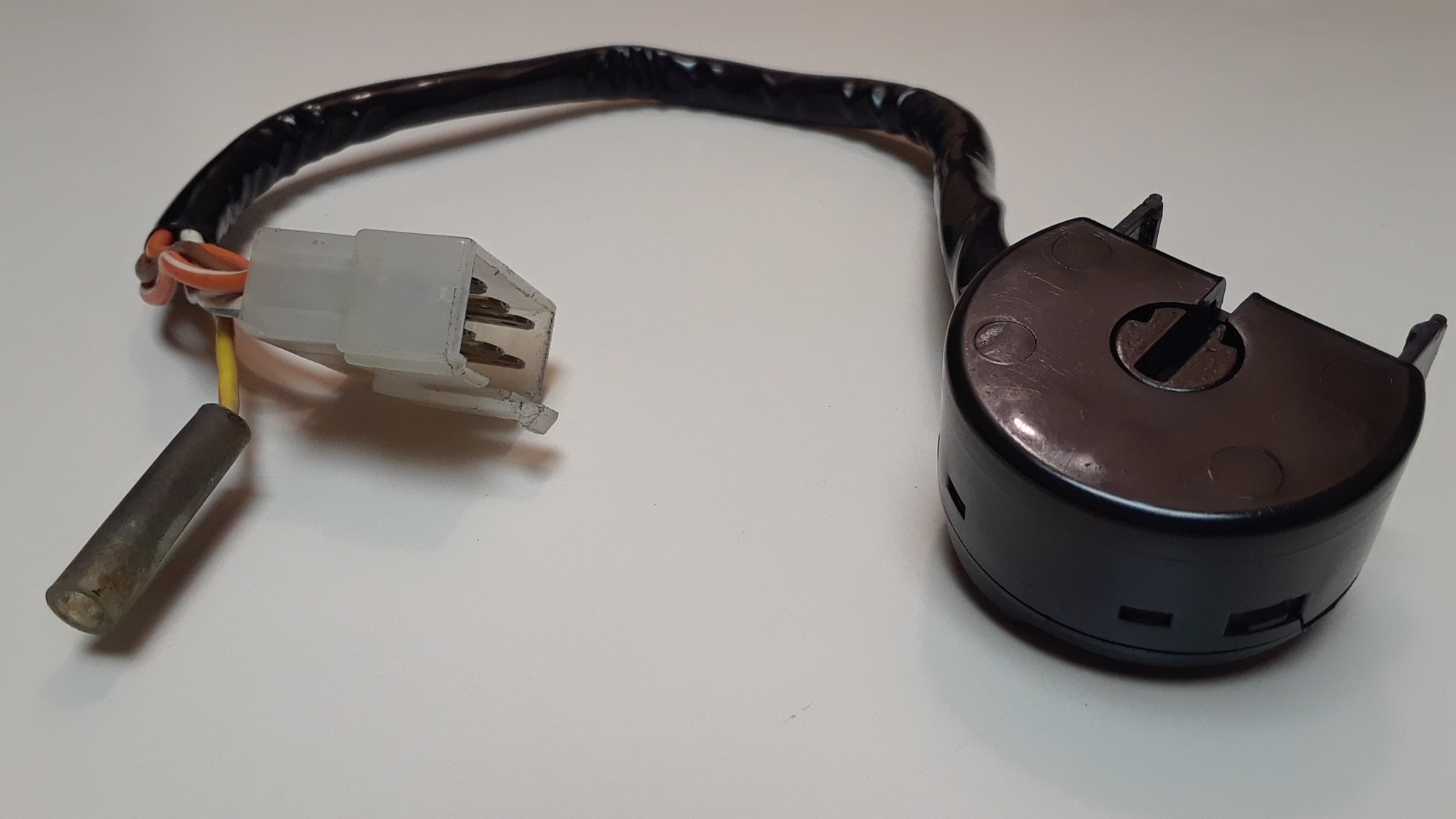

04 Jul 2022 21:39Someone else may know of a source, but not that I know of.daveo yes that's absolutely what i need is just that portion available anywhere?
It was removed from a switch listed several years ago on ebay. There's not much available to choose from now, but that can change in a day.

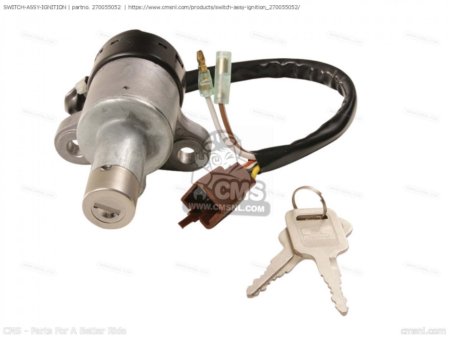

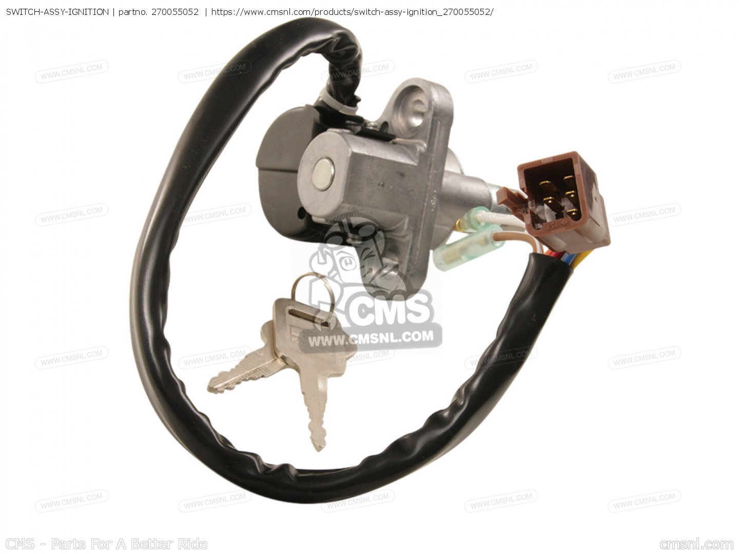

Kawasaki Vulcan 750 1986-2006 Ignition Switch 27005-5052
Looks close to yours, only the connector is differing. De-solder and re-solder your connector or use the internal parts only.

scirocco absolutely a great idea. was looking on ebay the other night and seen an incredible resemblance between the two. i will look further into it.
