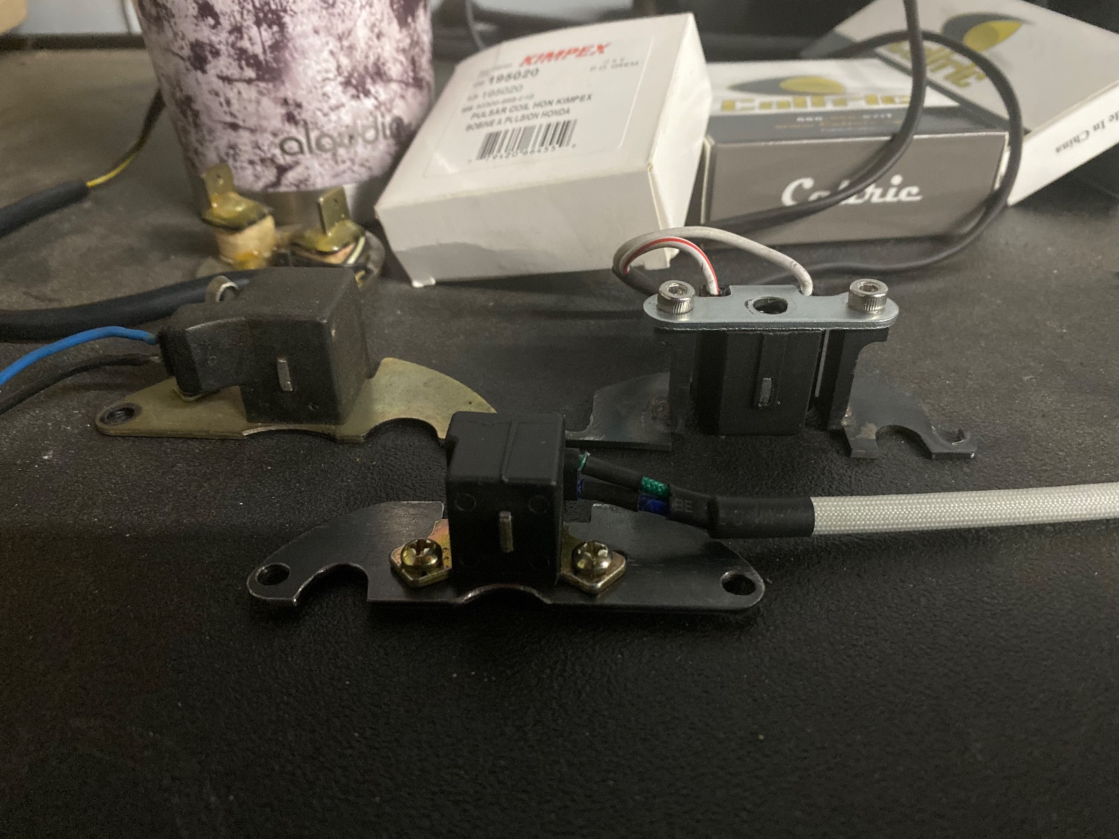

Ooooohhhh!!..soooo much anger with mobile phone networks right now...Seriously been trying to post an update for you guys the past week, aside from getting interrupted mid way through typing out my post, my convincing pal “sidetracked” steps in. That tends to happen to me a lot more now the past 5years. Oh yeah, see! Side tracked?! when I finished typing out my reply to the topic, kinda lengthy with pics, hit submit,,,,,,,,,,,,,,,,,,,,,,,,,,,,,,,,,,,,,,,,,,,,,,,,,,,,,,,,,,,,,,,,,,,,,,,then error message saying network not responding!!? and my post is lost...FFS!!! isn’t the first time either. Ok sorry, had to let that out..
Still haven’t gotten to really test ride my bike yet other than a 2 mile ride up the down the street. No problems, bike ran smooth, even noticed that it seems to start a lot easier. Hopefully in the next couple days, I’ll sneak away from the shop before the sun goes down and ride my bike home.
So as of right now, the working PU is the same as the Mopar one you posted Lou. It’s far from simply bolting in, but we all knew this from the start. Had to fab up a whole new mounting plate and another attachment plate for the PU to have it mounted correctly. I didnt take any pics of that...yet. This Mopar one Ohm’d to 316.
And then there’s these...
Stock one on the left. ATV “big red” (Ohm’d to 39) in the middle. Yup the middle plate is backwards, just noticed.
Polaris Sportsman 400 (Ohm’d to 138) on the right. You can see how the Polaris one needed to be mounted just for testing sake.
I swear to took a pic of the mopar pu mounted by the rotor, but my phone says otherwise? I’ll get a pic of that and how it needed to be modified to mount correctly.

Thanks for the update. I havent been on much lately myself... Too much work...too little time.
Those plates look good. How are you fabbing those? Waterjet, laser, cnc, cutout by hand?
Glad to hear its working so far.
