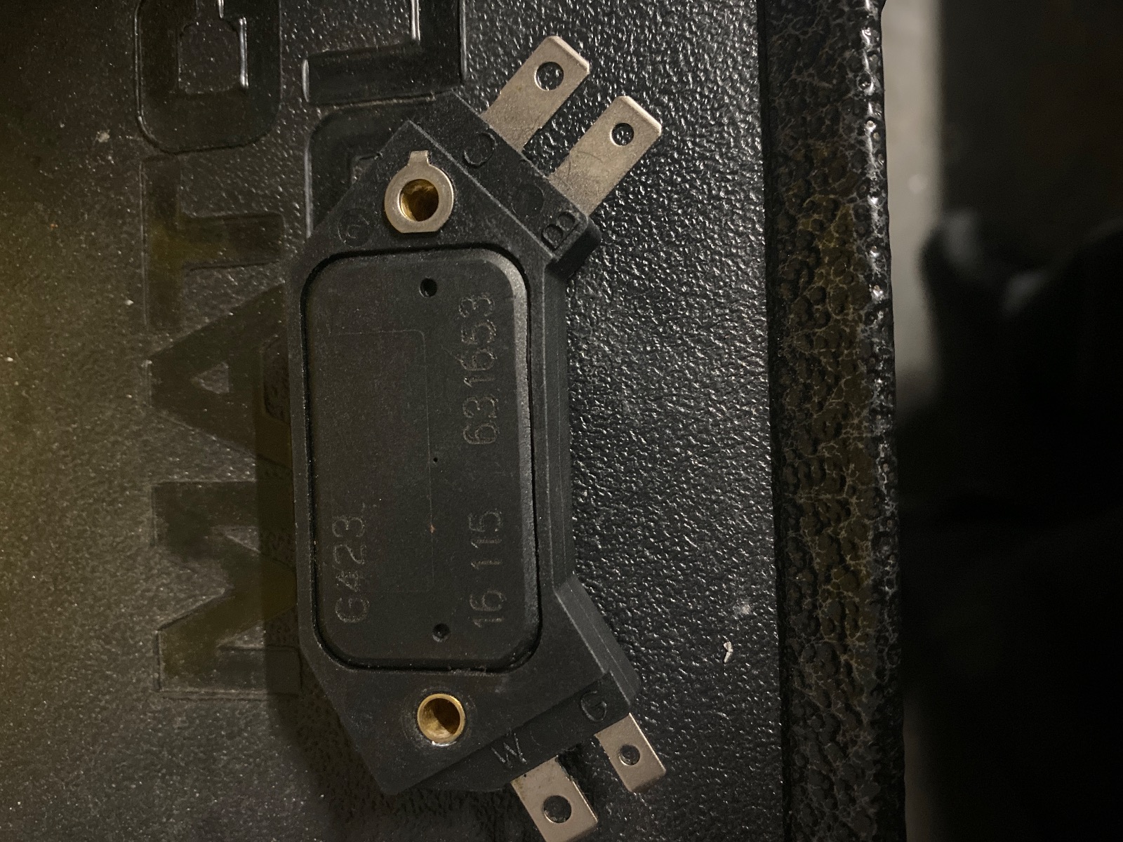

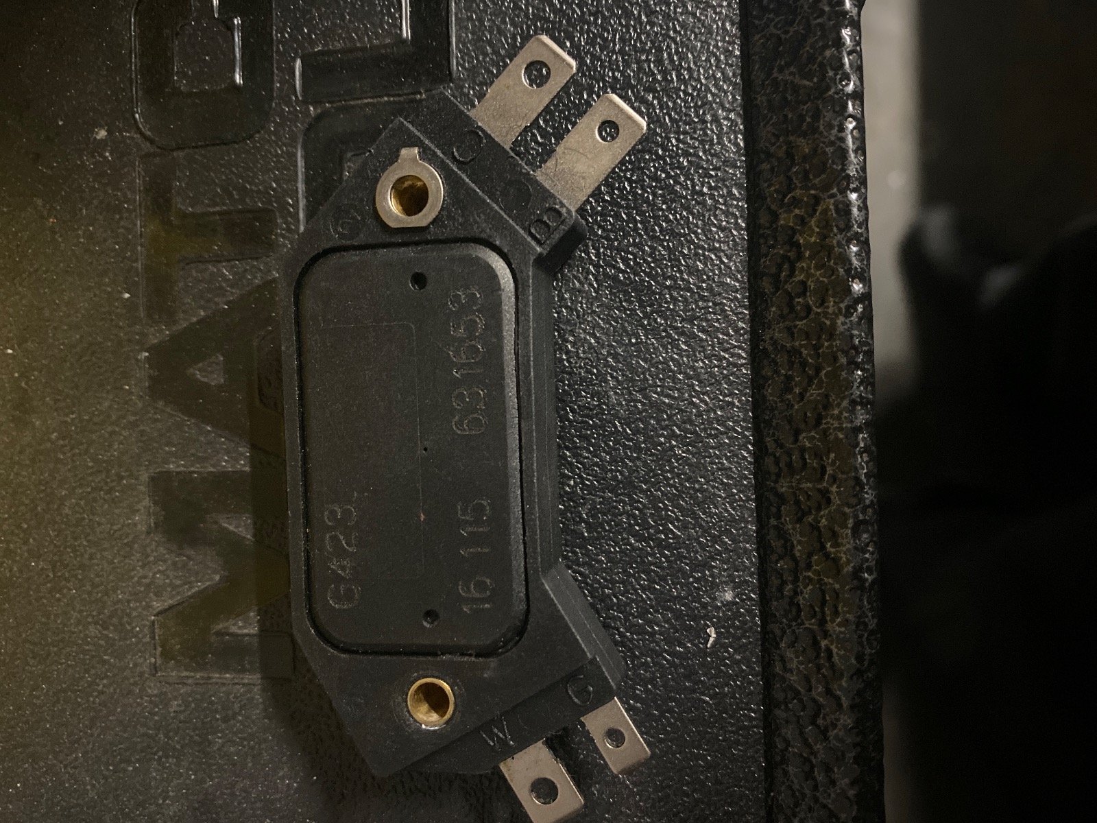

Alright, mopar pu should be here today at some point. I also acquired a 4p hei unit from a “Domesticated” buddy of mine. haha. Loudhvx, I haven’t completely read enough to understand the procedure to incorporate the HEI into a twin. My first assumption is that I’ll be removing the stock ig module and wire the HEI in its place? But rather than guessing, I’ll go back and find the write up you did on it. Now one thing my buddy mentioned is that it’ll be ideal to mount a heat sink of some sort onto the metal side of the hei. If that’s the case then awesome, I’ll finally get to use the small end mill bits I’ve had for the past year. I even have some artic silver t. paste.

The way it's designed to work with the Kz, it doesn't need much heat sink. It probably doesn't need heat past. I just mount it to an aluminum plate. It barely gets warm.
The problem is getting the correct type of 4-pin module. They are getting harder to find. The page below has a link to how to tell which type you have.
Scroll down for the twins version is near the bottom of this page.
s3.amazonaws.com/gpzweb/Ignition/GPZgmHEImod.html
I'll have to test the polarity of the dodge pickups I have to know which wire goes where. The test I did earlier was with using the Kz magnets. The polarity could be different when using the Dodge magnet assembly. I'll try to do that later today.

01 Jul 2020 20:47loudhvx wrote: The way it's designed to work with the Kz, it doesn't need much heat sink. It probably doesn't need heat past. I just mount it to an aluminum plate. It barely gets warm.
Lmao..Man I can see how some people may have given up quickly after starting their hunt for an easy replacement. There is so many variables, decisions on what to utilize or replace, ease of replacing..etc etc.
I’m gonna have to do the ohm/voltage test on the hei I have. The numbers that are engraved don’t match any you have listed in your identification write up.
