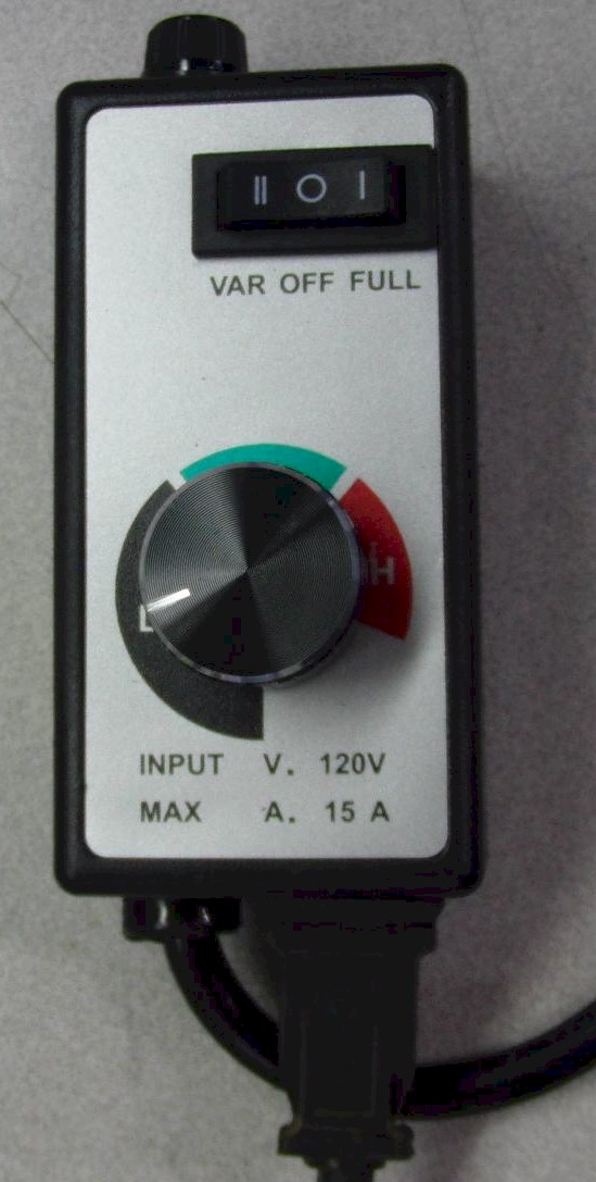

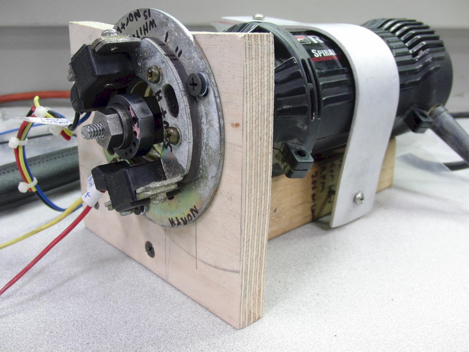

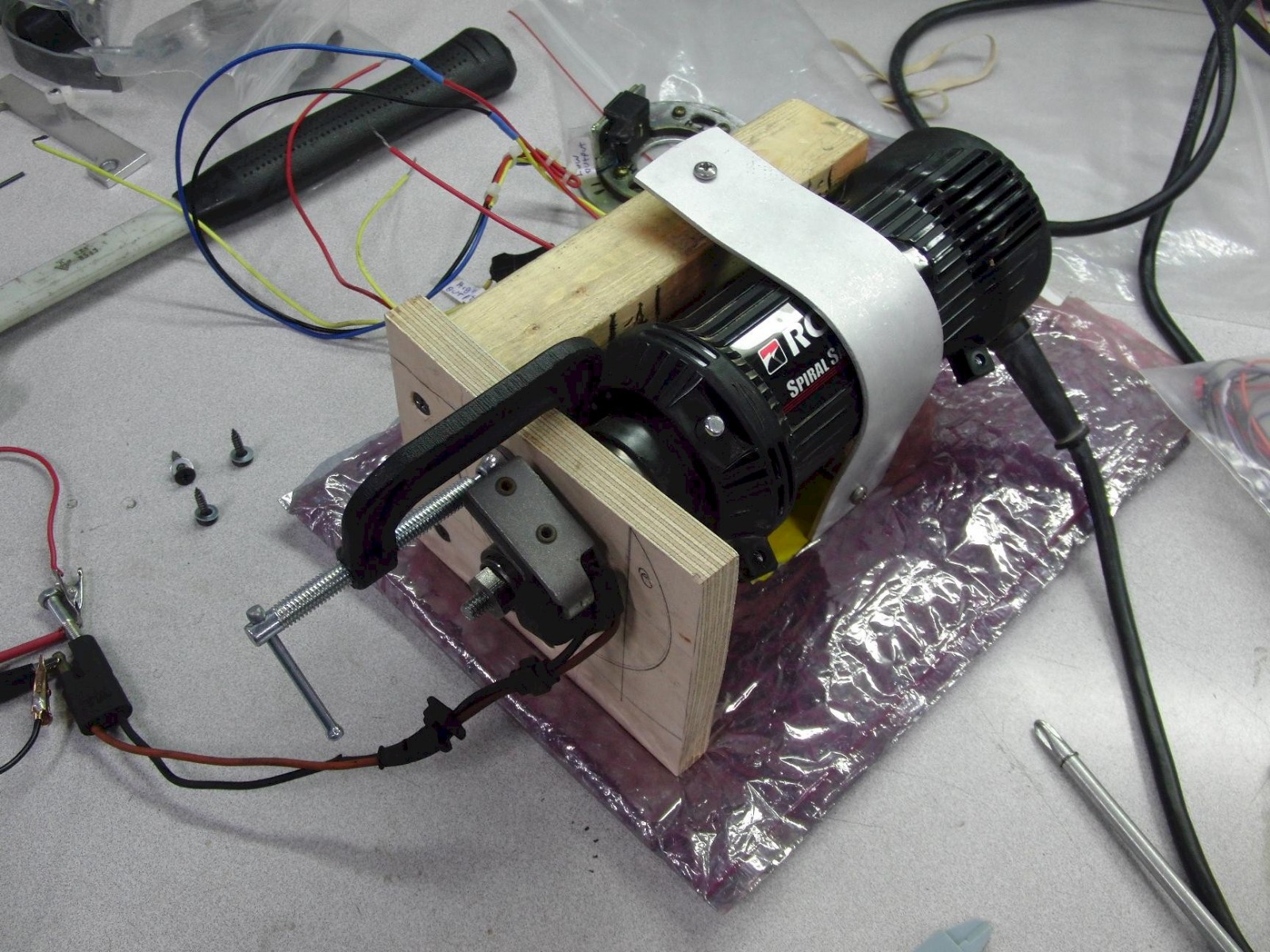

First I made a test rig using a Rotozip and a router speed controller from Harbor Freight. Note on the speed-controller: You have to open it up and there is a small hole in the circuit board that lets you access the internal speed calibration potentiometer. You have to adjust it so you can get all the way down to zero, otherwise the range will be very limited.

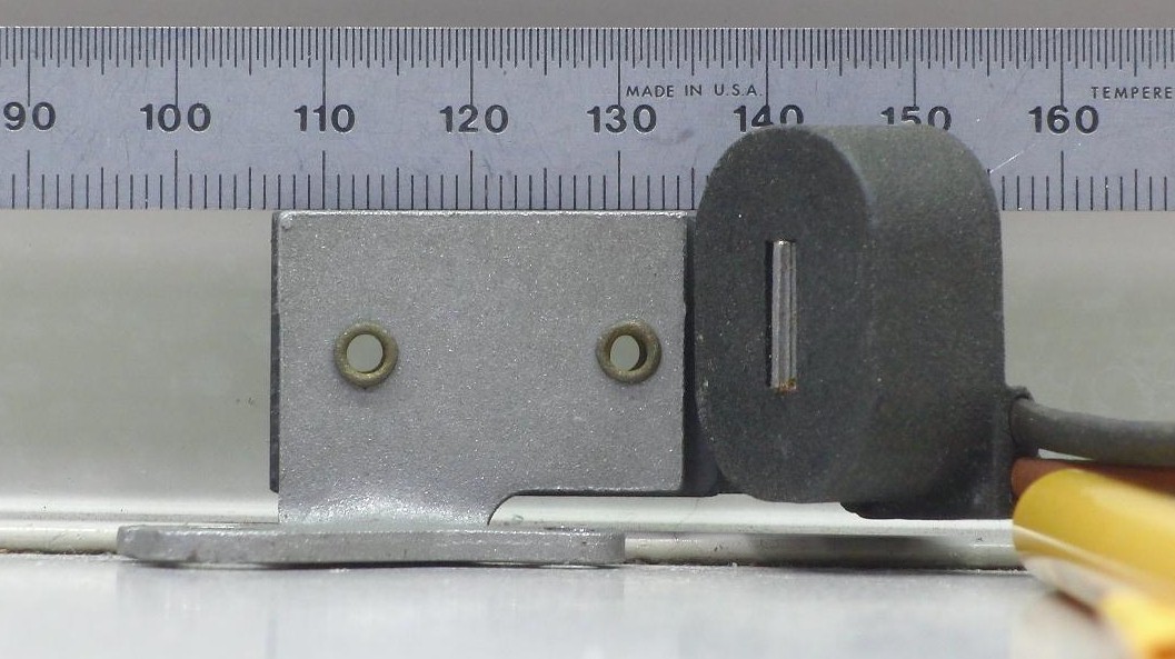

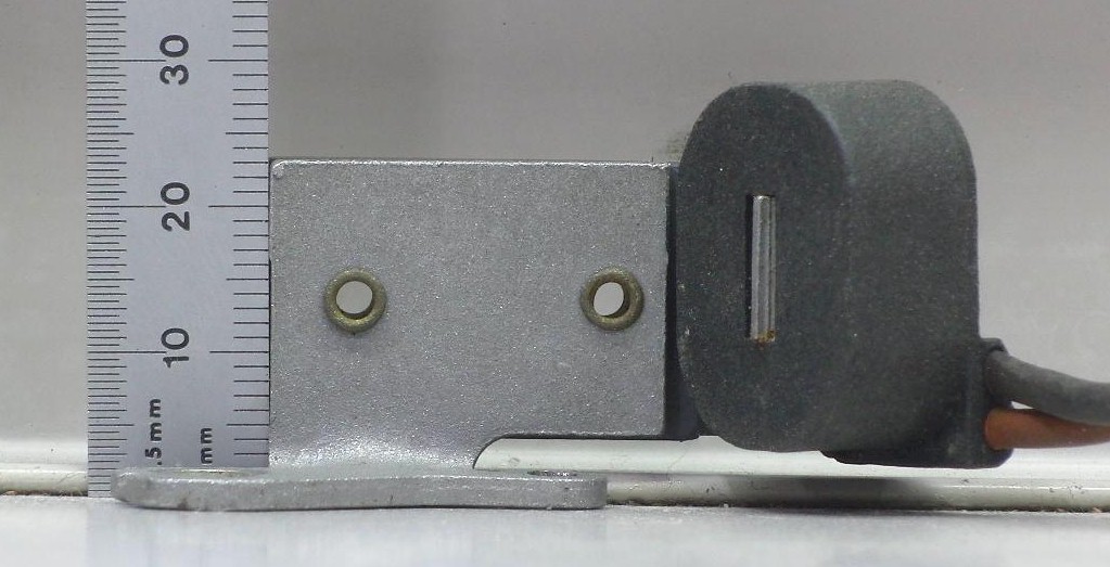

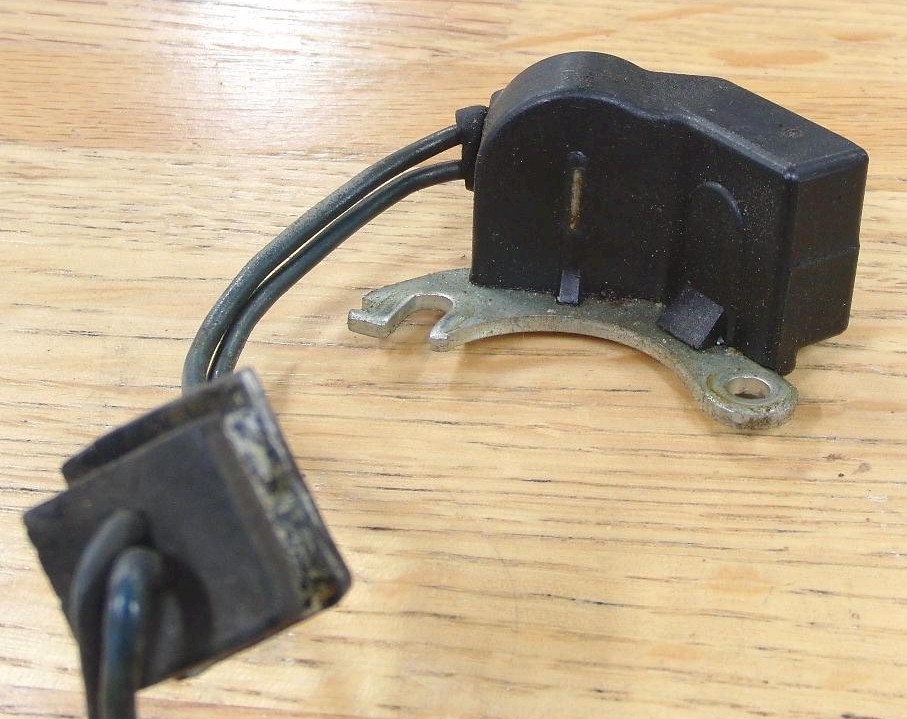

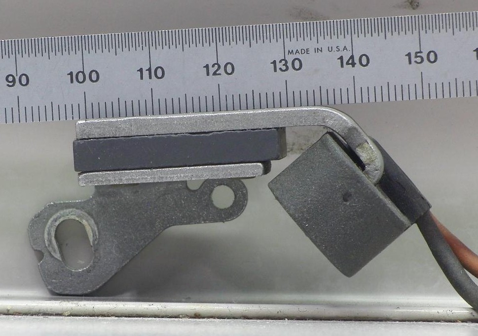

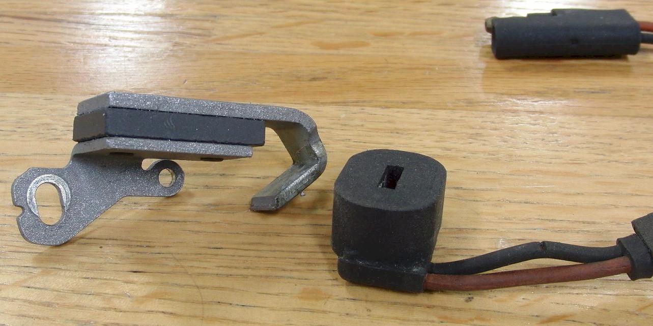

Here's the Mopar pickup.
The first one is new and one I bought at a parts store in the early 2000's I think. It's a Wells aftermarket unit.
The older one is one I used on my 71 Dodge Dart 318 which originally came with points. I got this at an aftermarket tune-up shop in the 1990's.
On the older one, the pickup coil can just slide off the frame. That's very convenient.

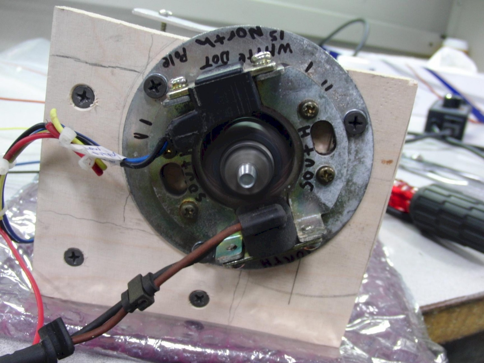

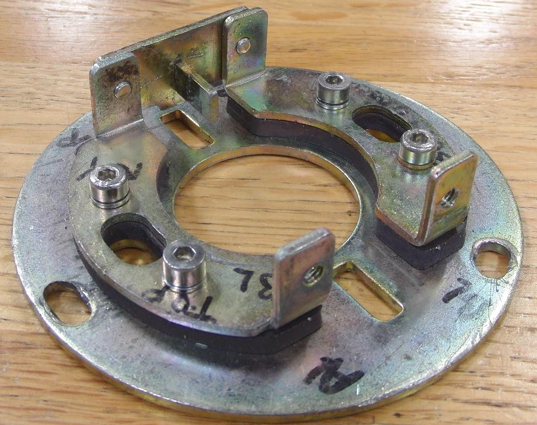

Here is a Kz inline-four pickup plate. One pickup is removed completely. On the far side you can see the metal skeleton from the other pickup. That skeleton is what transfers magnetism from the base plate to the rotor. The tip is the pole-piece you see on a complete pickup.
What I found was that you can simply place the Mopar pickup coil on the skeleton of the Kz pickup and it works just like a Kz pickup. But it has to be this older type of Mopar pickup in order to physically fit properly.
Note on polarity of the Mopar pickup:
The black wire is what I consider positive. It would go with the black wire or yellow wire on Kz pickups.
The red wire is what I consider negative. It would go with the blue wire or red wire on Kz pickups.
Then I mounted it on a the test rig with a good Kz pickup in the opposite position.

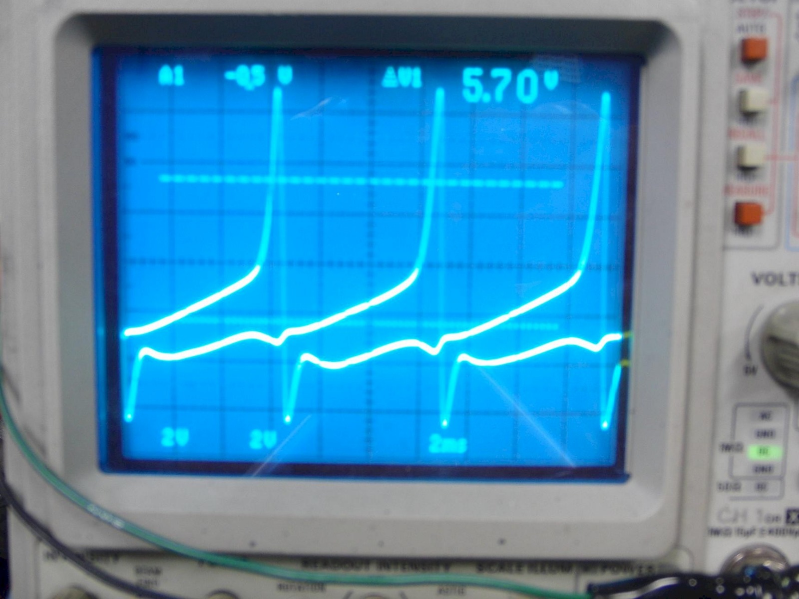

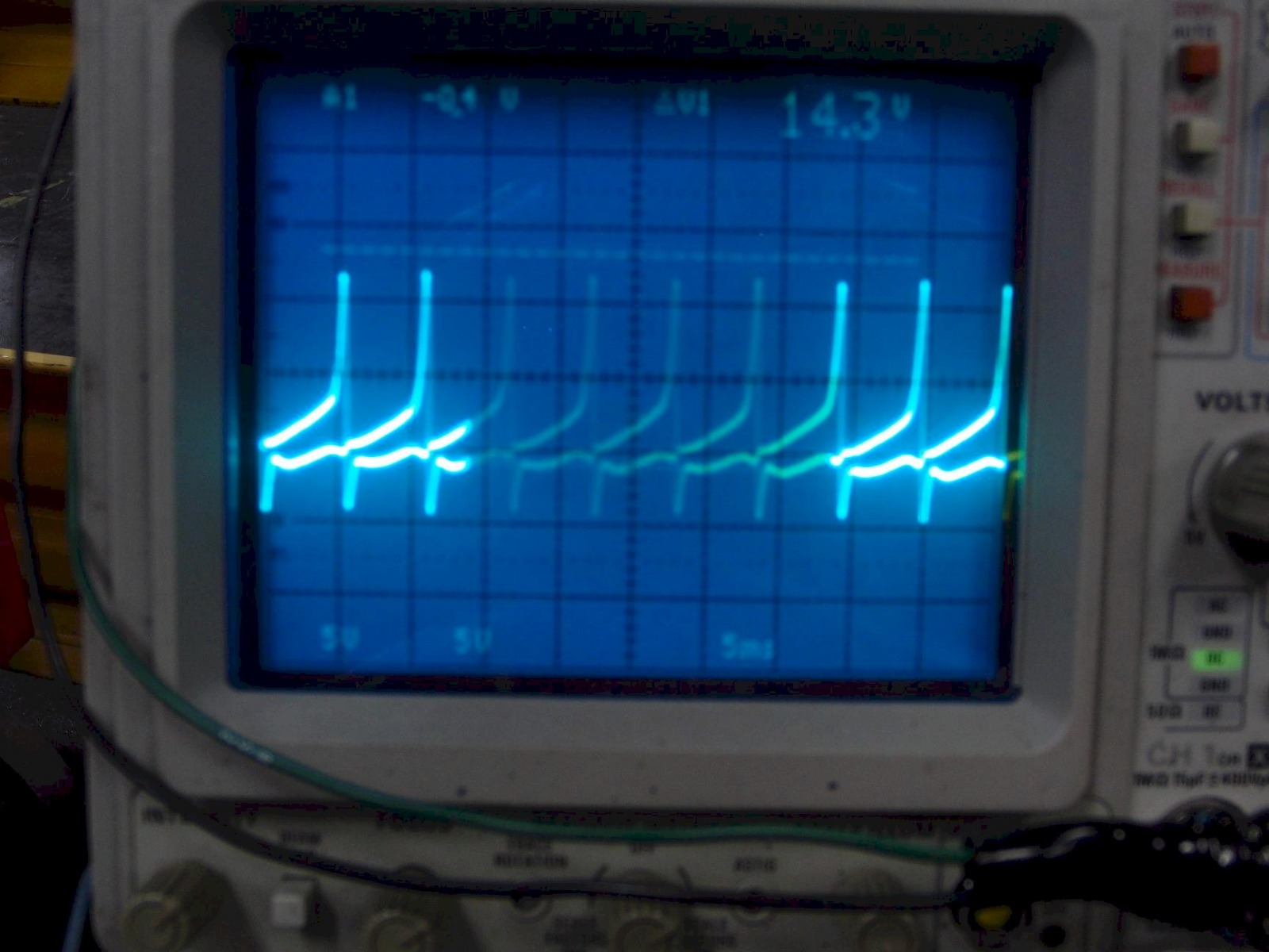

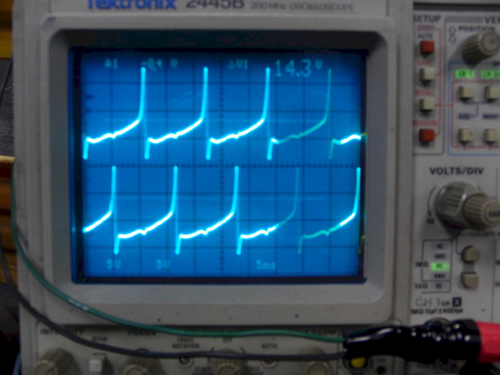

The results are very promising. The signals created are so similar that I can't tell them apart.
I was running low on time so I just made some fast screen shots.
Sorry the images are blurry. The scope screen must have screwed with the camera's focus circuit.
First, here are the two signals one above the other. (I can't remember which is which, but they look pretty much the same to me.)
Next here they are overlayed on each other.
Here's a closer view.

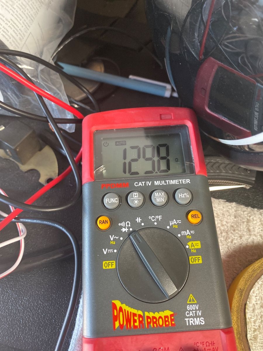

That mopar is exactly the one I came across on eBay over the weekend and have been waiting for a reply back from the seller on info so I could try and find some numbers. Nevermind that though. They have it listed for like $15 which isn’t bad at all considering. I think I’m just gonna hit the buy it now button then mount it up on the live test subject once I get it. Also, I finally have the Caltric one for the Polaris in my hand.
Here’s what it ohm’s to..
Later today, I’ll report back with the results from the other tasks you asked from earlier.
Personal question if you don’t mind me asking? Were/are you an electrical engineer. That’s a mighty useful super power you have acquired sir.

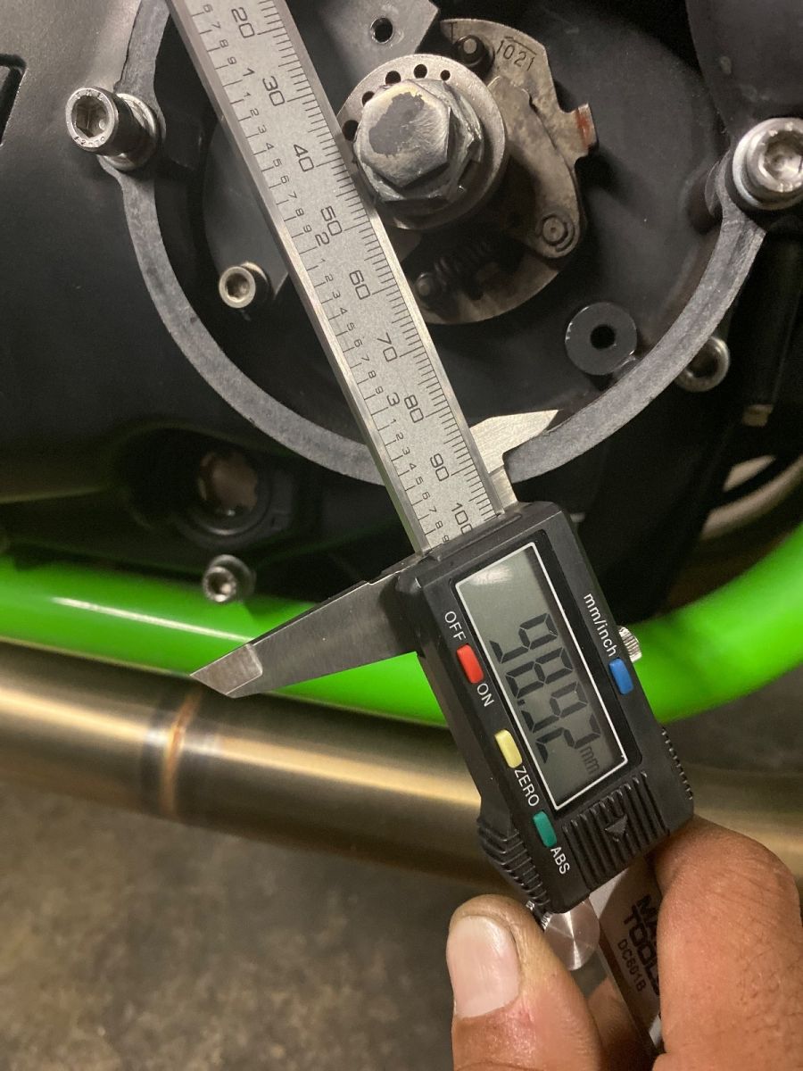

Sorry for the late results. Literally just did them. The 40ohm pu that’s mounted does make my spark plug tester light, but very faintly. Can be seen even with overhead lights on. Did the 130ohm and the bulb is significantly brighter? So just for shits and giggles, gonna see if I can ziptie it on and see what happens? Also, the pole on the 2nd pu has about the same more or less magnetic attraction to an 8mm wrench as the stock one. The first test pu has none as far as I can feel when setting my wrench on its pole.
Old Toyota supras, MR2’s and the like are abundance in my area as well as Nissan/Datsuns. Wish I could find a decent bodied 77 240? I miss mine now..oh the things I’d do to it:whistle:
And just in case. Here’s the ID of the rotor/pulser area.

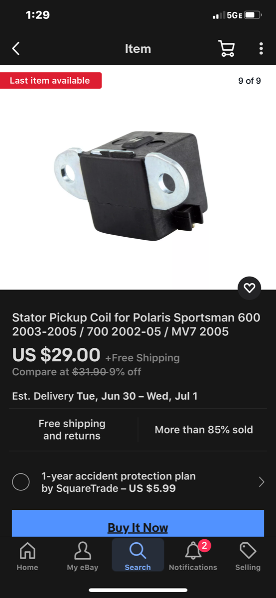

I found this from RMstator and then did a quick search on eBay for availability.
In the description, says this is a 500ohm coil? Price isn’t too bad either.
I pressed the buy it now button:whistle:

That looks good, but the real question is does it include a magnet inside.
