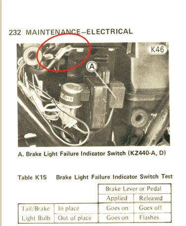

Re: Hit a bump - 83 440LTD Shutdown **Help**
09 Jun 2020 09:18
The frame ground should be under the side cover on the right side.
The biggest help would be getting the battery for your meter and testing for voltage drops while under load.
