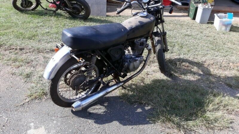

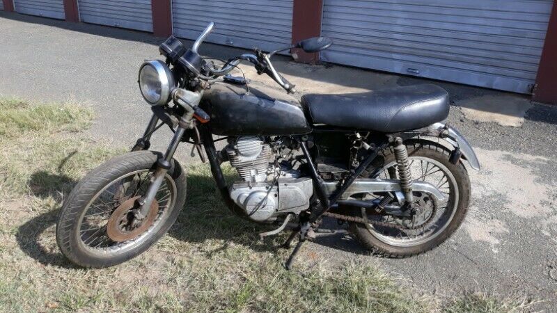

I got a bee in my bonnet and decided to buy an old bike, advertised as a Z200 1983, as a project, without knowing anything about the bikes' history. After finally getting it, looking it over properly and realising I need several parts, the search revealed a shortage of parts and a confusion of the many models. The frame and engine says KZ200A. Many listings are for KZ models, but it seems there are listings without the K. Are they very different? I also downloaded a service manual for '78 to 84 models, but the bike I bought is not similar to the manual with respect to ignition system and clutch linkage locations. My clutch linkage is on the top right next to the oil filler cap, the manuals indicate it should be on the bottom left engine cover. I am now confused. What do I have if it's not the same as the manual. There is no Vin number, it seems a pre-17 digit format. The big issue to get the bike going is the ignition system. It came without all of the stator/generator and related parts. I now dont know what I should get, electronic or points. The left engine cover did however have a pic-up inside which would indicate electronic ignition. I have now bought another donor bike, which seems to be a points system bike, one similar to the downloaded manual. What parts would I need to complete an electronic ignition system? Thank you.

In the 2nd pic your 200 has a newer style clutch cover. The 83 KZ650-CSR for example is similar.
The clutch release being on the RH side is also a newer style which is found on a some later KZ models.
Some of the 250 & 305 models had the clutch release on the RH side as well.

The sprocket cover looks like it came from a different model.

Thank you. I'm leaning towards the '82 or A2 but the info is not difinitive. The engine number is not on the list KZ200AE-074* and frame number KZ200A-045903. Seems I have a bit of a Frankenstein.

The frame number should make it a 1982 A5. The first 3 digits in the suffix of the engine number would fall in the 82 range as well. Is it possible the end of the engine number has been obscured by corrosion or something? And TexasKZ is right about the engine sprocket cover >> it kind of looks wrong & should match the lines of the generator cover. or maybe it just needs to be installed correctly. ???

Edit: Did some Googling and assuming you are not in the US, looks like you have the export Z200. Also, the finned looking cam cap is not on the early US model. I would search your Ebay site for 81+ Z200 complete harness/ignition or whatever you need.

The LH engine sprocket cover in your photo looks to be the correct style. see pics at cyclechaos.
