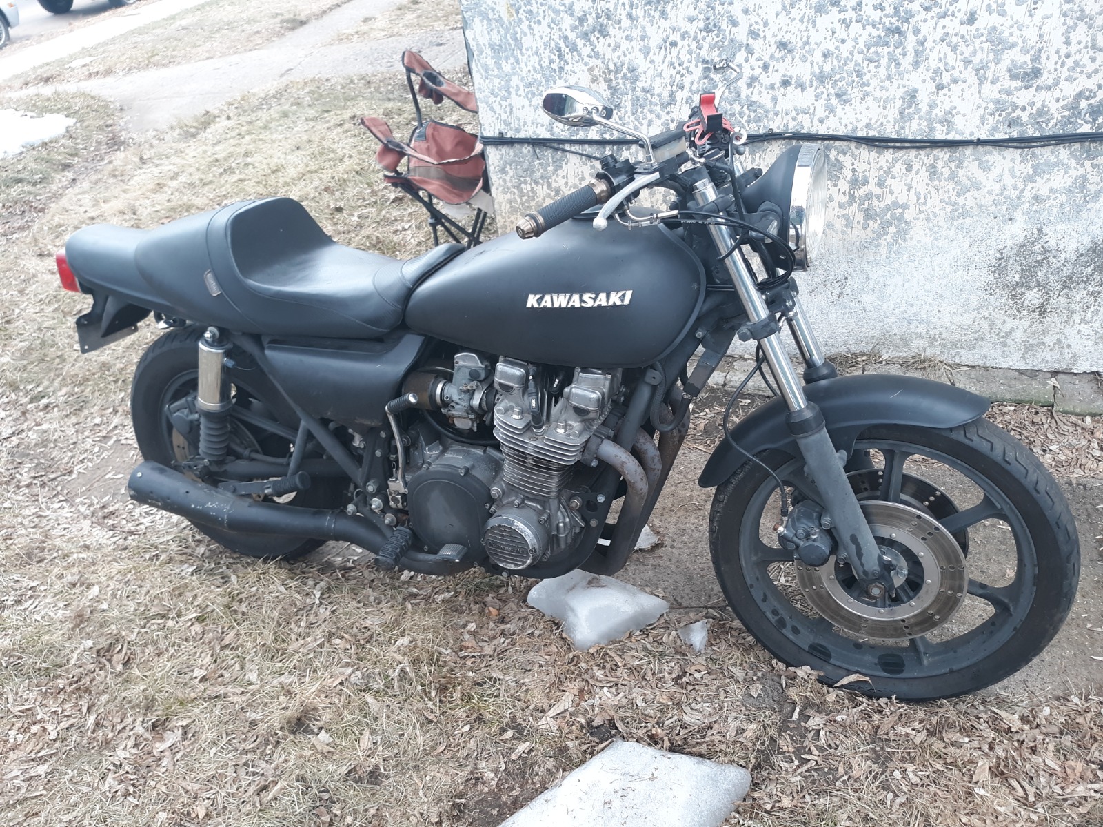

Ok, so I bought a modified bike from a coworker. It's a 1980 kz1000 b4 Ltd according to the zedder website, but has a 1978 kz1000 c1a police motor according to the same source.
From the clymer manual I bought the wiring harness seems to be from the 80.
I've never owned a Kawasaki before, but have an 82 seca 750 that I've worked on a bit, so I do have a bit of knowledge about motorcycles.
What I've run into is when I turn the key on there's no headlight or brake light (it doesn't have any gauges or indicator lights) the blinkers work, so I know the system is getting some sort of power with the key turned on.
Start button does nothing. Kill switch I've turned, and I've looked in the housing. Visually it's not too bad looking inside there but could use a cleaning, which I'll do at some point soon. I spent the afternoon going through it and making sure all the connections were connected and visually checking them for corrosion. They didn't look bad, but again I'll clean them soon as a regular new bike go through.
I put the battery from my seca that's been on a tender for the winter in it (bought it last year). Using a multimeter it reads 12.51 volts across the posts. I cleaned the positive and negative terminals on the bike with a wire brush really well as well as the negative motor ground terminal.
I checked continuity through all 3 fuses, and I'm going to upgrade the fuse box to ATC push in type soon.
I checked for power at the white wires behind the headlight at the 6 pin connector to the ignition switch. Read the same voltage as battery.
I tried to kick it over, but have never had a kick start bike. It turned over, but didn't fire that I could tell. I tried starting it with the clutch held in and not with both the kicker and the start button. Nothing different between the two.
I tried to cross the solenoid with a screwdriver and got sparks but nothing but the light show.
I disconnected the 4 pin headed to the ignitor and checked the pick up coils. Got 4.50 on both so they should be good. They read good at least.
That's the sum up of what I've done today, but I think this bike's got more than a couple things wrong with it and I'm not sure how to figure out much else, so any help would be appreciated.
First thing I'm trying to figure out is why it doesn't even want to try to start. Once I get it to that point I can move on, but I dunno what to try now.

Lol, I'm guessing whoever modded it liked the look and wasn't too concerned about lawfulness.
I can produce pictures on demand, as long as I know what y'all want closer photos of, but I'll include a full bike photo in this post.
So, I pulled the starter and applied 12 volts DC across the post. Purred like a kitten, so starter doesn't seem to be my problem.
Pulled the starter solenoid. Applied 12 volts dc to the wires (2 wire solenoid) and it clicked. Read 021 ohms with my multimeter set to 200 ohms across the posts with it energized. Read 039 ohms with it set to 200 ohms across the 2 wires without it energized.
Never checked a solenoid before, but YouTube helped. So it doesn't seem my solenoid is the problem either.
So next is to try testing the igniter and the ignition coils as soon as there's a break in this nasty rain/ snow/ sleet stuff they're calling for most of this week.
