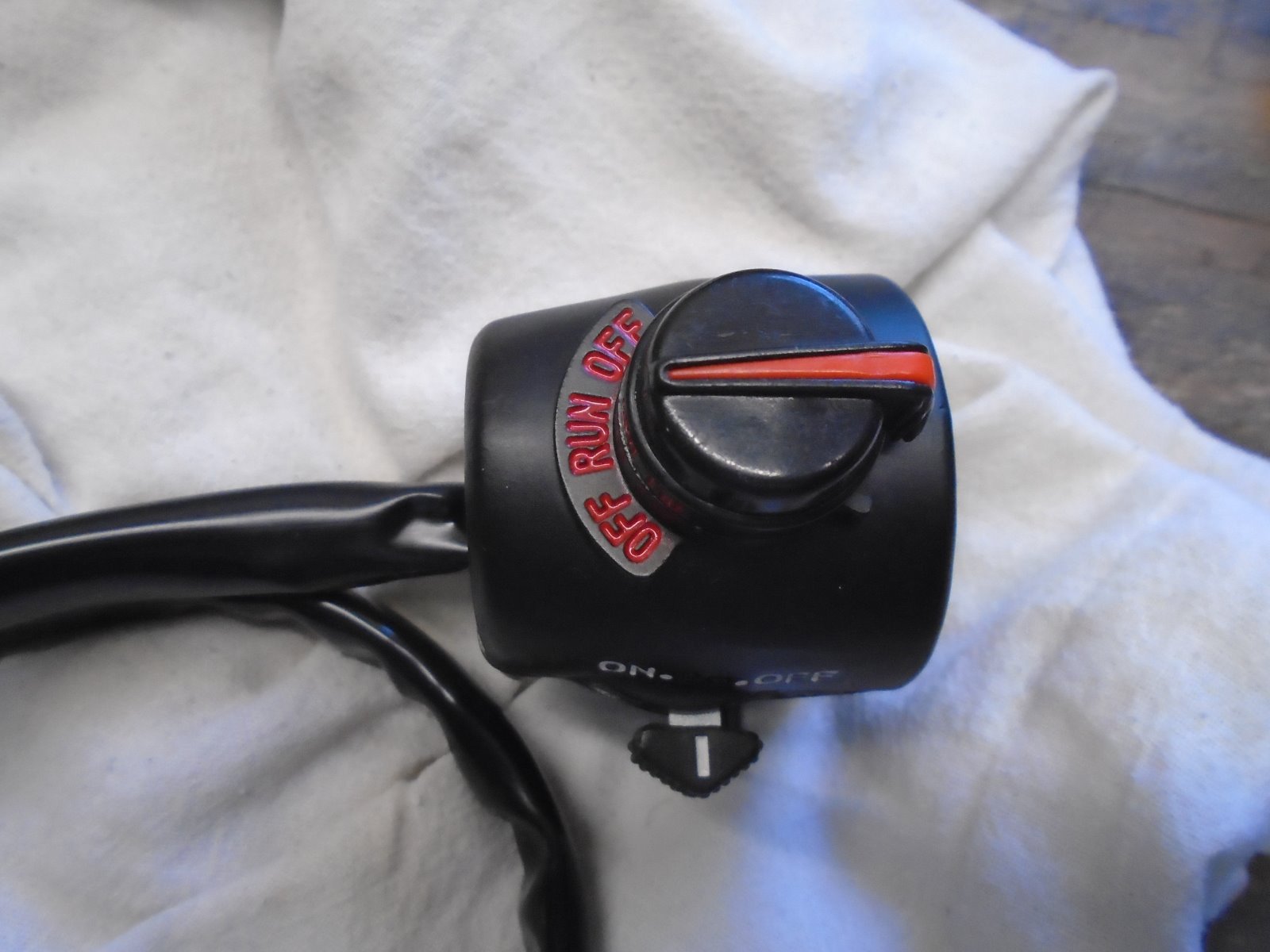

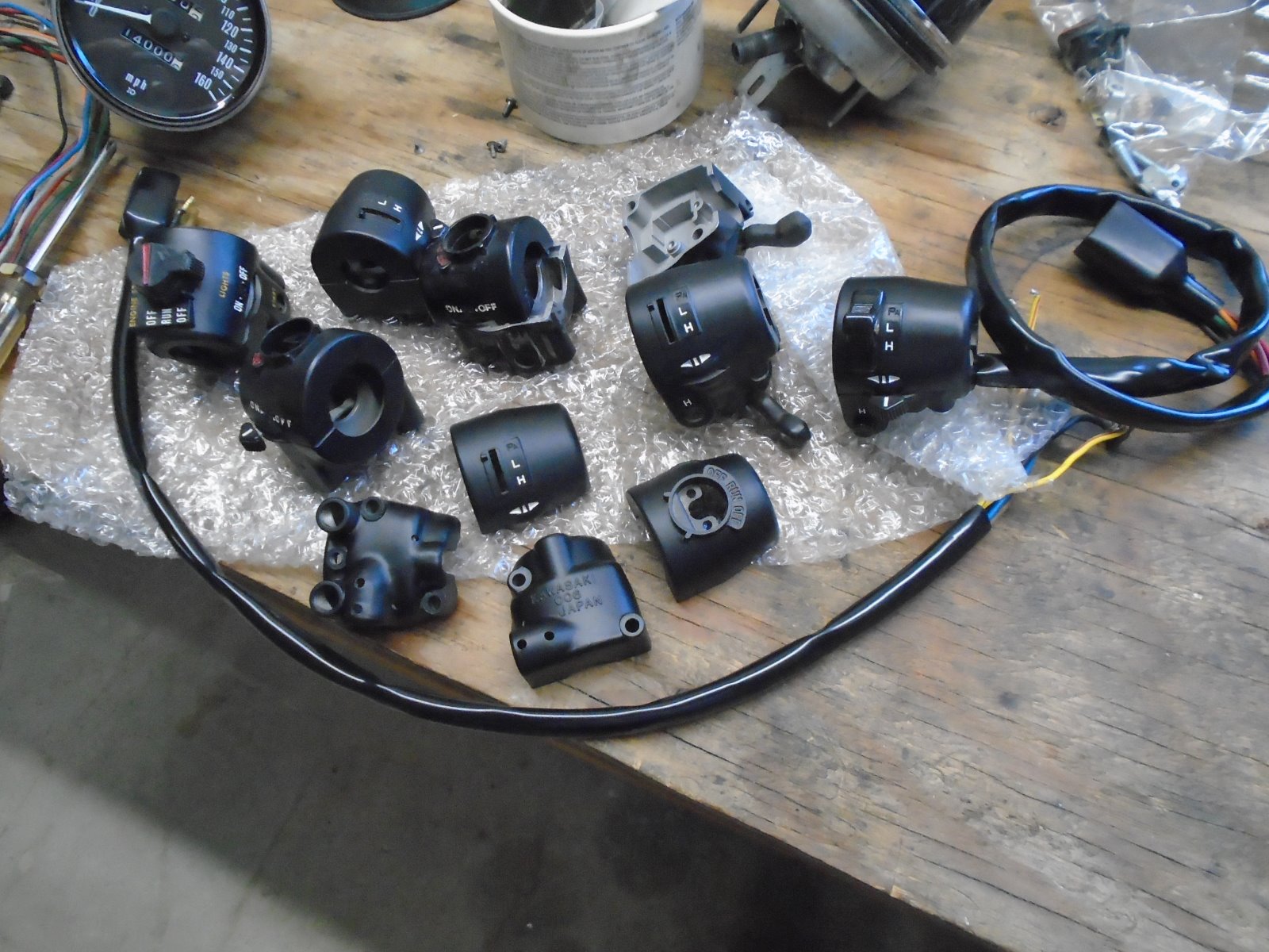

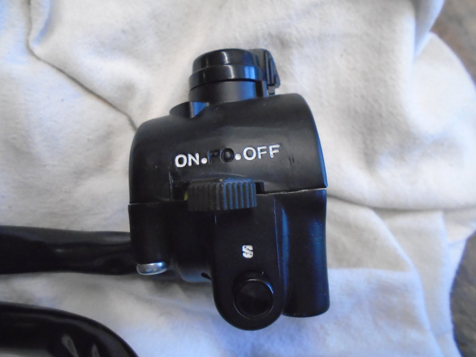

Easy to do Hardrock, finishing-up one this morning. What year are you doing? I have an easy to do it! You don't have to try to fill each font in, just swipe.
  • asphalt900
  • asphalt900's Avatar
  • Posts: 1913
  • Thanks: 1291
Re: Handlebar Controls
11 Feb 2020 04:42
#819009
Here are the tools I use. using the cosmetic sponges you just swipe across the surface. First pass don't worry about leaving a haze of paint. When paint is dry, moisten a sponge with mineral spirits, blot excess on clean rag, swipe off haze. Note the shallow recesses on choke levers, this technique allows a nice crisp job.

I'm NOT a painter but I use Low Gloss Black DE1634 Duplicolor Engine enamel with Ceramic. I blast off existing paint/corrosion, SEM self etching primer...wait.. then Dupli-Color it. They were Not glossy when NOS. The knobs (levers are still plentiful as well as Horn/Start buttons/springs (the same). Internal stuff I have Zinc re-plated as required. Wiring sheath I get in bulk from Vintage Connections as well as connector blocks and terminals. Also if your locator tab is missing, a lot I see are, I tap in a M5 grub screw.

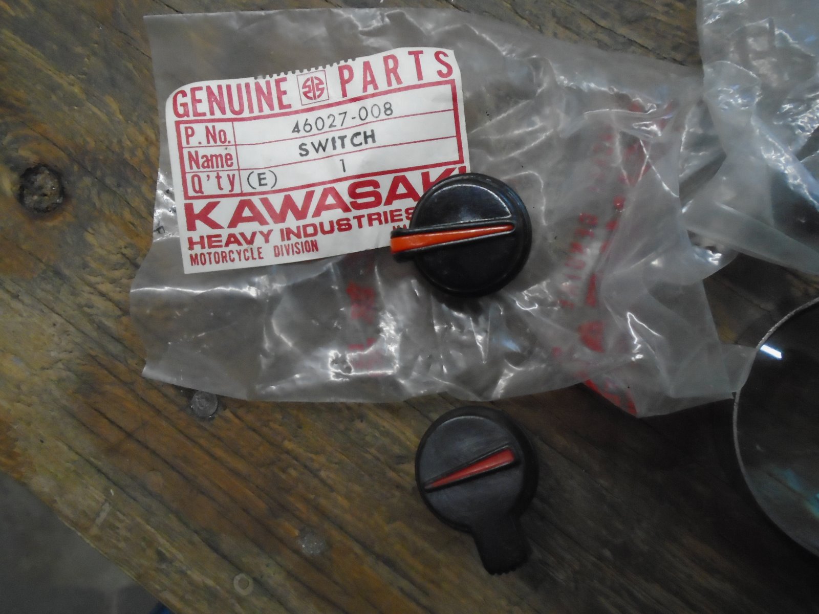

9-er, which style of switchblock on/off/on do you have? Two styles shown. The knob was never offered separately for the Z1/KZ900-1000 but I have found a way around the earlier 72-75 versions. Only the top can be used, just remove the e-clip and transfer to your existing lower plate.
