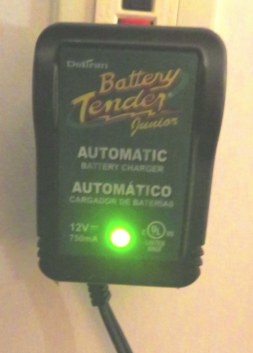

Yes, old "dumb" float chargers stay in float mode forever. That is fine for short periods like hours or days, but eventually they will dry out a battery. They have to compromise between being able to re-charge a battery in a reasonable amount of time, and providing a slow enough charge that they don't immediately cook a battery. That's why smaller batteries need smaller float chargers. The other option is to remember to disconnect it sooner if the battery is smaller. But people forget and eventually they will leave a battery on a "dumb" float charger for months.
The battery tender junior, as I understand it, is a "smart" charger. It may enter a quasi-float charge mode, but will eventually have to shut that down or drop the output significantly if it is to be left connected for extended periods like weeks or months. The fact that I measure 12.9v on the battery tells me it's not charging. Even small amounts of current will get a good battery over 13v.
What they are calling float mode is probably some mode where the battery is topped off periodically, then allowed to rest. So for most of their "float" time, it's actually doing nothing. It's more of a semantic argument, over the definition of "float".
I did some quick tests on an fully charged, good battery.
When the LED is red, the BTJ is outputting roughly about 400mA steadily, initially. It may have been higher since this value drops steadily while the LED is red. The voltage on the battery was somewhere near 14.4v and climbing. It takes a while for a battery voltage to climb so even though the current was dropping, the voltage was climbing. The LED was only red for about 5 minutes or less.
Then the LED was flashing green. The current was at 150mA and the battery voltage was about 14.5v. During the flashing green, the current would drop to 0mA every four seconds or so, for about half a second. This lasted for about 5 to 10 minutes. The voltage stayed pretty solid at 14.5v and the current stayed at near 150mA with 0mA pulses.
Then the LED was solid green. The current dropped to -0.1mA. and the battery voltage quickly dropped to about 13.5v.
After another 5 or 10 minutes, the voltage was down to 13.25v and the current was still -0.1mA. So clearly, in solid-green mode, there is no charging. If anything, there is a slight discharging. I predict it may take a day or two for the ambient voltage to drop back down to 12.9v. I predict when it drops below a certain threshold, it will go back into flashing green mode. I've never seen it happen, so it must be brief and infrequent. I walk past the charger everyday on my way in and out of the house.
For these tests, I had to use 2 meters because any dis-connection would cause the charge cycle to start over. Also, meters measure current by measuring a voltage drop on a known resistance. This means the battery tender's output voltage is not exactly the same as the battery voltage. There is a drop associated with the current-measuring meter which is in series with the BTJ and the battery. Occasionally I would short the meter leads to the battery so that the BTJ output was at the same voltage as the battery. The voltage on the battery always stayed the same. This means the BTJ is not actually asserting a voltage onto the battery. It is acting as a current-source and the voltages end up where they end up.
These are just very rough tests to get an idea of whats happening.
BTW, it may be late to mention this, but it not uncommon for different meters to disagree by .1v or more when measuring roughly 13v. I don't think I have never come across two meters that measured the same battery to within .05v even same make and model. This is frustrating when trying to design regulators... if you can't trust your measurements.
