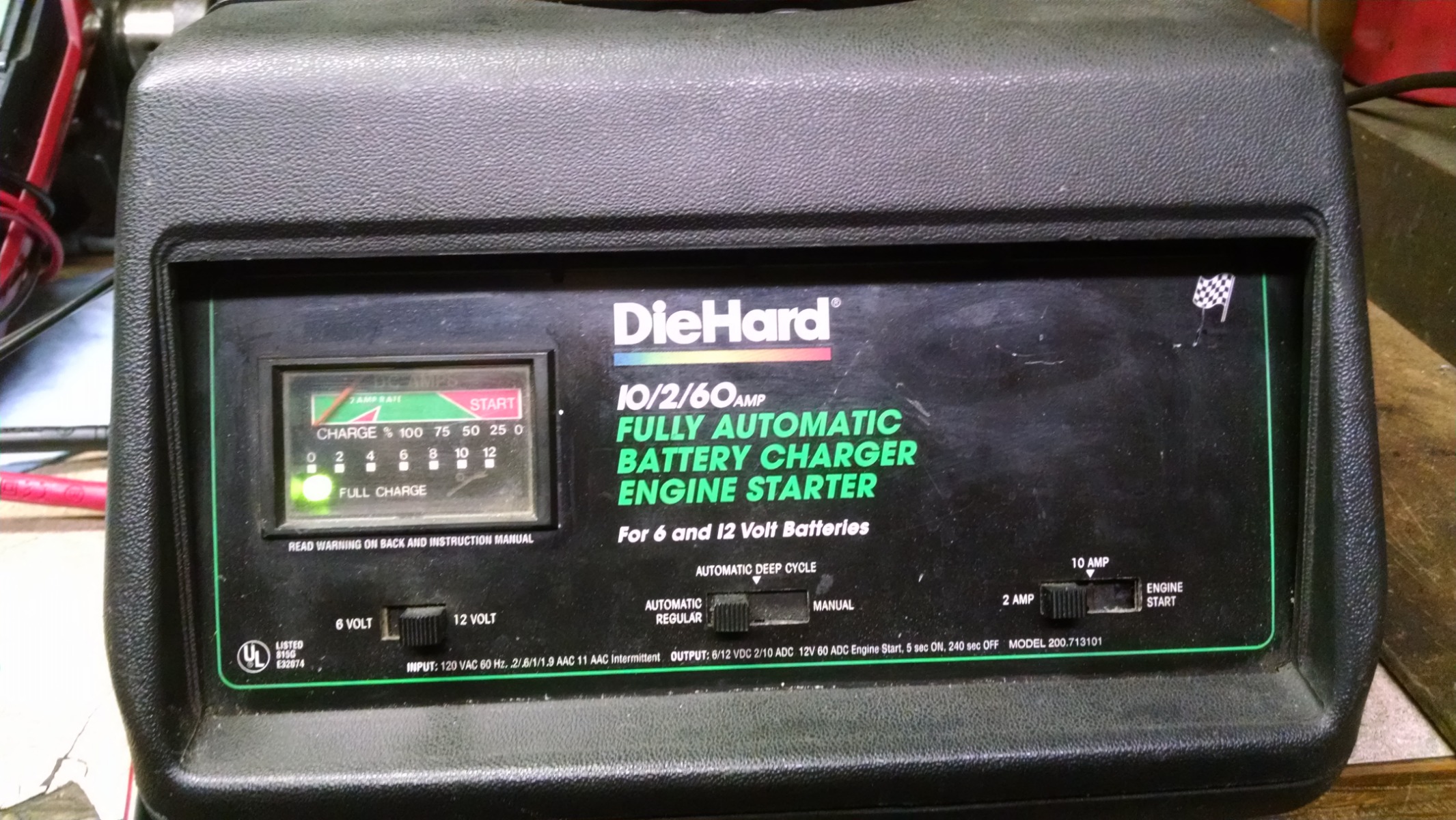

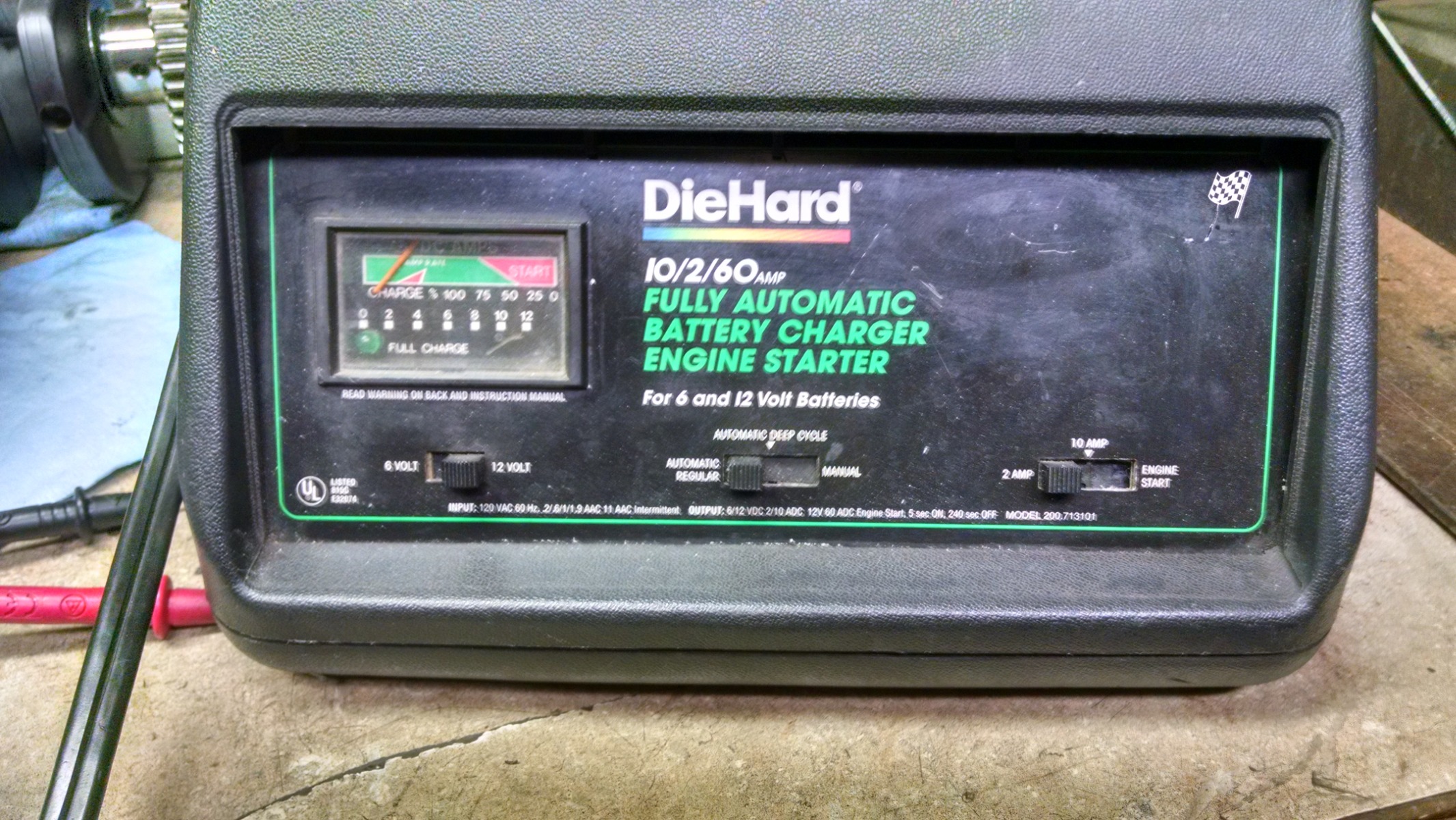

This is my fully automatic Diehard charger (Craftsman?) . Been using it for many moons. It seems to work much like the BTJ, except it is too big to mount under a side cover. I had put it on my bike a few days ago when I started the bike after it had sat idle for a month or better. (battery was not low BTW) When It feels like it has flogged the battery enough, the current drops to zero and the green "full charge" LED activates.
I observed it going from charge to the green LED coming on (was putting my snow blower in the shed) , then I checked the voltage with the charger still hooked up. I measured 12.93 volts, and the battery was cool to the touch. (cool is a good thing) I then removed it. There is no need to leave a good battery in a constant state of charge. I have found that batteries in a constant state of charge (getting cooked) will soon NEED to be in a constant state of charge. IMHO
