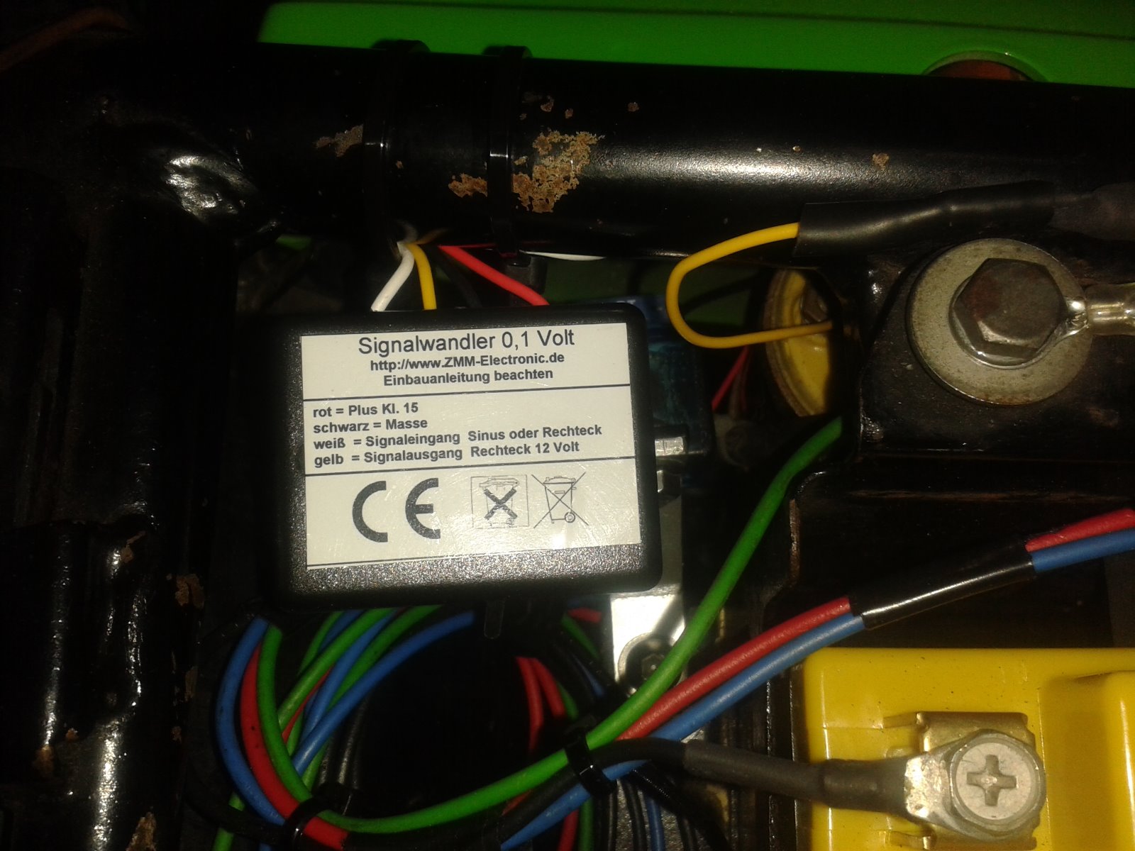

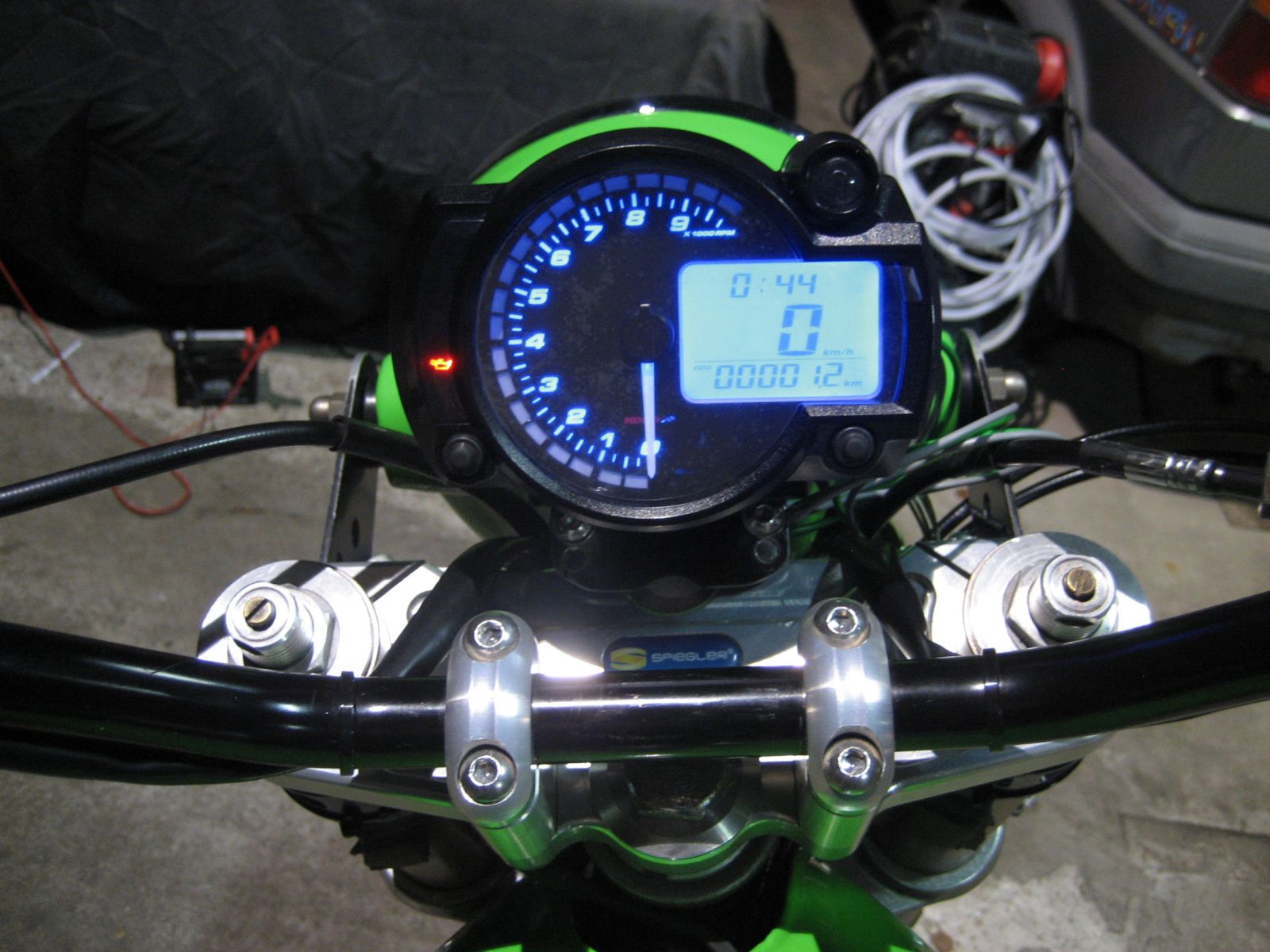

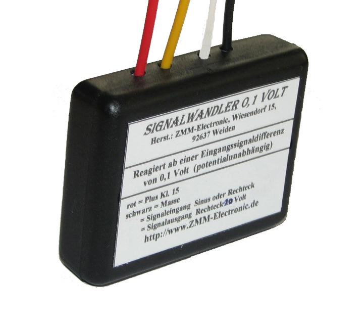

Got the same Problem as you with a Dyna ignition and my KOSO Tachometer.
Here you will find the cure for:
kzrider.com/forum/4-electrical/607690-de...c-tachometer?start=0
kzrider.com/forum/4-electrical/610870-82...age-nightmare#805856

Thank you, Scirocco!! How much does one of them cost?
