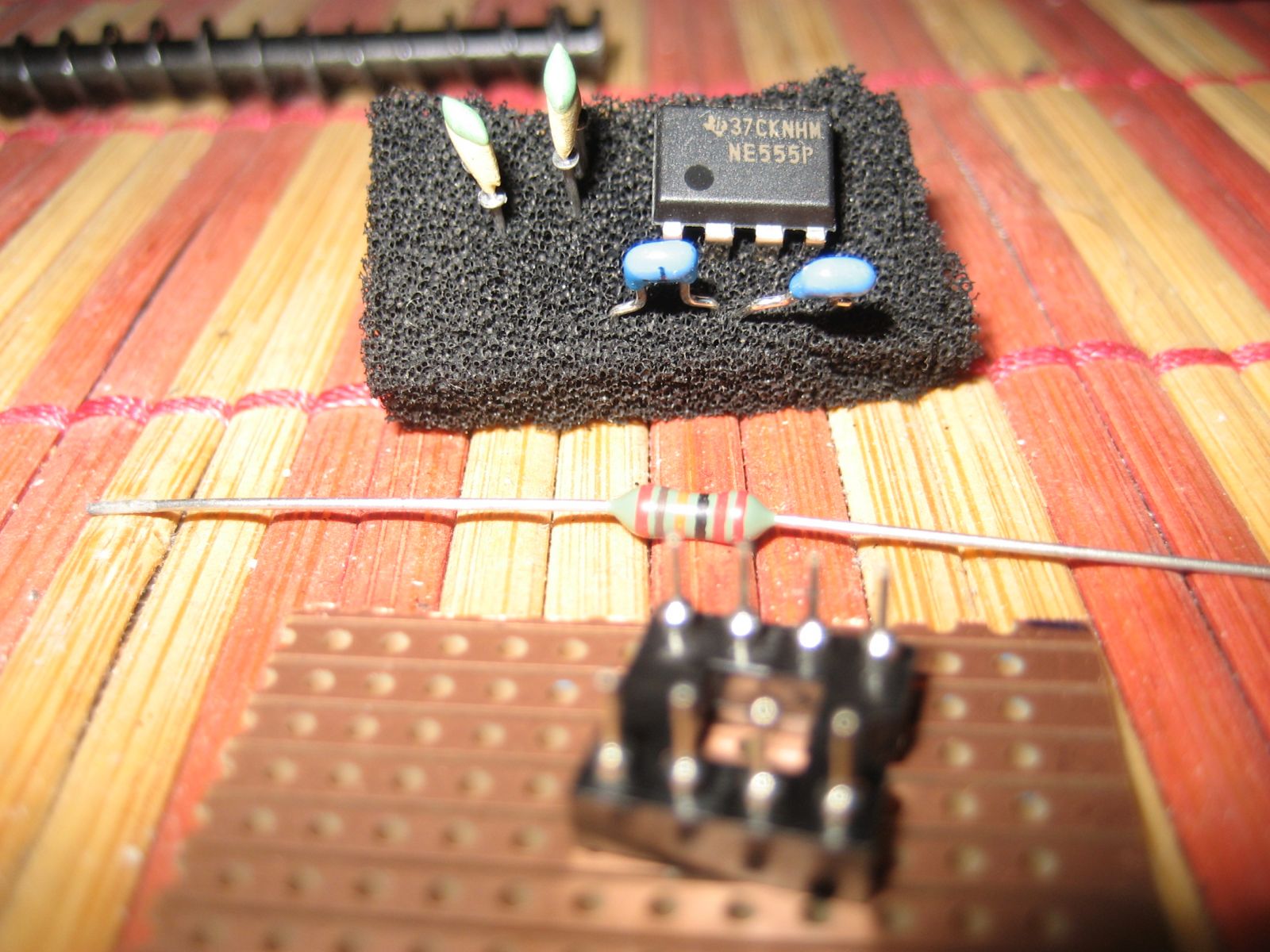

I built a small 555 timer circuit to create a squarewave signal so I could test the unit.
I can adjust the frequency and the proportion of 12v versus 0v signal (the pulse width).
The 12v coil input signal from an aftermarket electronic ignition will cause the needle to oscillate like a vacumn gauge at over 6K rpm.

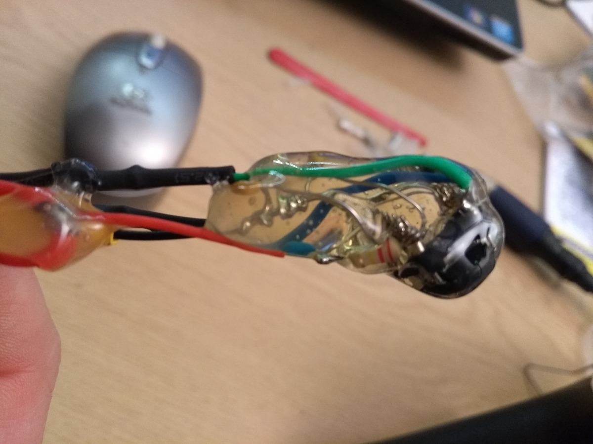

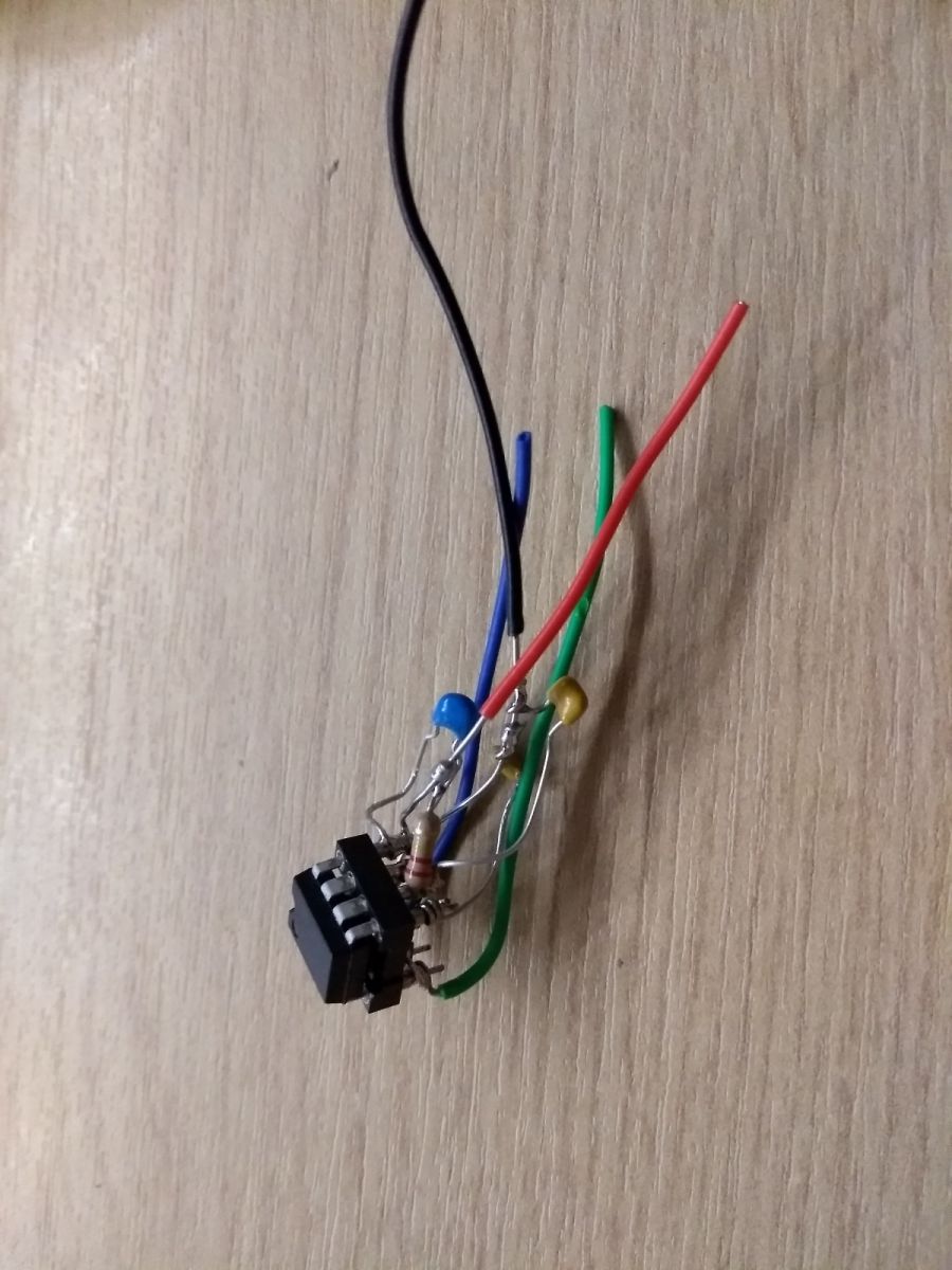

I found that a 2.5 millisecond pulse gave a steady reading throughout all the RPM (or frequency range).
If the 12 volt pulse was longer, or shorter than roughly 2.5mS, the unit would either behave erratically at higher RPM, or would not cover the full RPM range.
The solution is to build a circuit that receives a pulse of whatever width, and outputs a neat 2.5mS pulse.
The bog-standard circuit is a 555-based monostable using a 220K ohm resistor and a 0.01uF capacitor.
The other decoupling capacitors are 0.1uF.

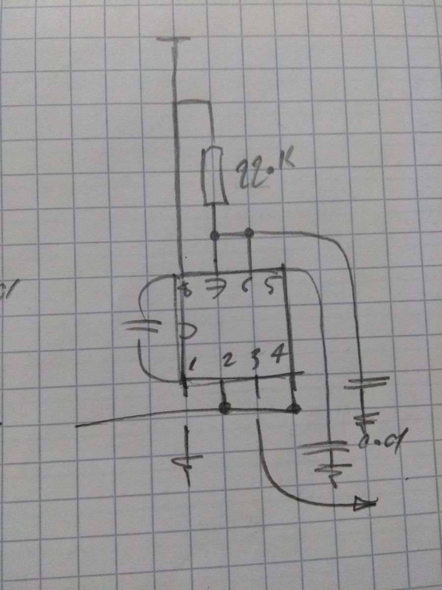

Hello weeZee
Can you make a more detailed wiring diagram, i want to made a De-twitching board for my KOSO RX2N+ GP Style too.
Which wire comes and goes to +/-/signal in/out ???
Want to get a steady reading throughout all the RPM, (shaking needle @ 4000 rpm)
Many thanks in advance
Michael

Sorry about delay and rough diagram, I've annotated it some more here. The downward facing arrow symbols represent bike negative, so all joined together. Purists will complain that the 555 schematic symbol is based on the pin-out rather than the schematic 555 representation. It's a monostable 555 implementation, so you still need a clean signal for it to work, if there are ghost signals or alternator noise spikes as mentioned earlier, it will cause false triggering. I'm pretty sure the Dyna signal width is adequate to trigger the 555. Other folks with noisy signals can benefit from a simple low-pass filter mod.
